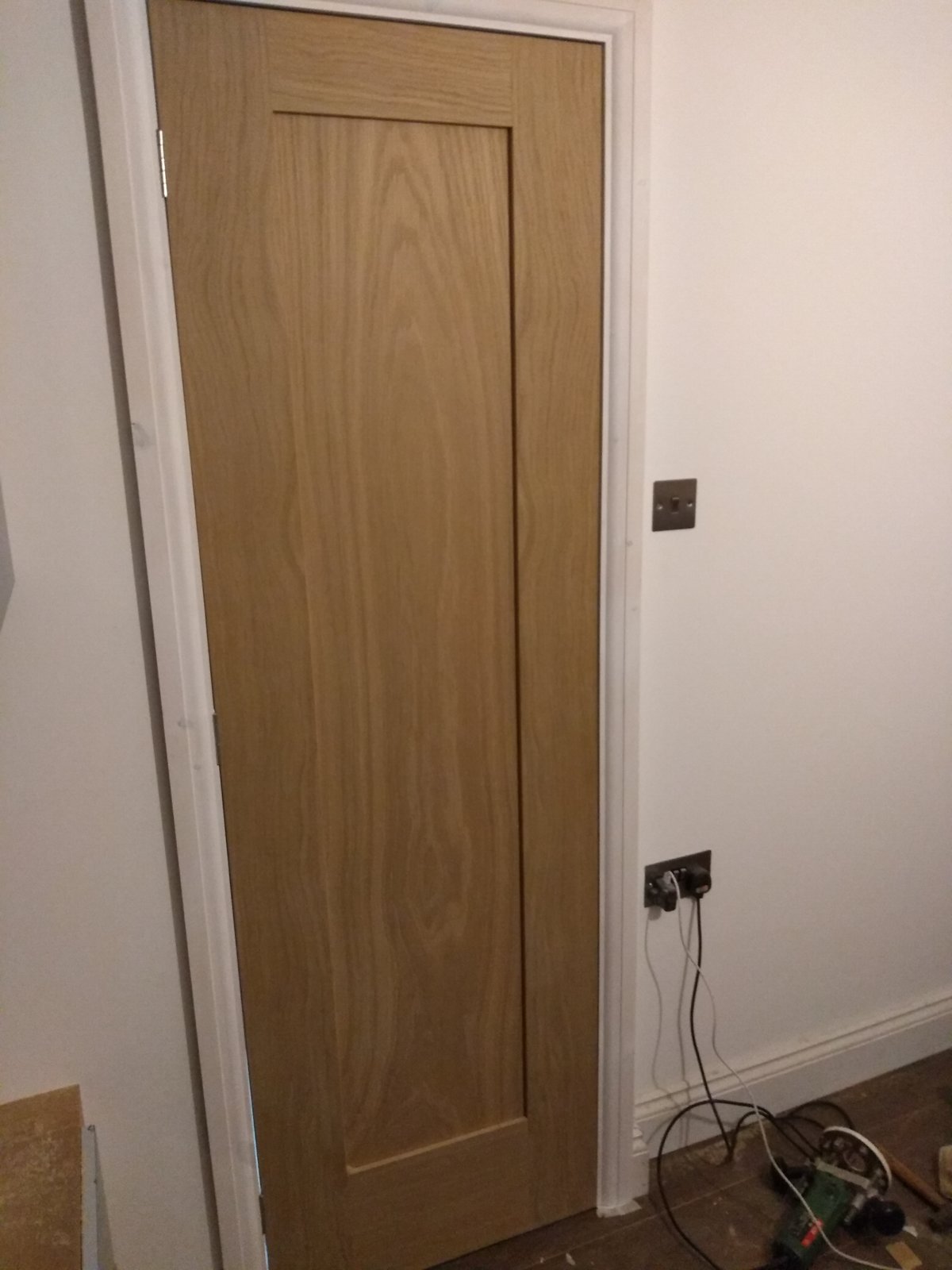

Hi, just hung this oak veneered door and it is a bit twisted - about 10mm from top to bottom. Would it straighten up a bit if I clamped it pulled the other way for a while? It's untreated at the moment if that makes a difference.
Thanks.
Door or liner?
It wont straighten out if the door, yes you could cramp it twisted t'other way but itll eork its way back.
You can alter it a tad on the hinges which will improve it a bit.
Thanks, it's definitely the door (probably explains why it was £20in the clearance aisle at Wickes!). If it won't straighten I'll live with it - I haven't fitted the stops yet so might position them so the latch pulls it in a bit.
