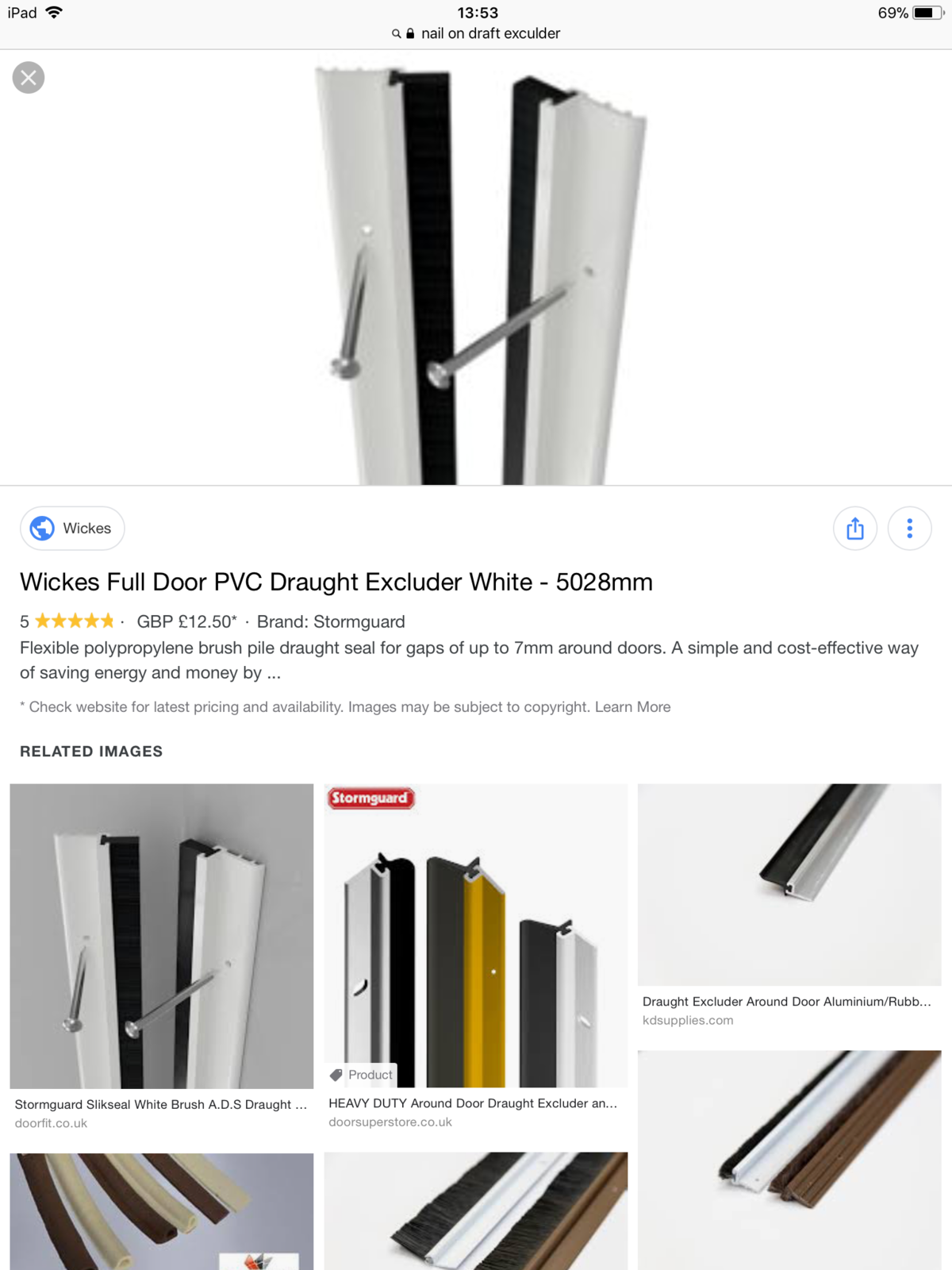

search for nail on excluder or fit a bolt to pull it in when your home?
