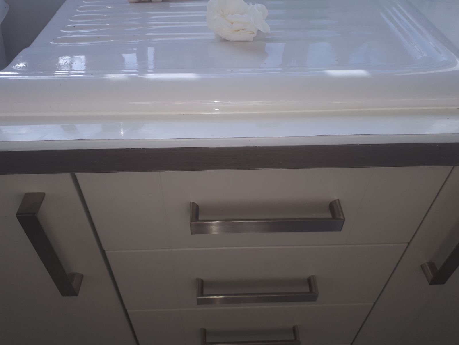

Please could someone advise.
After only 4 months the new kitchen worktop from Howdens has split on the edge and now water is getting in and warping it as it is near the sink.
Howdens will possibly provide a new top, but the kitchen fitter will have to be paid to fit the new top.
Should I try and get compensation for this work from Howdens?
Thanks for any replies.

I'm trying to work out how to post a picture. Sorry for the delay.
If it can be determined that it's actually faulty, then Howdens should also pay for the re-installation of it. If they are providing it as a gesture of goodwill, then you'd need to pay for the work. Have you left water sitting there that's split the corner - water getting in there now, suggest you might be leaving it there longer than you should.

Thank you for that advice. The only way I can think of water getting in to the cracks is by using a wet dishcloth. Otherwise, water couldn't sit there on the edge.. Surely it should be watertight anyway especially when it's relatively new.

As it's just by the sink, then it's reasonable to assume that the area gets wet when the sinks in use, so it could be sitting there for a time, but you're right in that it shouldn't have gone this quickly. It'll come down to how hard you stand your ground with Howdens, but they might find someone to do the job cheaper than you could, so throw the problem in their court, and face them down.
The real question, is how soon will the other worktops go, so put a clause in the agreement that you reserve the right to claim on the other worktops if they showthemselves to be faulty at a later date.

I would never use a worktop with a straight edge to the front as that glue line is always a weak spot. delaminating within 4 mths its not fit for purpose no matter what anyone tells you. Dont replace replace like with like go for postformed rolled over edge where there are no joins and it will last for ever. Use a good make like Duropal NOT retail shed cheap tops nor probably Howdens!

that dont look like work top material, couldbe the photo but it looks to be 18mm laminated chipboard.
has the worktop ben fully cut out for the sink bowl and drainer or is the drainer sitting on the laminate?
worktops should be min of 38mm or 40mm and as said should have a bullnose or rolled front edge. all cutouts,that means all, raw edges to be seled.

I'm not sure if the drainer is sitting on the laminate or not bobasd.

PS bobasd, Which is best? To have the drainer part cut out or not?
look up from the unit below to see any cutout.sometimes the drainer is let in by routing out a shallow depth not completely cutting out.
best is to have a solid top with min cutouts but its not always posible
