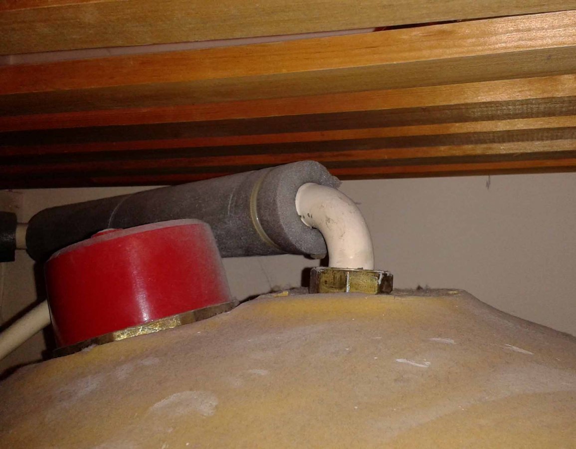

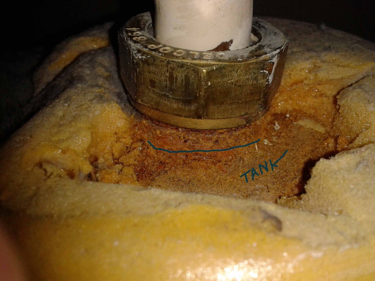

I'm looking to fit a flange to add a booster pump to all the hot water, so don't want to cut an Essex flange in the side of the cylinder.
The top of the cylinder in question is a 22mm compression nut. I thought most H/W cylinders were female - reinforced by the fact Screwfix stock two variants of male flange. In this case though, the compression nut is so close to the tank, it suggests the tank connection is male. i.e. I see nothing under the compression nut to suggest this is a compression union which screws into the tank if that makes sense.
The nut is about 1 1/2 inch AF, so larger than a 3/4 BSP bath tap connector nut, and it is possible to get a 1 inch female Warix but they don't seem as common, so I'm thinking that's what I probably need.
Can anyone confirm? It would be 15-20 years old I guess.
Thanks!

Have a look at York flange for your cylinder.
Thanks - I hadn't come across one of those. Just so my understanding is correct - on a Warix/Warwick, the pump connection is out of the top, and the vented to the side, where the latter can be adjusted around to suit the existing pipework. i.e. that makes it particularly suited to retaining the existing pipework exactly as is, and just adding a shower pump say.
On a Surrey (and York?), the vented connection is top, and pump to the side, which arguably makes it better for my situation where the hot is ALL going to be pumped - but I assume that like the Surrey, a York can't be adjusted - i.e. you're stuck with whatever position it ends up.
So a female Warix would still do the same job - and the decision is simply one of which is the easiest given the changes to my pipework?
