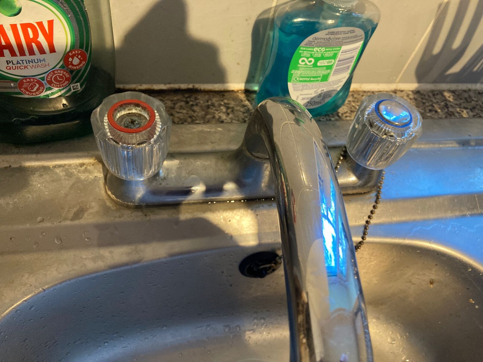

My son has just called his hot water tap wont turn off
so I talked him through isolating the tap - hes about 2hrs away - so
will be going up in morning - see what i can do / replace
any idea what the washer / barrel may be - I assume i may just need to remove and replace - hopefully not more complicated then that
any suggestions welcome

It will be a washer, not sure what you mean by barrel, but Andy’s suggestion might be the best option.

Barrel - Mean the mechanism - brass part - sorry using wrong term
I have loads of assorted washers - just thought it maybe the brash section that turns the washer up/down was broken

I saw the screwfix - items - but i was not sure if they are bath or basin - talks about 2 sizes
Sold in pairs. ½" for basin taps, ¾" for bath taps.
Your link goes to the (12204) - so i assume that will fit the kitchen mixer OK ???
Looked at both part numbers -
(12204) and (19163) both say bath
This is on a kitchen mixer tap, so not sure which part to get
Ok, just reading through all the Q&A - and in there same question and says (19163) is bath so hopefuly the link is kitchen

I would take along a tap refurbish kit, to be sure of fixing it, plus a set of tap washers. Can you get them on 'sale or return'?

In the end I found the washer was oversized and had Split and stuck in the tap body - very oversized - larger then th ebody hole - so must have been changed many years ago , before my son purchased the flat - maybe 8years ago ish
Fitted a new one and all worked fine
The cold tap did not have an isolator and had to turn all the water off - so in the end decided to leave that for now
The screwfix parts looked excellent, and i was considering just changing the lot while there , but bottled out because of the cold tap issue - and only had a couple of hours due to other commitments , so took those back for a refund on my way home

That's usually down to everyone that uses the tap overtightening it to turn it off and it over compresses the washer. Eventually the washer swells to such a size that it gets caught in the body and splits and then the tap fails to shut off
