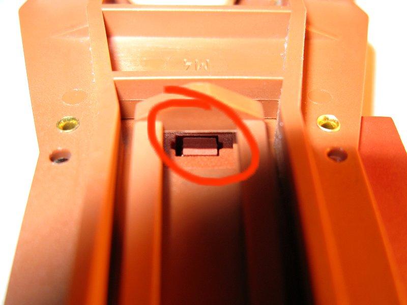

I've a (I think 5 year old or so) Aquarius 1100 washing machine.
Recently, it has been very temperamental in starting.
I can do a wash then, attempting to do another soon afterwards, it will not start
I can leave it off for 30 minutes or more sometimes, put the power on and set the program dial, press the start button - and it may then start (but after a minute's delay).
Sometimes I can't get it to do a second wash at all until the next day ....
I'm not sure if there is anything possibly blocked and confusing the programmer (if so, I don't know where to look), or is it a duff timer control/programmer.

I've managed to refit the door lock (not very tricky of course :) ), but now I wonder how I can actually test the lock to see whether it is dead or not.
Any ideas ?

I've messed up something, the door lock doesn't seem to fit properly anymore. I replace the screws and the plate at the front and screw into the lock mechanism behind. But the catch slider isn't in the right place anymore, so doesn't slide when the door shuts .....
Perhaps I've broken the door lock, maybe there's a bit fallen off I can't see,
I need to look for a replacement I expect ... googling now ....

I've got the piece off, and I think it may be a dead unit. I'm not sure exactly how it works, but when I slide the plate with the hole into the body and using a meter, I can't get anything to show that a connection is made across any of the terminals (assuming that's how it works).
Indeed, when it's in place next to the door catch plate, the hole is in the same position as the door plate. So I can't actually see how the door catch can move the slider.
In the 2nd picture, circled is a plastic catch that seems not to do anything. If I hold it down, it prevents the slider from going out fully. However, there is nothing to hold this catch down.

the secound pic is to release door from inside there is a plastic blob to press ,when the door lock is in situ the door lever silver bit locks into place pushing the mech across. the date code in top right hand corner poss have 97 98 or 99 on it means when it was made inside the lock is 2 biometal stips that close on heat , two red wires are live black is neg hope this helps

It's 98.
So, the reverse plastic lever doesn't do anything then I guess - because I can't see how it will work seeing as it is already "sticking up".
The door lever should push the mechanism across, but it doesn't seem to now.
I see, it's a heat mechanism, that may also explain why it's not working.
As I mentioned, should using a meter across the terminals show action when the mechanism is slide across ?
I suppose it's possible that there is a different fault altogether, and not the interlock. The problem is finding out how far the power gets .....

To add to my previous post, I see the underneath lever *is* used. When I slide the mech across, there is a "stump" underneath another hole which clearly pops up preventing the lock from closing.
I just need to find out now why the slider isn't sliding when I close the door. I seem to be fitting it correctly.

Sorry to reply again, but I'm now convinced it is the interlock.
If it has a bi-metalic strip, then this has clearly failed now. As the machine was slow to start a 2nd cycle (or not at all), and indeed sometimes slow to start an initial load - this seems to show that the bi-metalic strip is faulty and not heating up, or taking far too long. So, the machine effectively believes that the door is still open.
I shall buy a new one. We have a local shop that sells all sorts of machine items, so I'll try there first - if not, I'll order a genuine part online.

Well, I got one from a local shop (£14.50), strange name for a shop, but there you go ..... and about as cheap as I could realistically get online for a genuine part inc. postage (and another day without washing ;) )
The part has a date of 2/07, the other had 5/98.
I fitted it in less than 5 minutes, put the program on and pressed the fire button.
After 10 seconds, it started as it should.
Recently, as I sort of mentioned, it has taken 10s of seconds to even start up initially.
Ok, I've not done a 2nd wash as it's not currently needed.
So, currently I am very happy, and I thank you very much for pointing me in the direction I'd not even considered - by suggesting I gently tapped the door by the catch.
