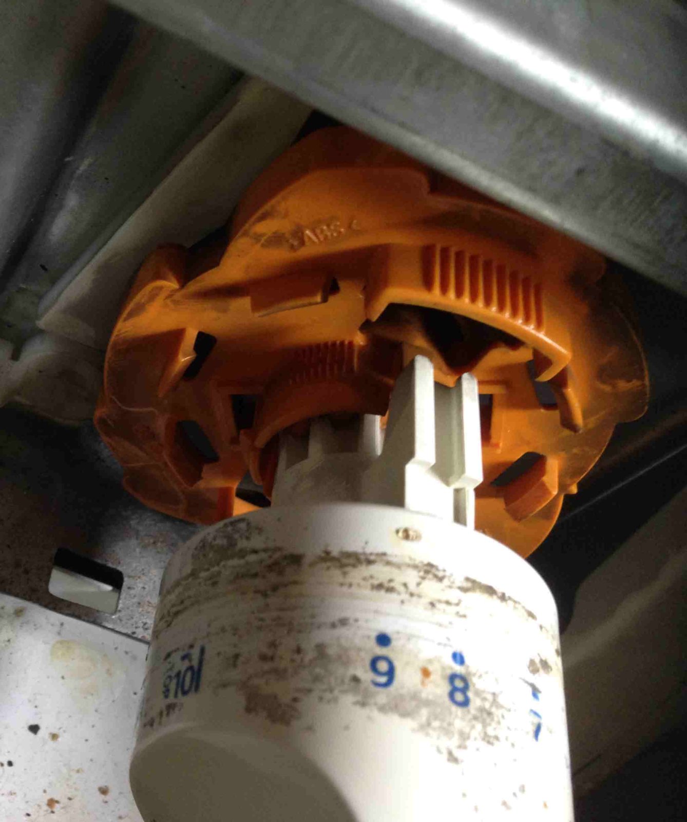

I wonder if anyone can help?
I need to replace the timer on my Bendix BIW 103W. It's held on with a couple of bolts which are accessible through the orange plastic cam. I can't see how to remove the knob and cam from the timer though to slide it out (see attached photo). The knob doesn't seem to pull off.
Any help much appreciated.

Is there a hole in the timer knob next to prog. 5. If so push something in the hole it should release the knob.
Thanks assuhors!
Yes, there's a tiny hole at the front of the knob. Once I removed the knob I just needed to undo the bolt on the timer shaft to take out the remaining 2 plastic parts.
Thanks again - I'd never have found it myself!
