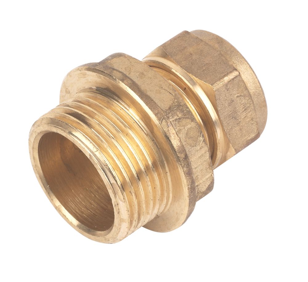

They tend to come with a isolation valves and I already have iso values in place. Am I right in saying they are 15mm x 3/4".
Can you get parallel male irons, which I understand are better for use with rubber washer based connectors (appliance inlet hoses) in 15mm x 3/4"?
I used the Kuterlite K611P for my bathroom flexi hoses, but it's only 22mm x 3/4".
One of these?
ae235
http://www.screwfix.com/p/male-coupler-15mm-x/82086
Yes that is correct, but I was wondering if they're available in parallel. They don't seem to be so I think this is the only option.
