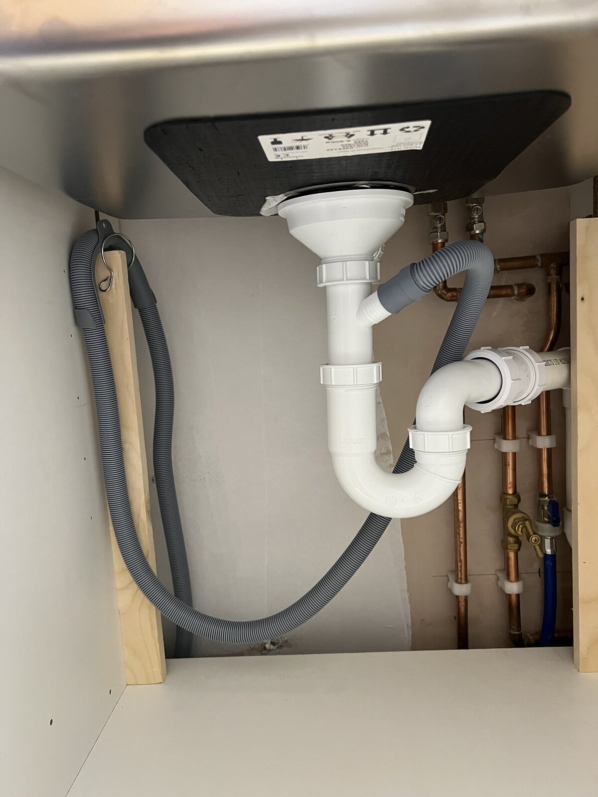

Any plumbers that can foresee issues with the below set up?
I have installed my washing machine and needed to extend the drainage hose. Only options I found was 2.5m. This is leaving a lot of excessive hose that I’ve had to arrange as in the picture. My concern is stagnant water building up and smelling between washes.
A jubilee clip will reduce the risk of the pipe popping off the spigot.
There is no need to elevate the left hand side of the pipe.
Cut off the excess, the hose will still fit the spigot.
If you cut off the excess, what will stop the water dripping out of the threaded part of the hose? And why cut away the excess in the first place?
Why would it? Just push it on to the spigot and use a jubilee clip if concerned.
It's far too long and not required. It'll just sit full of water, no need for it.
Is that a hose extension? Personally I would rotate the spigot part of the trap to enable the hose to enter from the left looking at it, and get rid of the extension (if it is one). The problem you have currently is there will be a smell because the u shaped loop will retain water, which could stagnate. The same will apply if you lower the left hand side as advised.

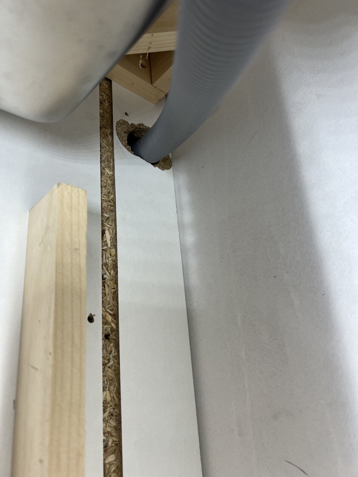

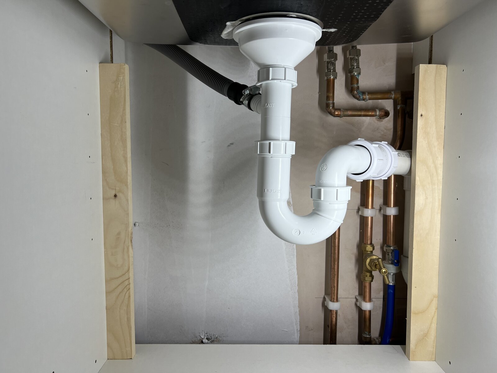

Thanks all for the advice.
In the end I decided to just drill a hole between the cupboard sections where the hose exits the machine and feed the original hose through (previously I was using an existing hole at the bottom with the extension hose). The advice to turn the sprigot really helped as well!
Much neater!
