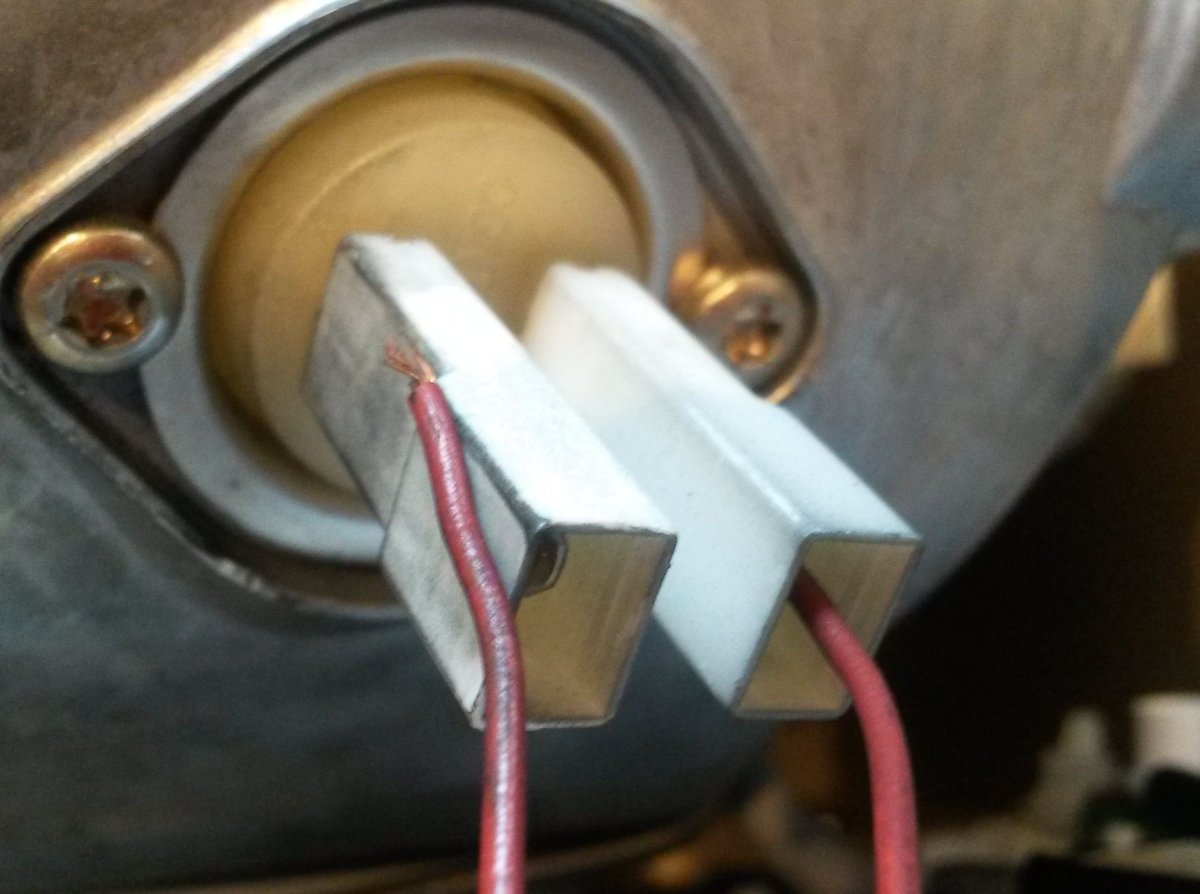

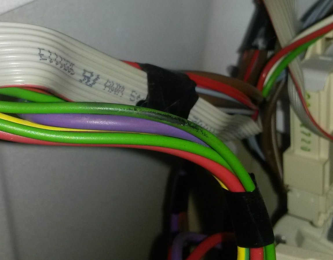

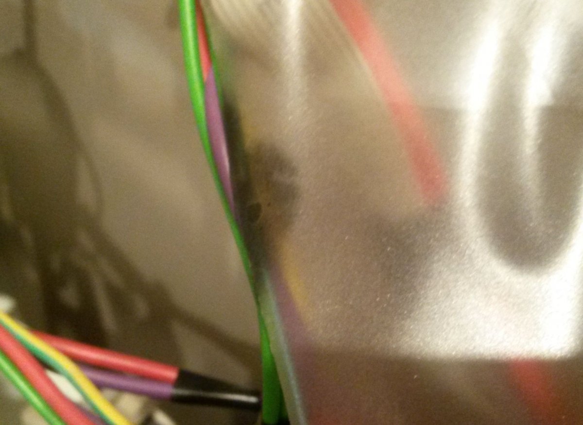

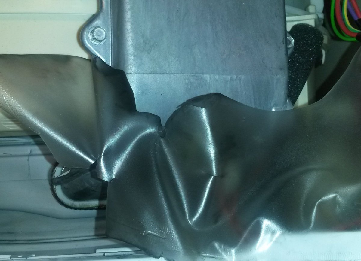

I originally posted this in Appliances and someone replied and suggested I post it here. My washing machine stopped working so I took off the top to see if there was anything obviously wrong. There was some cellophane or plastic that had burnt or melted (see first photo) and underneath I could see a wire has worked loose from the spade connector and the plastic cover, (second photo). Also, elsewhere on the loom there was another scorch mark on the plastic cover and underneath that one of the wires was blackened. Someone suggested it looked as if it was just a case of reconnecting a new spade connector but I should ask in this part of the forum in case there might be something else that could be wrong. Any advice would be appreciated. Thanks.

It looks like the wire needs properly crimping as it should not just drop off. Melting of the the surroundings will bearesult of the bad concretion. You'd need a proper rachet crimping tool and a new spade connector.

First one the damage to cover can't be seen well enough to comment.
Second one clearly needs a new terminal fitting the type used needs a special set of crimp pliers so I would used a pre-insulated one instead. It seems to connect to a temperature switch but could be wrong.
Third not good enough to comment.
Fourth the black seems to be paint rather than heat damage.

Yes I would renew the connector and replace any blown fuse and try it. But after that it would be load into car and take to local repair man. I am lucky car designed to carry wheel chair so easy to wheel in washing machine. If I did not have that car I would pay the extra and get man to visit the house.

Talking of sensors, it looks like that's what this is
So there might be some consequential damage from something not turning on or off when it should have done.
I guess the black plastic used to cover the control unit to cover it from major water leaks.
It may have overheated due to the wiring shorting out.
Fix the spade terminal and see if the washing machine works.
Talking of sensors, it looks like that's what this is ... So there might be some consequential damage from something not turning on or off when it should have done.
Theoretically true. However, that looks like a (probably N/C) temperature sensor (i.e. essentially a 'thermostat'), so its becoming disconnected probably "stopped something "turning on" (the OP said that the machine 'stopped working'), which probably would not have resulted in any consequential damage.

Or it may have come out of the terminal, causing the machine to stop, and the OP has placed it in this position to indicate where he thinks it came from.
