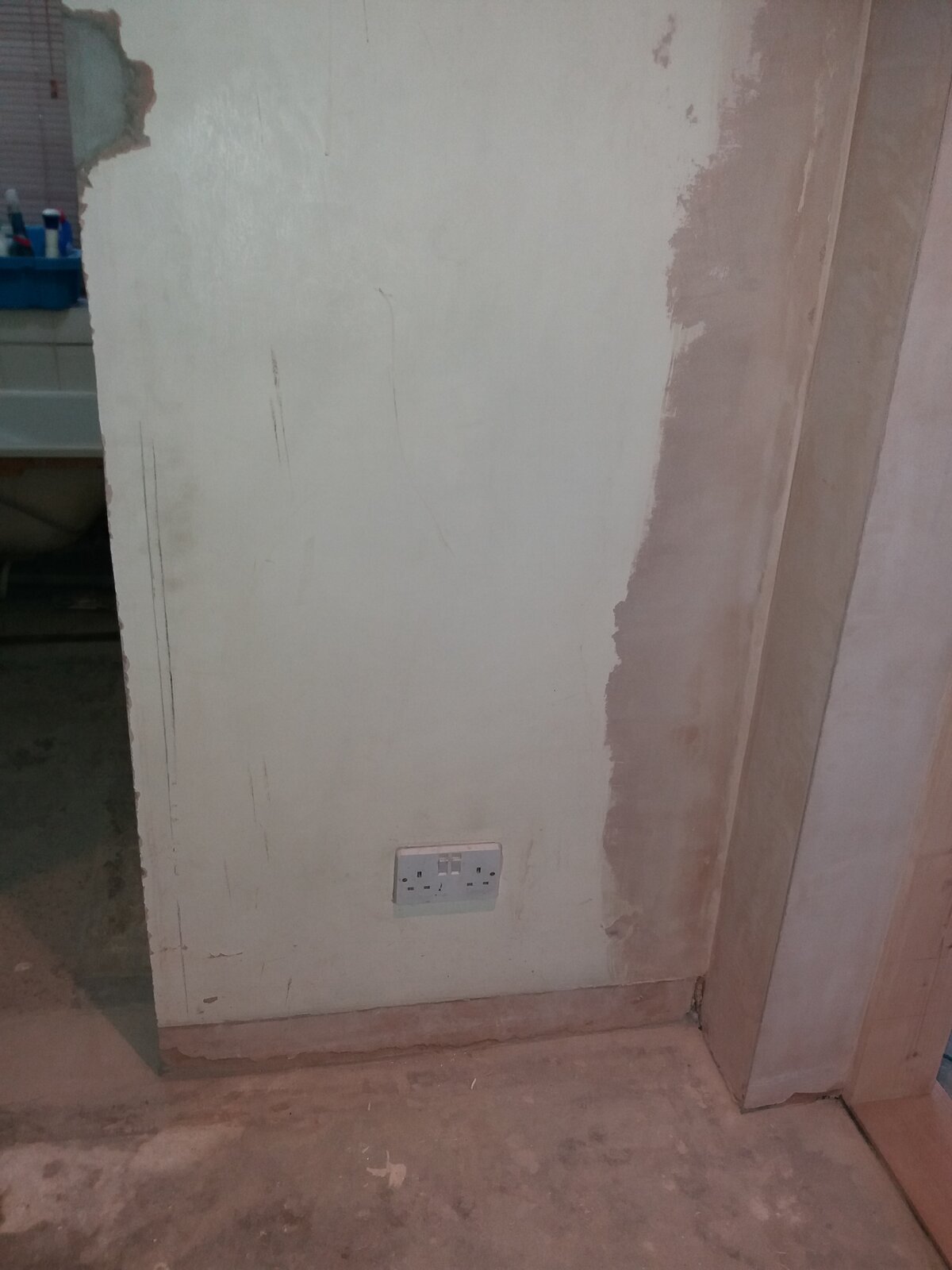

There's a dbl socket on the other side of the wall from the intended site, the live is 1.7mm dia. I might use that supply, although it is quite low down, olde style. I could even put an isolator on it. Washing machine to sit where the sink currently is.

Yes. You won’t be using the fused plug that comes with the washing machine. So a 13A fuse is needed somewhere.
Best option would be to put a fused connection unit (aka “fused spur”) next to the socket. Your washing machine can connect into that, through the wall, perhaps.
Maybe make sure the cable has to go up to reach the back of the fused spur. Just to make sure.

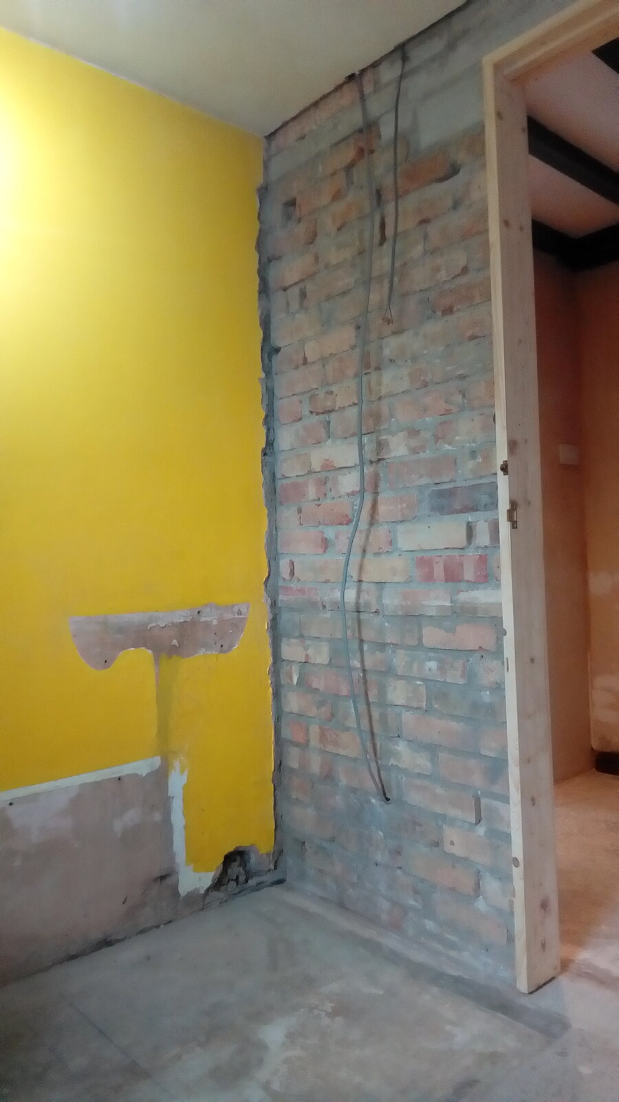

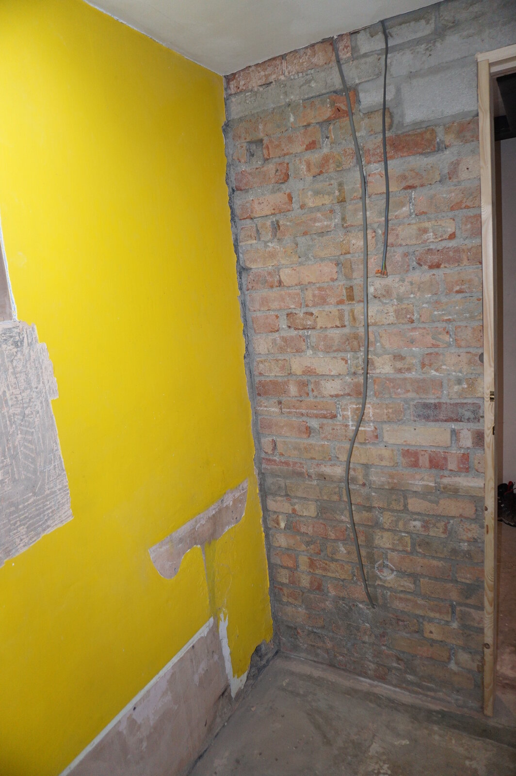

Also, I'd like an electric heated towel rail on the yellow wall, above where the sink was previously (washing machine going in the corner). And a light over a mirror on the red brick infill wall (lighting cable with Wagos).
Any thoughts?

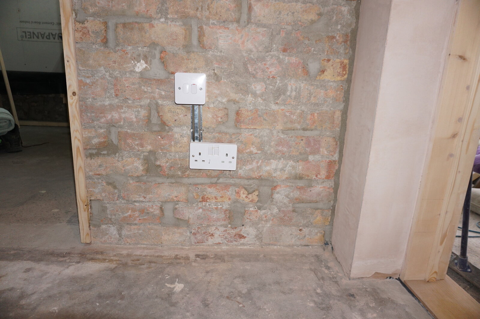

That's why the WM fused spur is outside the bathroom. With the cable access hole sloping at 20° upwards out of the bathroom.
