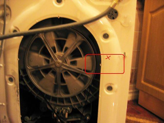

Hi all
My washing machine (BEKO WMA 642W - aprrox 18 months old) developed a leak this evening. I had a look to see if I could spot something obvious, and the water seems to be coming out of the drum housing itself. There's a few holes located up and right of where the belt sits at the edge of the drum housing, and when the washer moves in one direction water squirts out. I am happy to replace seals, but this looks like it requires the machine pretty much stripped down to get to it. (I hope you can understand what I mean. I can probably add a photo of the leaking spot if my description isn't clear)
Can anyone tell me if this problem can be easily (and cheaply) repaired, or should I start looking for a new machine?
Thanks in advance for any advice :)

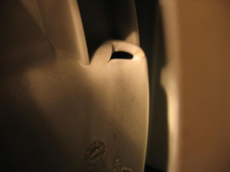

I initially though the hole was a fixing hole and supposed to be there, however it seems I was very wrong. There is a hole approx 1/2" square on the corner of one of the 6 'spokes' radiating from the centre of the back of the drum. I am not sure how this happened, and can't see signs of the missing piece, but I'll look closer before any repair if a repair is possible.
I tried to take a few pics. One shows the location of the hole - at the spot marked with a red X, and one shows a close up of the hole.
Could this be repaired?
it looks to be above the water line so it may be possible to repair if not too big, but any repair would only be temporary.
Most holes like that are caused by something being left in the pockets (coins, nails etc, have even seen a bra wire do this) and getting between the inner and outer drum.
exactly as leccy says
to do a temp fix which will last as long as the effort you put into into it
i would use the no more nails stuff in a black tube from B & Q , liberally cover the hole . let it set
cut a larger patch from a rubber glove and glue it over the patch and press on with a bit more glue.
if as leccy says its above the water level and there is not much water pressure there it will last quite a time.

The hole certainly is above the water line as the machine sits happily leak free till it starts to turn, so I will attempt a repair as described.
If whatever caused this is still in between the inner and outer drum, then I am guessing it's pretty much stuck there and this could easily happen again?
As an update....
Using a combination of no more nails, a rubber glove, and a coating of araldite the leak appears to have been plugged with the first wash completing with no puddles on the floor :)
