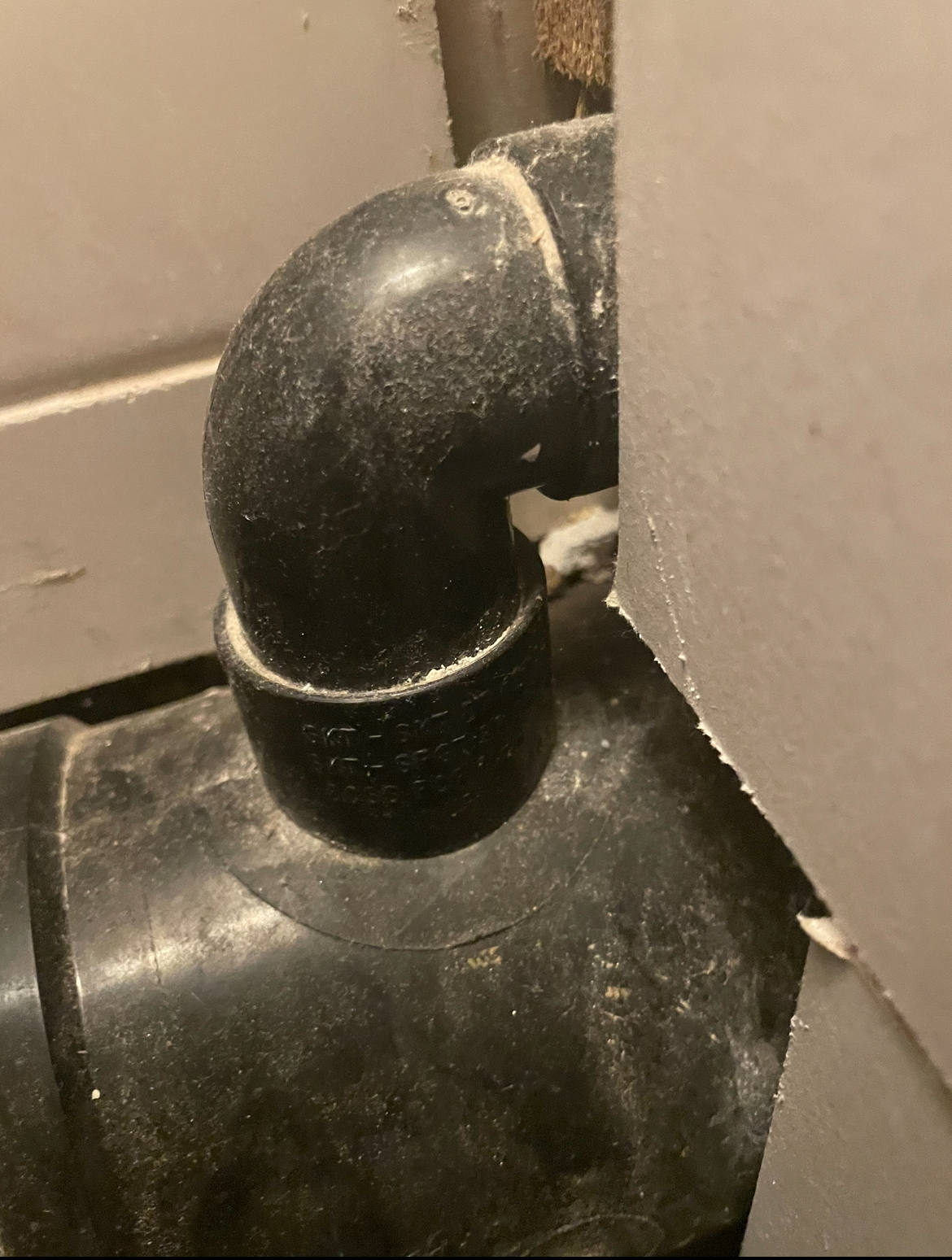

FWIW - this is where the 32mm goes into the toilet pipework. It’s in the corner behind the toilet. On the right is plasterboard. Even just to see what’s here means removing part of a wall. Changing this connection at all means uninstalling the toilet for sure

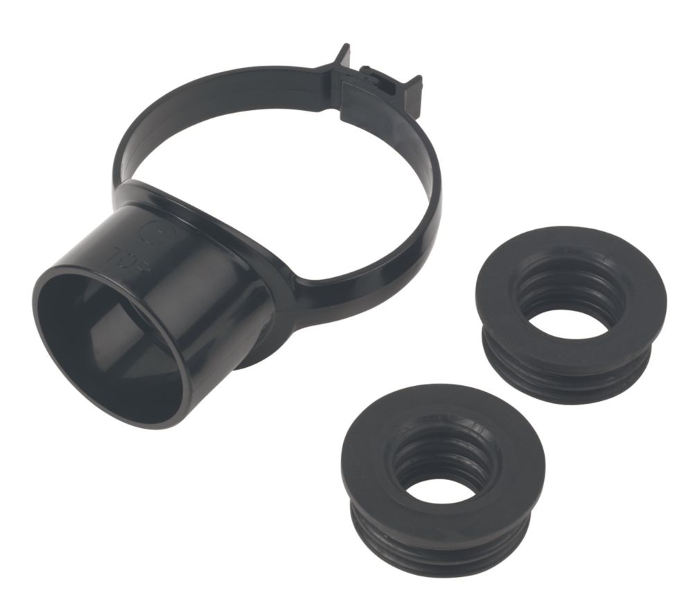

If I did want to switch up everything to 40mm can anyone recommend something that allows me to plumb 40mm into the toilet outflow? I can’t seem to find anything
This’ll work if I go the whole hog?
Are you sure that's a 32mm boss, that would be a little unusual.
If it is then you would probably be easier cutting off that 32mm boss and then core and glue a 54mm strap boss into it. Then a reducer to take it to 40mm.
On the current fitting - I get you. That might be the way to go

It's 1 1/2" so I think
if it's 1 1/2" (40mm) then what's the issue?
Apologies just trying to visualise - where is that elbow/boss and is the pipe on the other side of it 32mm and that is what you want to connect to??
@Madrab - cross wires. My initial idea was to replace the soil/pan pipe with a new boss. But I think coring out and a strap for what might be a few months before a pro comes in and scrap everything is a great way to go
