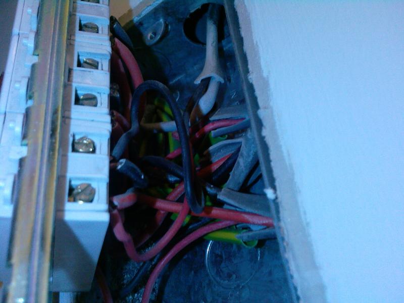

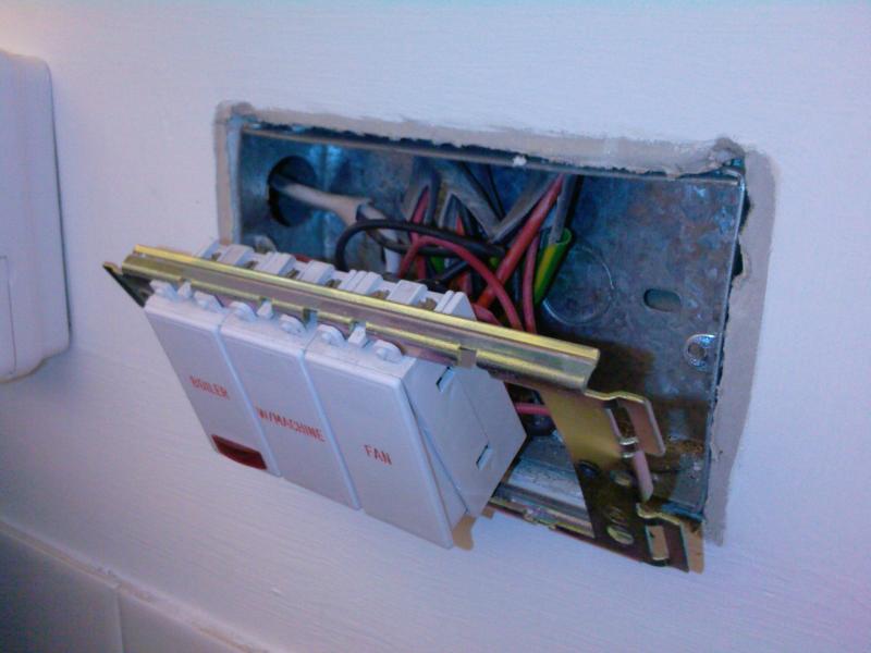

I thought it worth posting the set up I have in my utility room to highlight the dangers of putting a w/m & t/d in the same double 13amp socket, and not taking professional advice from an electrician. I used to have just the w/m in the utility but got a plumber to alter it so the drier could fit in too. He just changed the single 13 amp socket to a double, supplied by this Tenby grid switch:
One day the 20amp double pole switch engraved "washing machine" started sizzling so I switched it off and got a professional round. The washing machine switch was burnt out due to overloading.
He also noticed that my burglar alarm ( the white cable) was wired into the supply of the extractor fan. It was the wrong size of cable, no fuse, and had no grommet. The fan itself was not fused down and was therefore being supplied from the ring main:
These latter 2 issues have been present since the house was built which really cheesed me off. :evil:
My professional sparky is going to sort it out. :D
Anyway - thought it worth highlighting what can happen with overloading in a kitchen environment.
the double socket will also have been overloaded. They are not rated to two large appliances.
This problem almost always occurs when a Drier and a Washer share a socket :( There are very few other cases where two large appliance loads are used together. Sometimes a dishwasher though its heating cycle is shorter.
I have often queried the supplying of 20 amp switches from 32 amp ring mains it is often done and to 17th edition 433.2.2 the outlets need to be within 3 meters of the switch. But if from a 20 amp radial there is no limit.
I have seen double sockets replace single sockets which were supplied through a 20 amp switch where the person doing the work is unaware that there is a switch on the supply.
