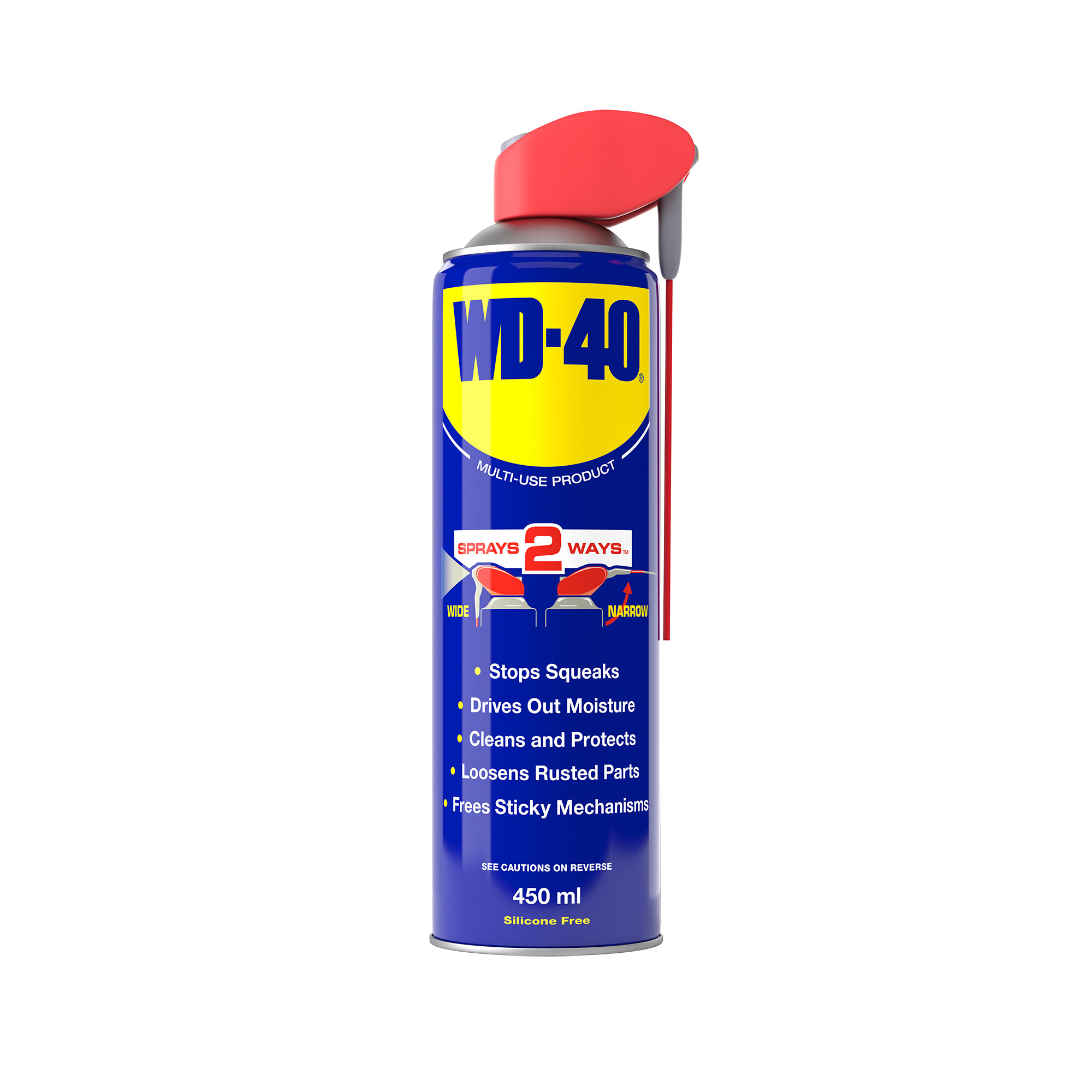

WD40 is not a lubricant, it is a water displacement fluid, the 40th version. Use a thin penetration oil.
. Ever read the tin!! Particularly the bottom row.
It does what it says on the tin :)
It's not the best at freeing things up, but it's a good 'goto' for many things, despite its primary purpose of only dispelling moisture. It is not a long term lubricant and eventually - goes sticky itself as it evaporates.
