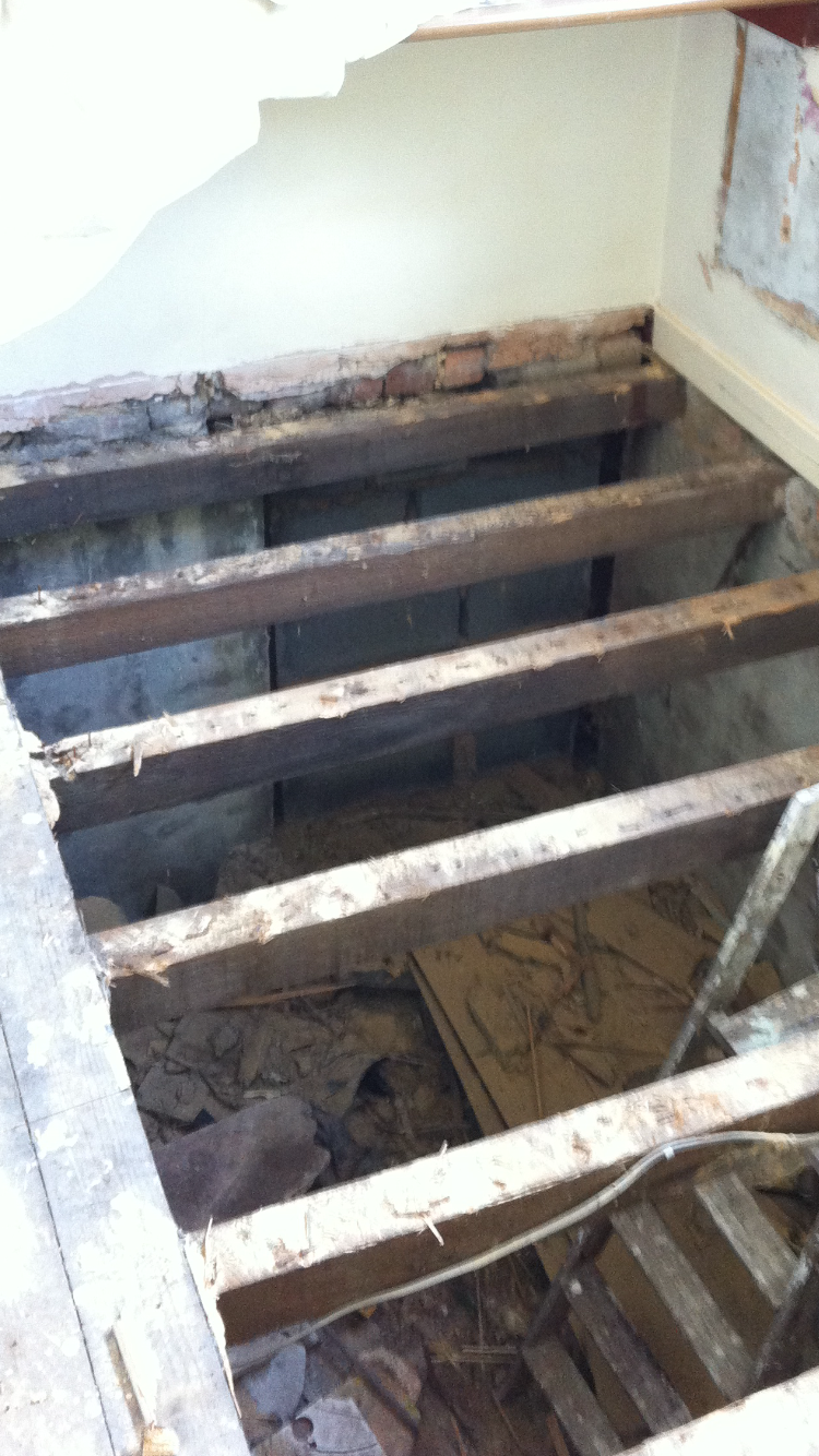

Apologies for the rough picture it was taken a while ago when I cleaned out the crawl space void (it’s not a cellar), insulated it and replaced the rotten floorboards.
Anyway it’s only been used as a dry utility and office for a while but now we are moving the kitchen around.
Along that far wall will be tumble dryer, washing machine and possibly a 200l accumulator.
I’m guessing I need to beef up a couple of those joists?
Is the best way to do this ..
1: Sister the first two joists
2: Some kind of catnic or rsj solution?
3: Build a couple of block piers ad 1/3 across.
4: Buy a couple of acrows and leave them under the floor to support the weight?
5: A mini mezzanine type thing under the floor?
Washing machine vibration / is also an issue... I think the cavity will act like a big drum?

You might be overthinking this. All of that is pretty standard stuff assuming those joists are sound and correctly sized for the span.
Yes that had crossed my mind but its a really old house....You might be right of course but the look a bit piddly to be holding 150plus KG and a shed load of vibration?

I would suggest 'could' start by putting some noggins between the joists at mid-span:
Would also ask what is the span of your joists and their height and thickness dimensions.

For the accumulator I'd probably just make a platform that spreads the load across two or three joists.

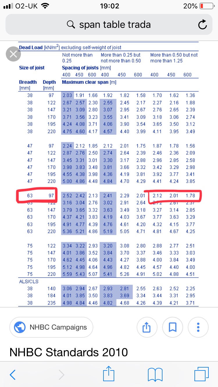

Trada says 125nm load on those joists (I’m guessing the exact size) is 2.1m span but I think the centres are wider than 400 tbh.
I’m thinking of getting some of those decking feet and installing 4 mid span support posts 4 inch square? But I want to be sure it’s going to hold.

See above reply .... 125kn is under 2m the floor is 2.5

I only know the rough science but
when I add the weight of a washing machine its more that the 125kn load on the trada tables.

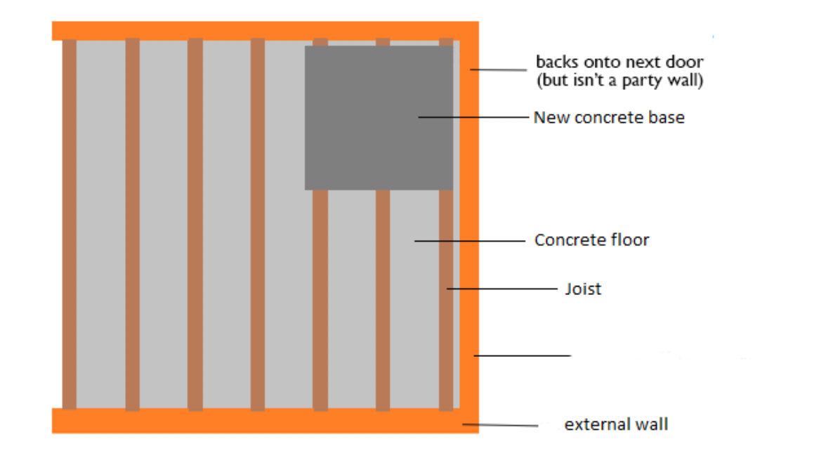

Think I'm going to build a solid platform but it's about 4ft deep.
My Plan is as per the attached (pinched from another thread) .. I'm going to build a blockwork wall up to floor height.
Can I backfill this cavity with any old rubble like old bricks etc (removed from the chimney that's being opened up) and then top off with a poured 4 inch concrete slab?
