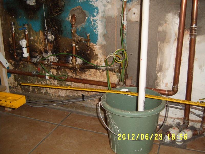

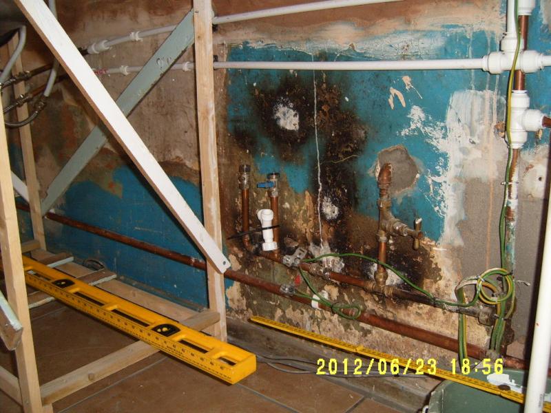

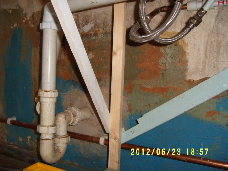

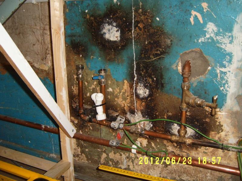

I have a new kitchen coming soon and I need to be able to connect a washing machine, dishwasher and the condensate pipe into the waste pipe, which is shown on the left.
The sink will be the bowl and a half type, similar to this,
http://tinyurl.com/7khru2n which will be approximately where the sink is sitting now.
To the right of that will be the dishwasher. And, to the far right, in the corner under the boiler will be the washing machine.
What will be the best way to fit it out?
if you have an integrated dishwasher it wont go on the right w/o sticking out past the edge of the worktop. dishwashers fit hard against the back wall, well my bosch does, and there is a small space at the bottom of the dishwasher say 6 inches high by 2 inches deep for services to pass along.
so if you look at the amount of stuff on the right its a lot to move inc. the stopcock
if someone asked me to fit one in your kitchen, without prompting me id be looking at the l/h side of the sink. far less work bud
Just to give an update on how it went.
Everything went according to plan, the extra 65mm did the trick to allow plenty room at the back for the services so, no need to re-site anything to the left of the sink.
