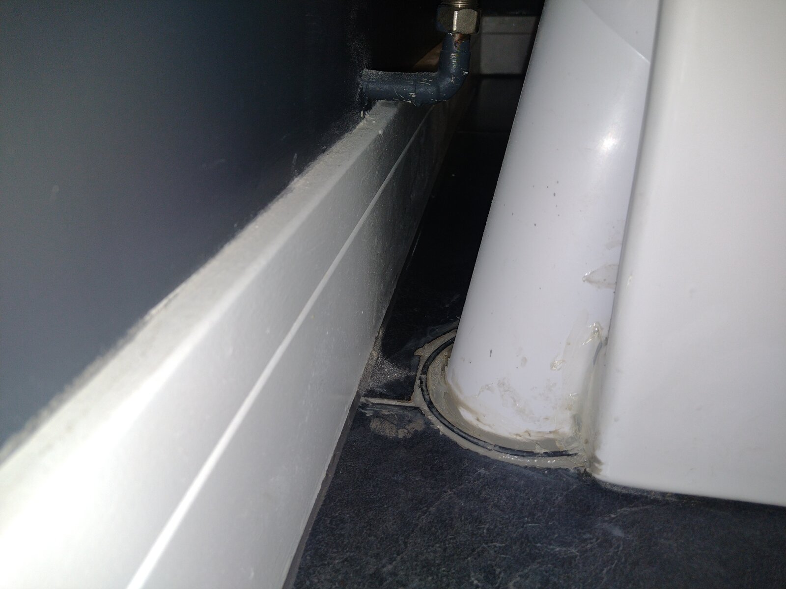

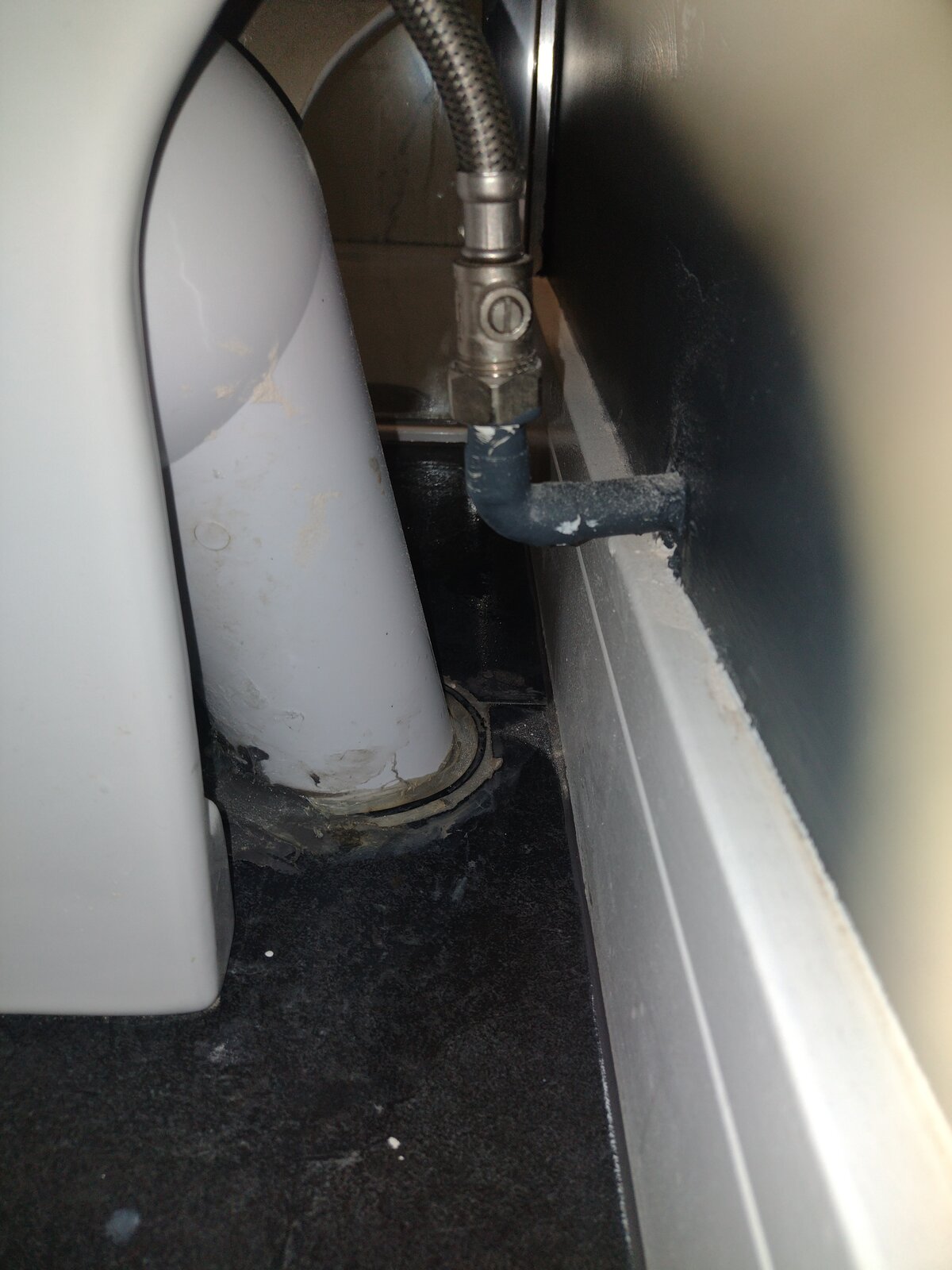

I recently had a new toilet/shower room fitted (none previously there)
However, toilet waste keeps getting trapped in the toilet bowl. I keep having to pour a bucket or water and use the toilet brush to rod the waste down.
It is not a blockage and the toilet has a strong flush.

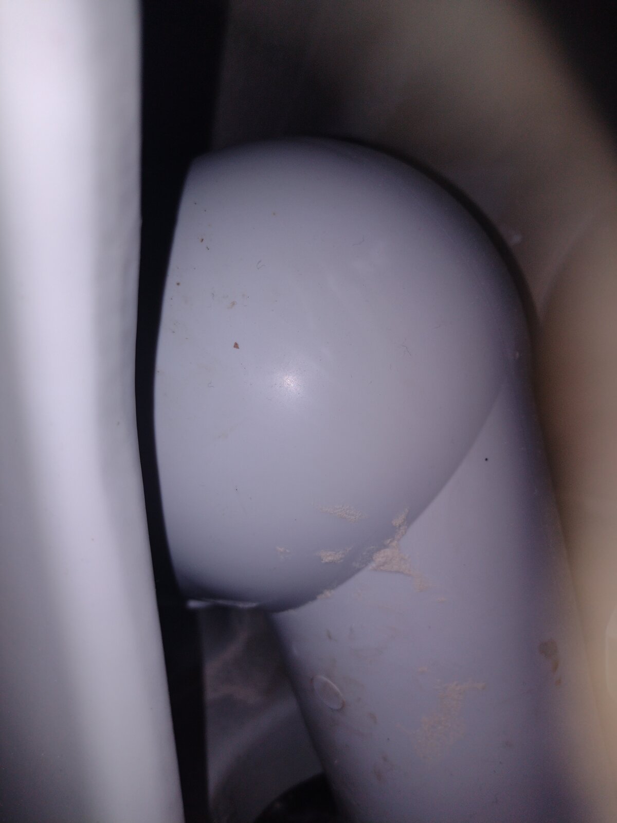

However, looking at the pan connector, the fitter used a rigid one and it is not straight (i.e. in line with the toilet). Could it be this?
Besides calling the fitter back, does anyone have any advice on how to rectify this situation?

You need to call the fitter back to check everything....
A bent pan connector like that shouldn't really impeded the flow and thereby the waste being taken by the flush around the bend and out the toilet.
They have had major amounts of R&D to create the design for these things and they do work well so I wouldn't think that should impede the waste. There are extended bent pan connectors where the spigot side of the connector is longer which would allow it to be more vertical into the pipe in the floor.

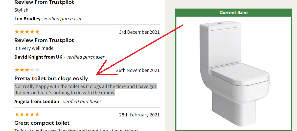

I also just had a look at the reviews for the toilet and one person mentions that it cloggs easily.
As you appear to imply, this could be an issue with the actual toilet. I will contact the seller/manufacturer.

Could the pan connector be too close to the pan spigot as its at an angle ,cutting off its flow?.
No, the water level looks normal.
Ok, so if that's the case then the flow of water around the bend and out to the soil pipe doesn't seem like it's being restricted. Therefore the pan connector would be a suspect. If it was a 'bottle neck' it would be expected to see the water level rise in the bowl as it flushes and then drop back down. That being the case then the suspect would be the design of the bowl itself and there isn't enough velocity down and around the bowl trap itself to carry the solids away properly. Especially if then using a bucket it still doesn't shift.

I'm looking at the picture you have sent and think you need yo stop calling him a fitter. It appears to me he's a shover.
Some toilets can have a poor cast.
Regardless if the poor choice pan connecter is to blame or not, it will leak prematurely.
I suggest you get the shover back and maybe as said look at your diet.
