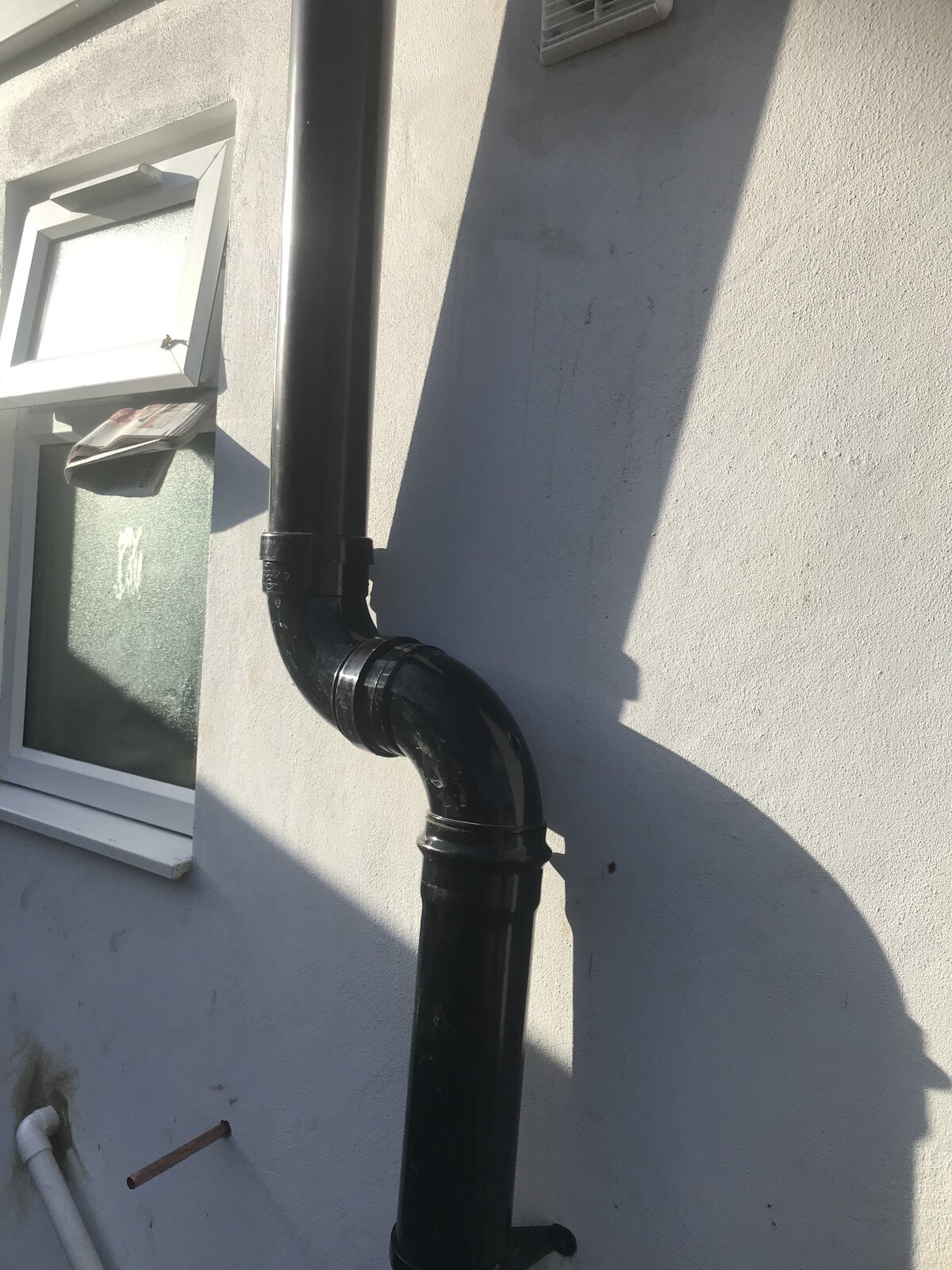

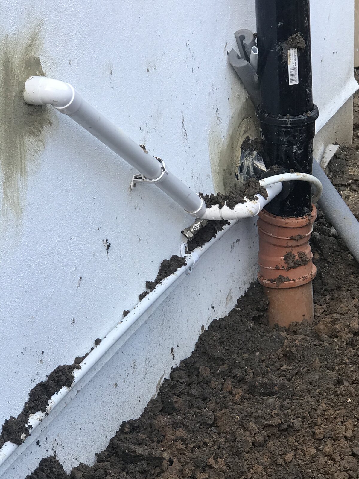

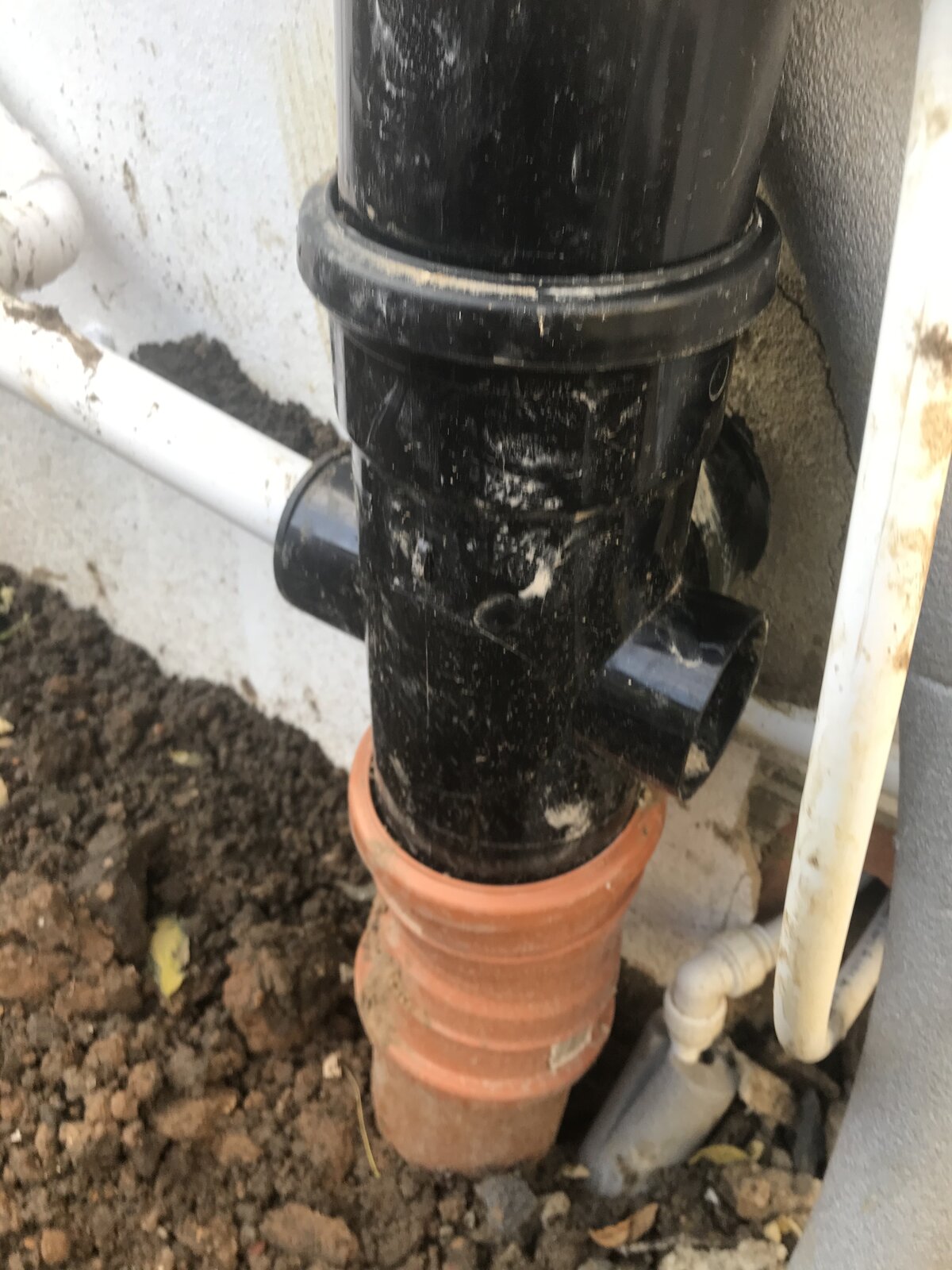

My builder installed drainage at my outbuilding with waste pipe and soil pipe but smell is coming out somewhere. He is not reach able. Been calling and I am tired. Please I need advice of what to do to rectify it. I cannot see any leakages yet.

Dribble some water around the top of the joints if it drains away then seal has not been made .
