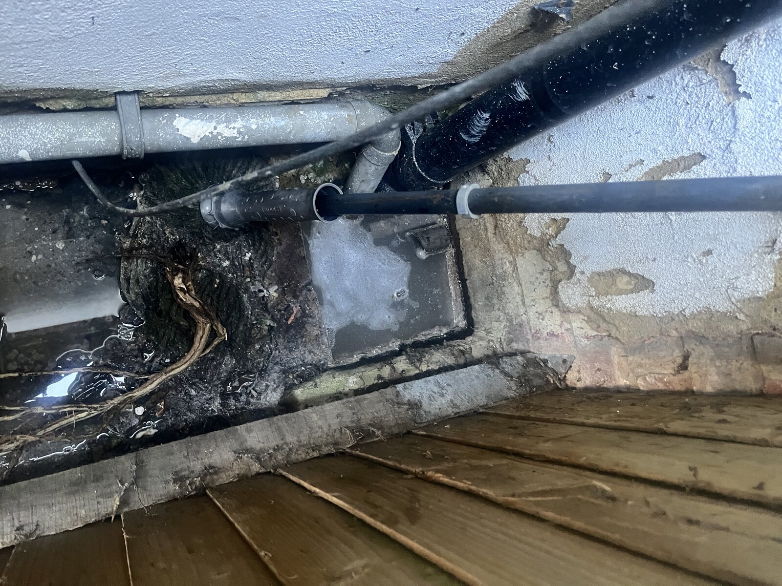

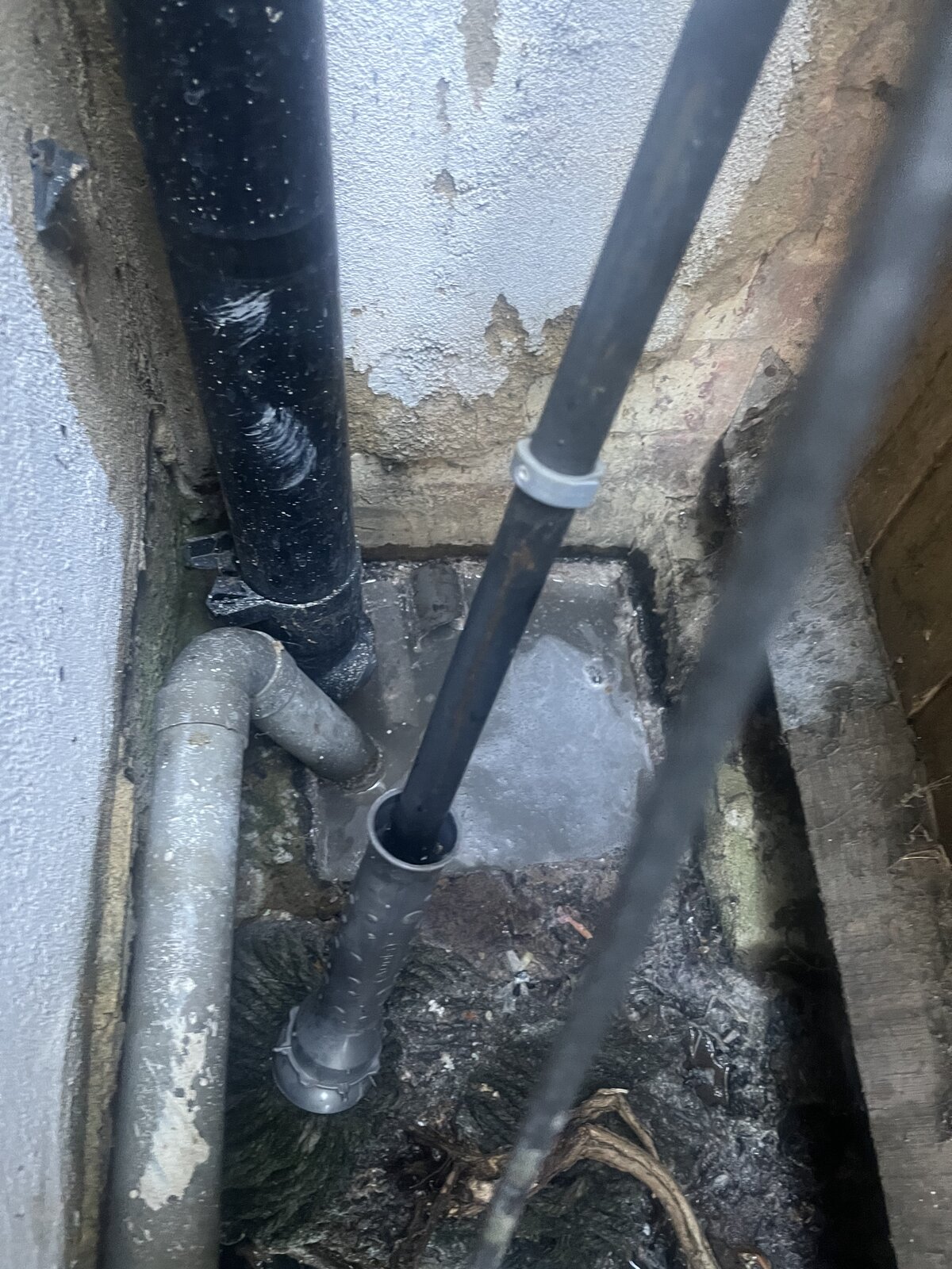

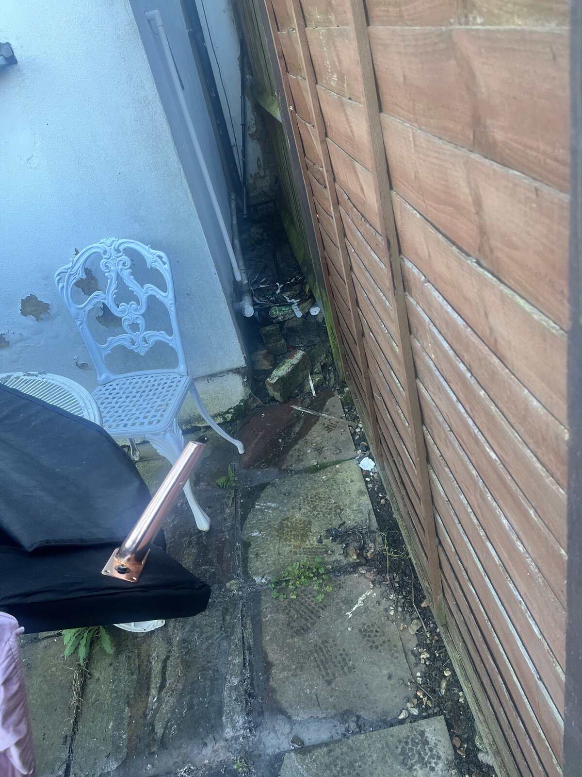

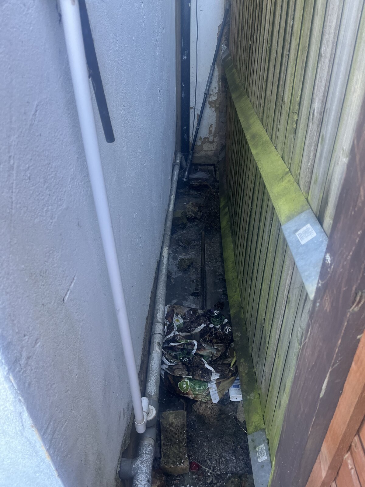

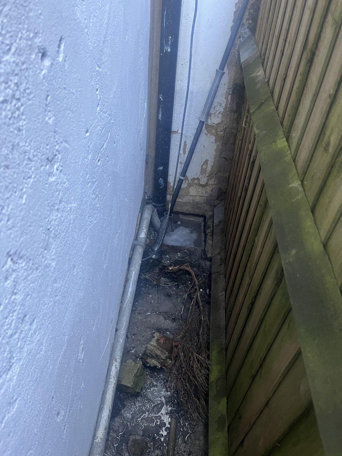

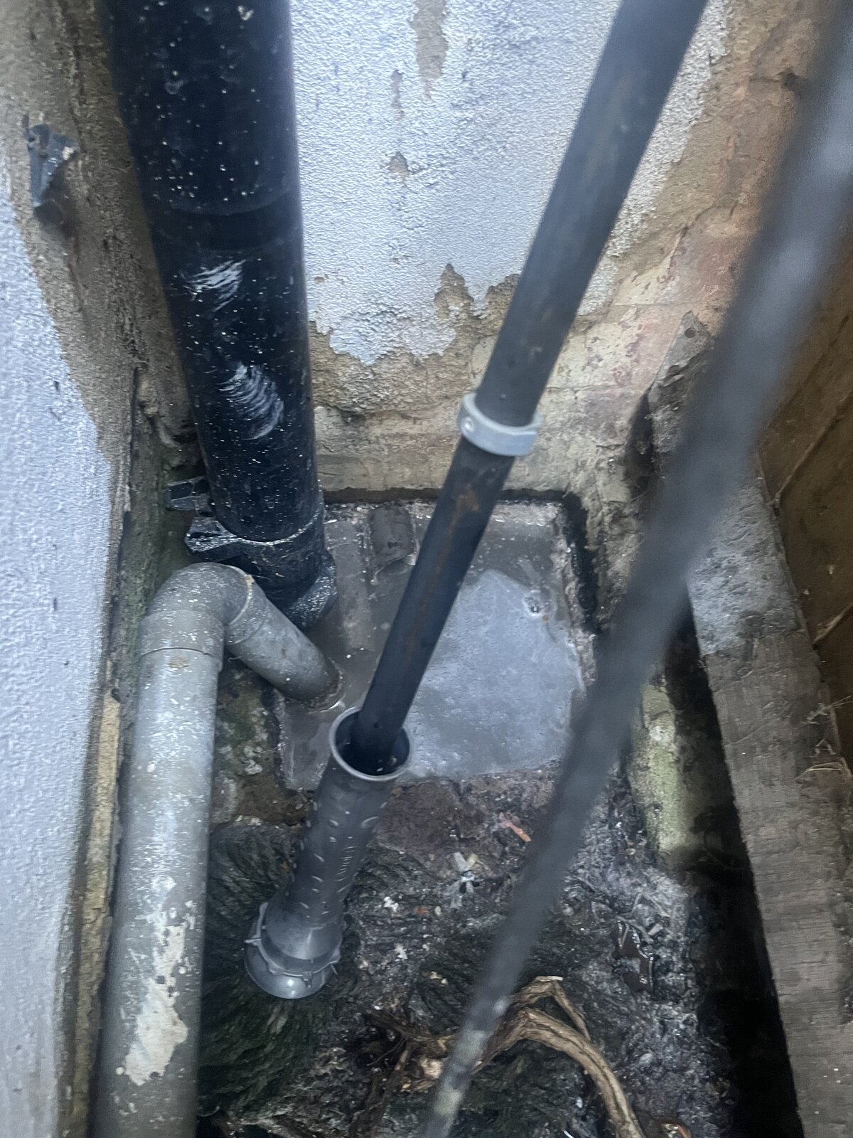

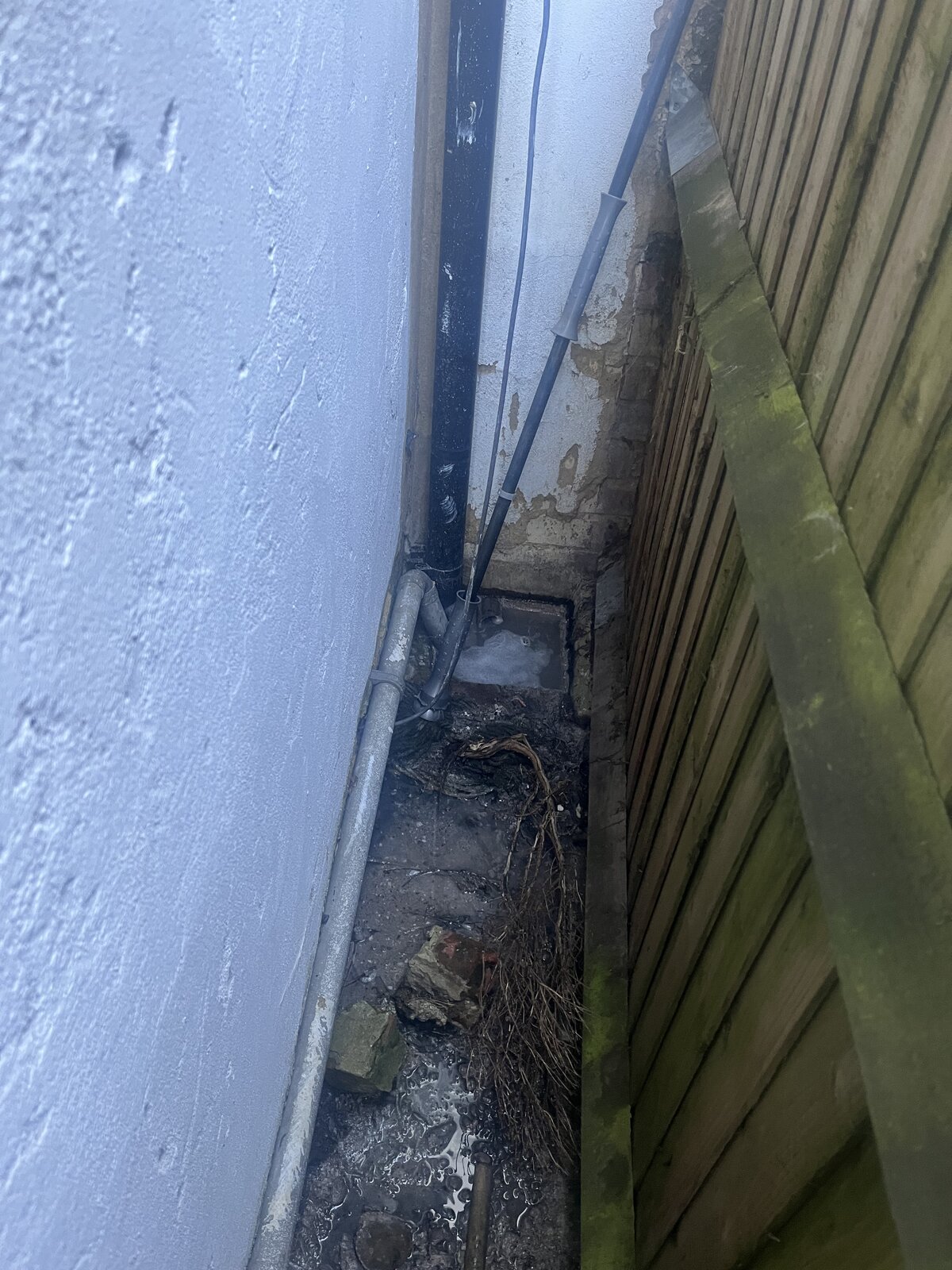

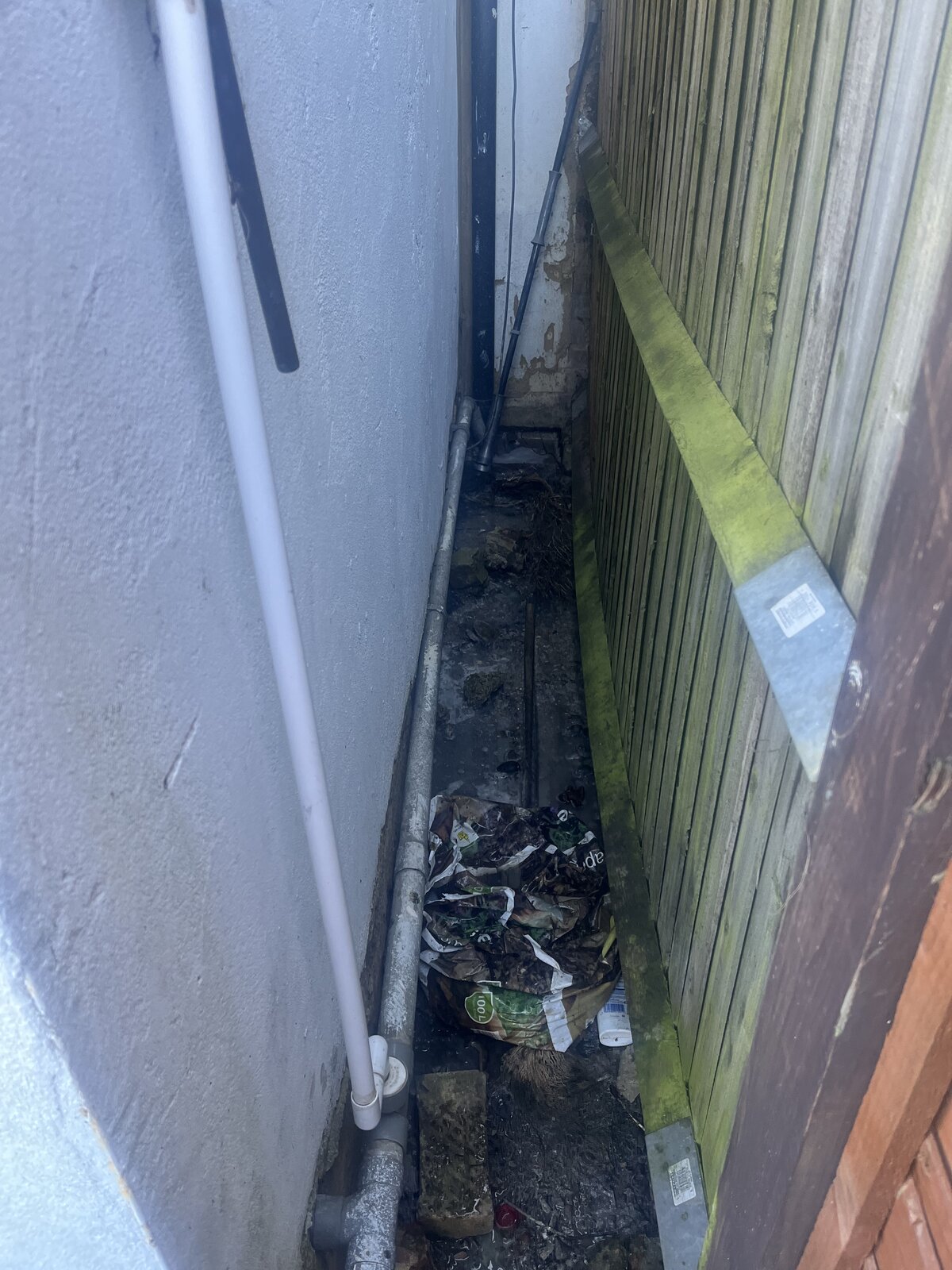

I have a issue since moving in this house with the waste. Sink gets blocked, shower gets blocked and basin gets blocked. I have managed to get to back of the house we’re the waste pipe is. I have taken a few photos. I would love advice and help on how to rectify this.
Also how to clear the blockage.

I thought that it all must go to into a stack. But it seems to just be going into the ground and left there ? I’m not sure
Looks like a blocked gulley. It is very likely broken.
How old is the house?
You are probably going to have to dig it out and replace
looks like access will be difficult with that extension in the way.
how do you get on with your neighbours on the other side of the fence?
Hi Ricky,
Do you know where the nearest manhole is - & can you lift the cover?
The gulley trap and/or the gulley drain pipe are blocked.
Wearing rubber gloves or gauntlets you can reach into the gulley and clear it of debris and water.
The gulley drain pipe might run into the nearest manhole?
I noticed a bit of bushy debris that had maybe been removed from the gulley drainage previously?
Did that bushy thing (it looked like roots) come from the gulley? Or was it simply a dead bush?
After the gulley trap is cleaned out then,
you might have to work back from the nearest manhole.
I'm on my dinnertime now but there are a number of other issues that I'll comment on this evening if you want?
Looking at the colour of the water it looks like a grease buildup.

I can’t find the nearest manhole. Also regarding the bushy thing it was there before I checked I presume it was just some dead leafs. I’ll clear out the gully trap. Yes please if you could give those comments

The gulley drain pipe might Tee into the soil pipe thats draining the vertical S&VP (

There is no vertical S+VP . that's a rainwater size pipe. Don't bother commenting this evening. Though your powers may tell where the actual soil pipe is - you see and know things many of us don't
Ricky,
Your gulley drain could be blocked with roots or, given its age, it might be broken.
After repairs cover the gulley hole with a metal grate.
To examine the gulley, & its surround, you need to clean all around the rain water pipe and the gulley - high pressure hose works best. Then dry it off, and then look for cracks etc.
Can you say what the various pipes & bits of pipes are being used for?
The pipe clipped low along the wall has as dip in it that could block now and then? It needs re-fixing to falls.
The loose elec cable needs being made safe.
If you own the property there are a few other issues ref rendered walls & plinth, and possible interior damp.
Keep looking for a manhole - you might need it?
