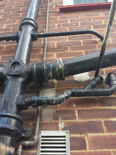

Hi all.
Would someone be able to advise the best way to fix the following?
I have done some searching but cannot find a seal or push fit connector, possibly due to me not knowing exactly what I am searching for.
As you can see it is totally perished.
Any advice is much appreciated.
Thanks.
That fitting looks like a PVC pan connector (Painted Over) or an old asbestos fitting
You could try one of these connectors, going by the picture you should have enough room on the cast pipe to fit this adaptor
Thank you very much for your reply.
I managed to get the exact push fit from screwfix. I took the old nasty one down there and a plumber identified it.
