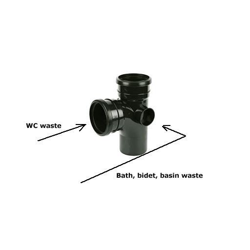

Use A with an air admittance valve on the bath trap. "Anti vac" traps can be noisy. You only need one AAV, at the first waste.
EG one of these:
NB your basin and bidet waste pipes need to be 40mm not 32, and at 3m I'd use 50mm for the bath or it'll empty slowly.

Question: regarding traps, what is the difference between a 3"/75 mm seal and a 1.1/2"/38 mm seal ? Which one is right for 40 mm pipes?
Also, a bath trap for a 50 mm pipe isn't very easy to find apparently :(
OK, got it, just in case somebody else needs to know:
'The seal dimensions below refer to the approximate depth of water trapped in the bend'

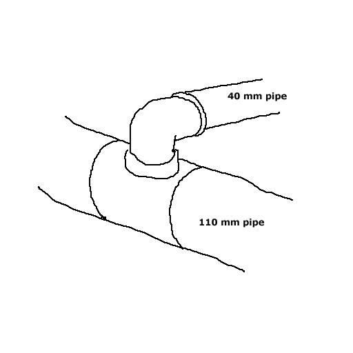

OK, but what if I send the wastes into the horizontal 110 mm pipe from the top, like this?
Solution C may not fit anymore if I have to use an individual waste for the bidet. Our space there is very limited.
For C, what would be the required size for the pipes going into the stack from basin/bath and bidet?
Also, why do you say the bidet waste may have to go below the branch? Regulations?

Just one more silly question.
Assuming I do option C above, would the following branch be ok for the purpose?
