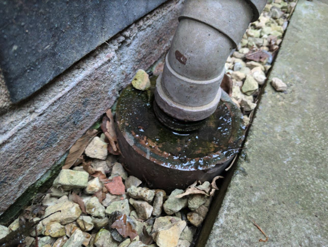

I currently have the below set up for my utility waste.

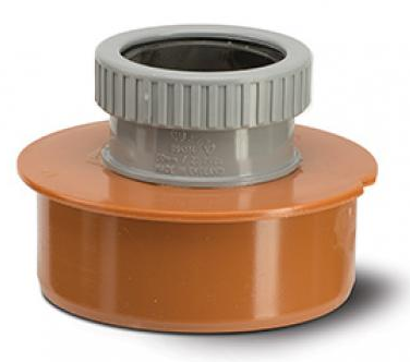

As you can see, it's leaking and not great. Is it possible to replace with something like:
or
Also as part of a kitchen remodelling I will require a new sink waste where there isn't currently a soil pipe, can I use one of the above and connect to the existing underground run of pipe without a below ground trap?

Excellent pics - what you have is a piece of Hepsleve drain pipe sticking up with a stub of pushfit waste cemented in - then pushfit fittings. You will have to adapt the hepsleve to plastic BUT the adapter goes over the pipe and you have no room. The push fit fitting is leaking , it can be replaced. Re: kitchen you could have a "mini soil pipe" known as a Stub Stack up a wall for the connection.
Thanks Nige.
I will probably dig down as it's only gravel so I can cut the pipe down, fit an clay to plastic adaptor then place one of those waste to soil fittings on top.
I would rather not have a sub stack as it's down a tight alley down the side of the hose and I don't want to make it any tighter. Is making a new one of these waste to soil connection within the regulations? I have tried to find out but they don't seem to say yes or no. I'm assuming as they sell the fitting it is allowed.........?
