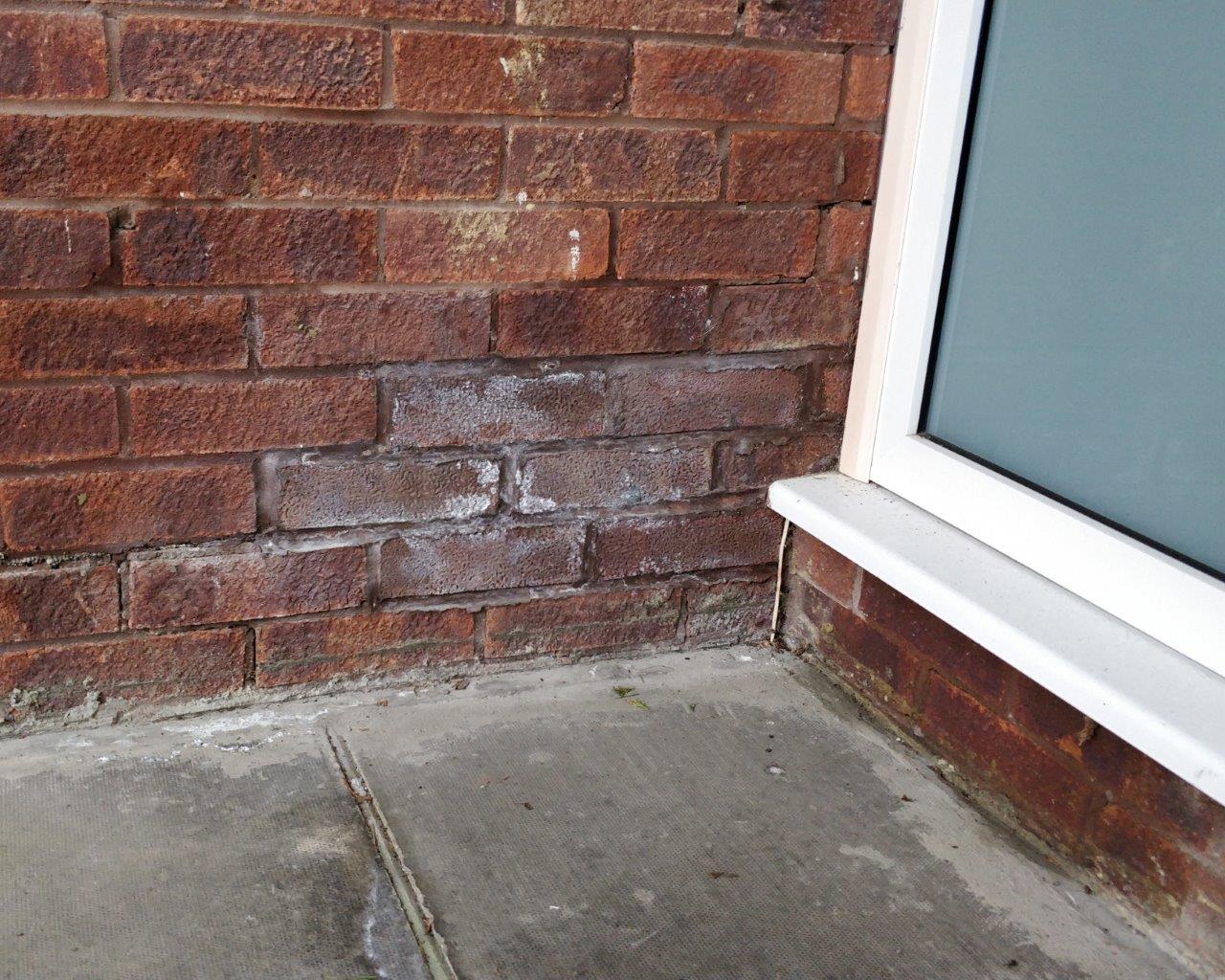

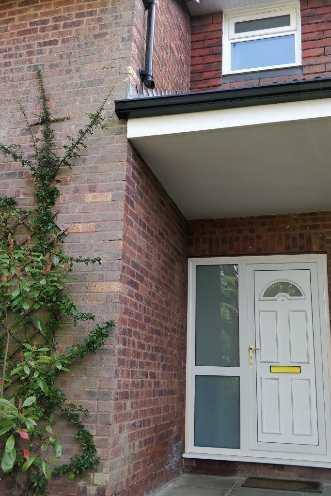

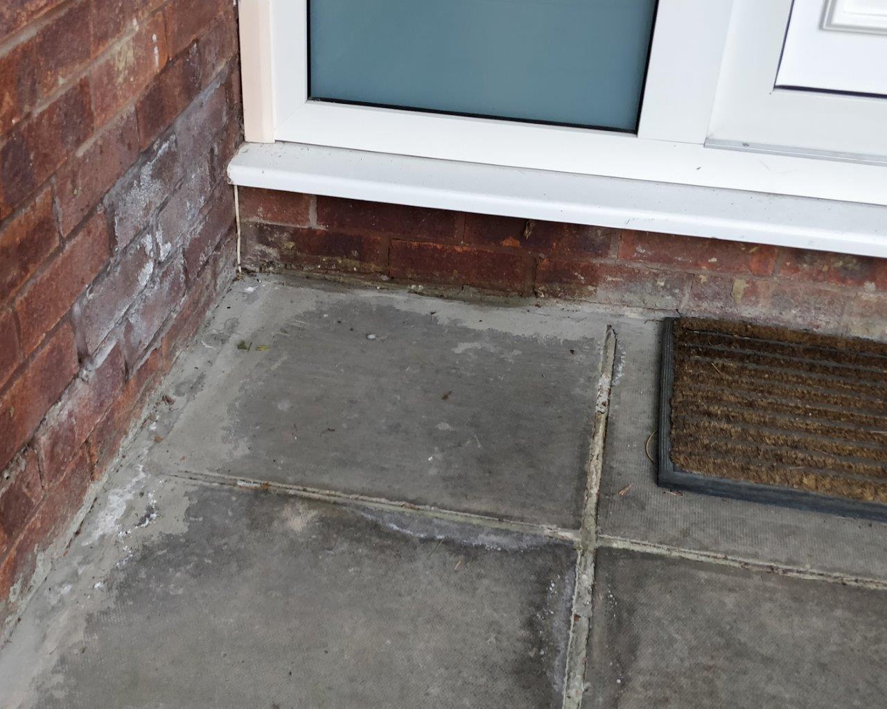

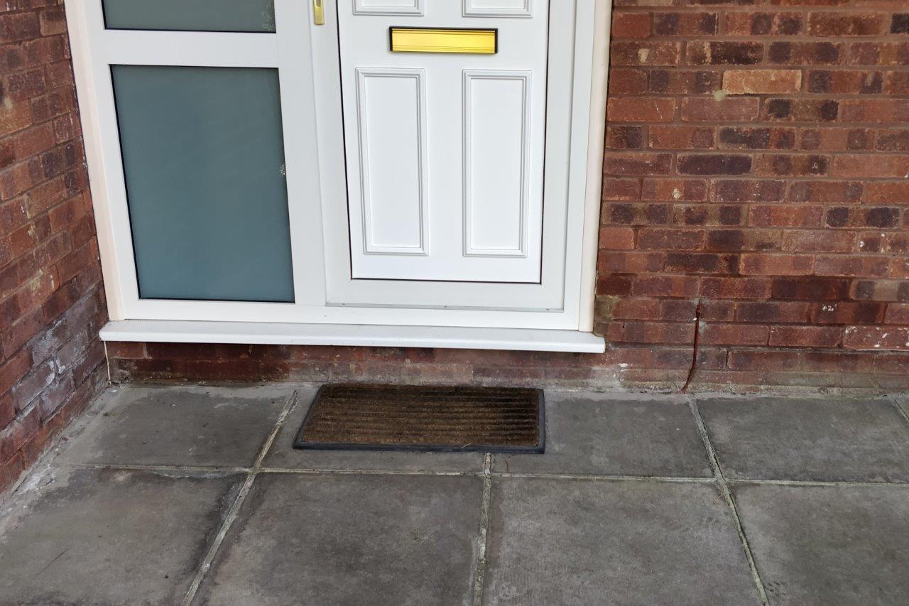

Hi - I am hoping somebody might be able to help me please. As you'll be able to see in the attached photos, I am getting water in brickwork above the DPM after heavy rain. The affected walls (to the left and right of my front door) are covered by a porch and it is not possible for rain water to splash this area. Internal walls are not damp or stained. I live on a hill with land raising behind my house, and falling away in front. The soil in this area is a mixture of heavy clay and chalk.
I've had this problem for a few years now and have tried many things to fix it such as:
At this point, I'm not sure what to do next or who to get help from. If you have any ideas on something I may have missed, I'd appreciate the pointer please. Many thanks.
- Having some bricks removed to see if the cavity is blocked with building material
- Looking to see if cavity wall insulation is causing problems
- Having the DPM inspected and reinstalled in places
- The roof has been checked, fixed where issues, or potential issues could arise
- Lead repointed on porch roof
- Porch roof inspected for leaks
- Damp specialists
- Architect
- Roofer (couple)
- Brick layers
