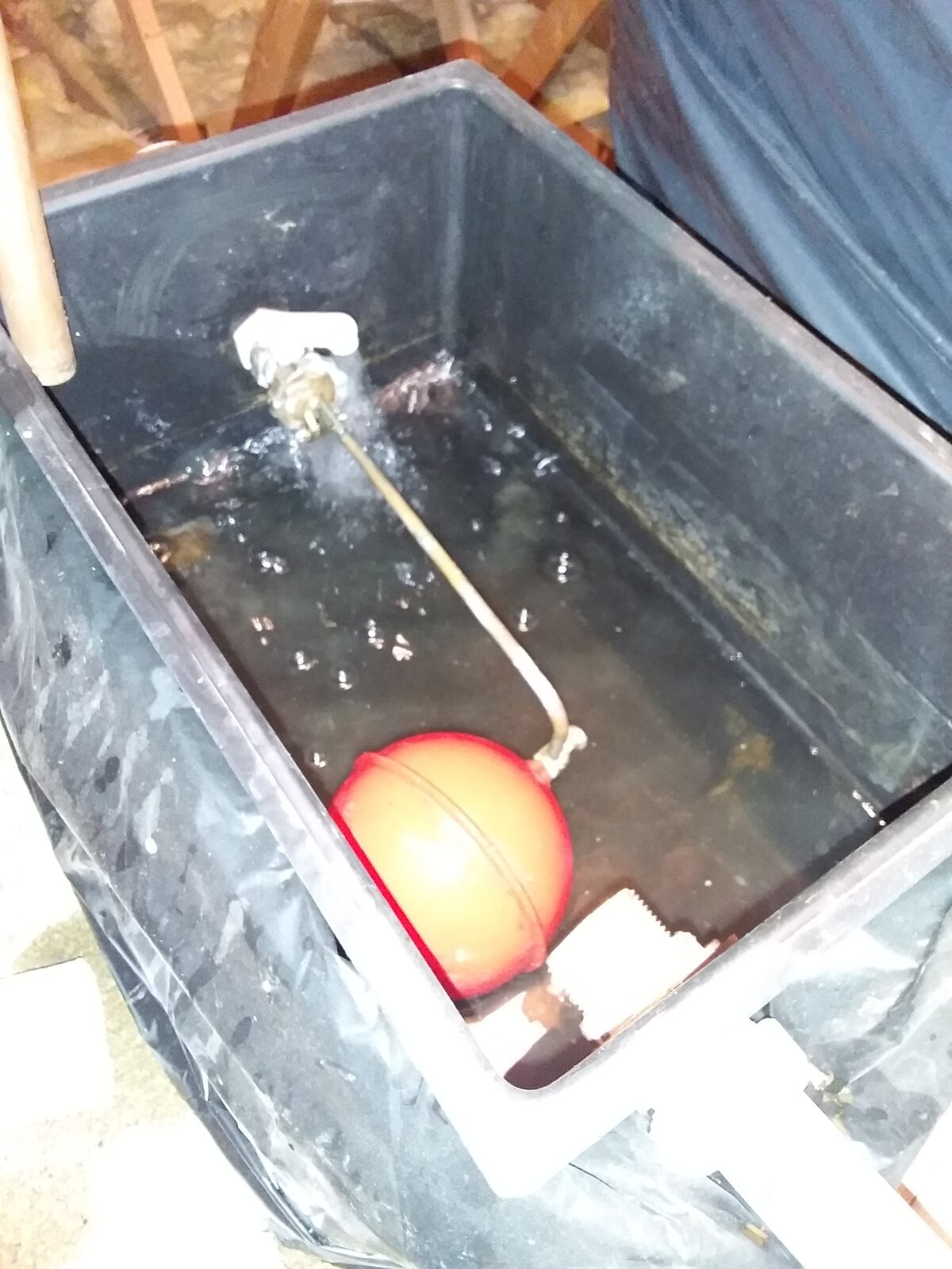

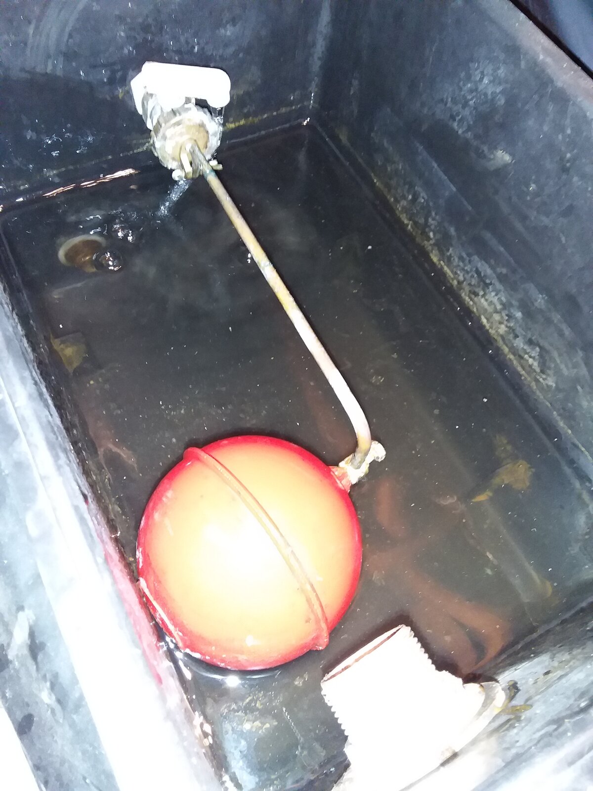

This uncovered water trough, I took some photos.
Any comments?
Presumerably it's redundant...your heating/hot water wouldn't last too long with no water in there.
Post pics of the boiler/hot water cylinder to confirm.
Indeed, teach me to look at the pic on the phone :)

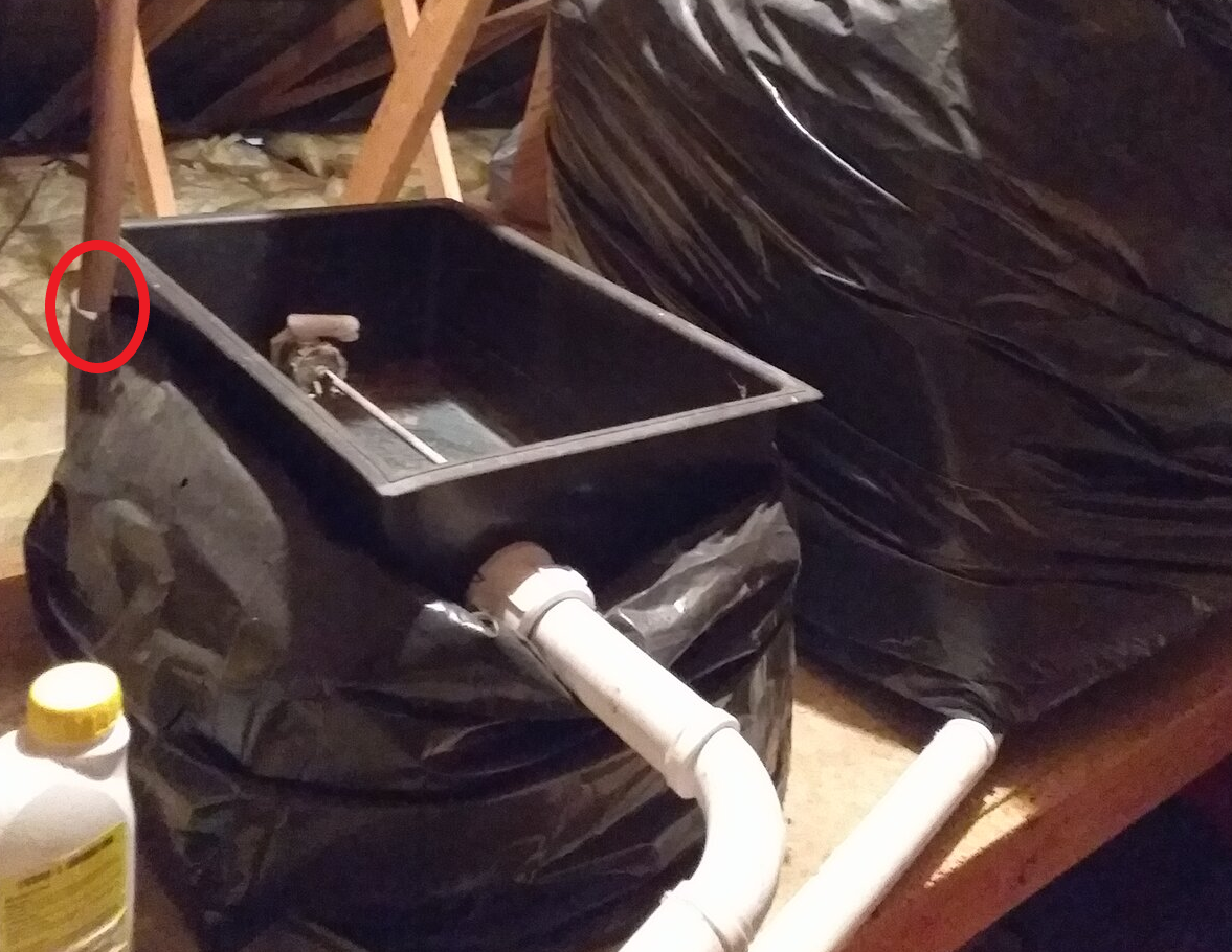

Float arm looks horizontal with a nice biofilm on the water, bit of timber needed to support the safety vent pipe over the cistern.
It's about half full, the water around 12-15 cm in depth.

The copper vent pipe above and to the side should go in to the cistern.

It's the 'Feed and expansion' cistern, (in Plumbing terms a 'tank' is a sealed vessel, whereas a 'cistern' has a removeable lid and operates at atmospheric pressure.) Supplies your hot water/central heating system with water as required, (under normal operation system should remain full and circulate the same water unless there's a leak anywhere).
Ideally needs a lid fitting, and some insulation over the top to provide frost protection.
Looks to me that the ( large white) overflow pipe is higher - @ it's bottom edge - than the float valve at the opposite end of the cistern . That is incorrect as the water with it's biofilm could be sucked back into the mains water supply . Measurement from the top edge of the cistern needed. _could be an optical illusion.

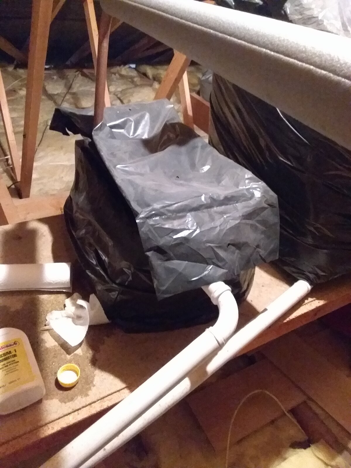

Maybe the lid is around somewhere as it could have been removed to add chemical to the system.... there's a plastic container to the left which could have held them?
I checked, the bottom (underside) of the overflow pipe is 1.3 cm lower than the water inlet. Both distances were measured from the bottom of the cistern tank.
Yeah it was, I found it.

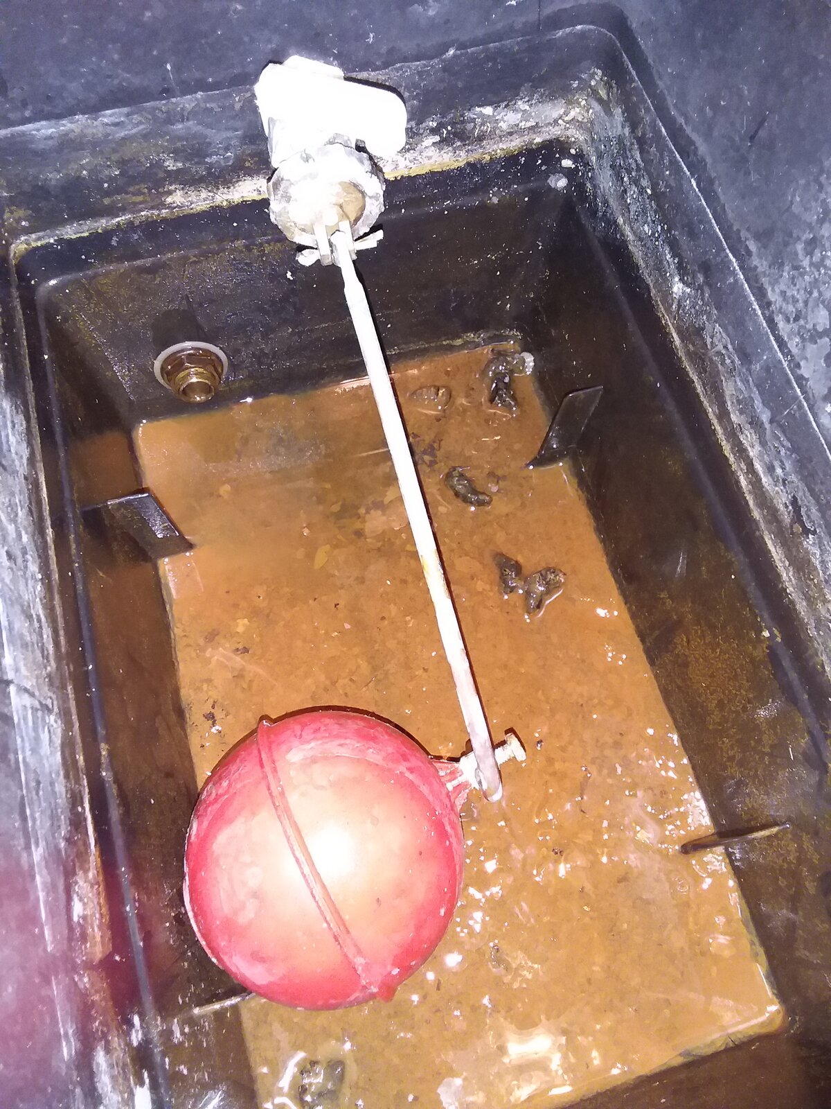

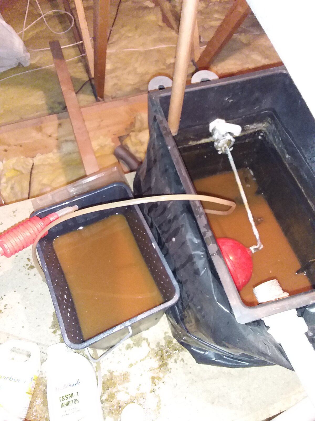

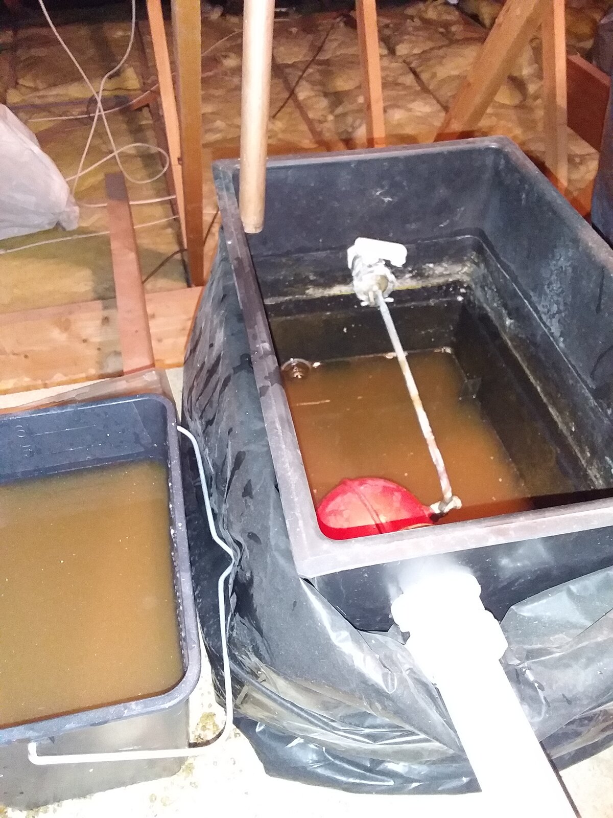

I extracted the muggy water first of all by using a container:
Then I had to use a handpump for the rest:

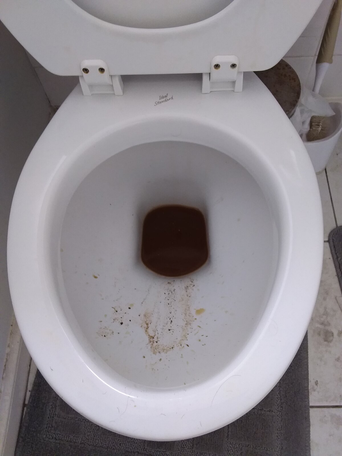

It wasn't nice the colour of the toilet water:
This is what was left:

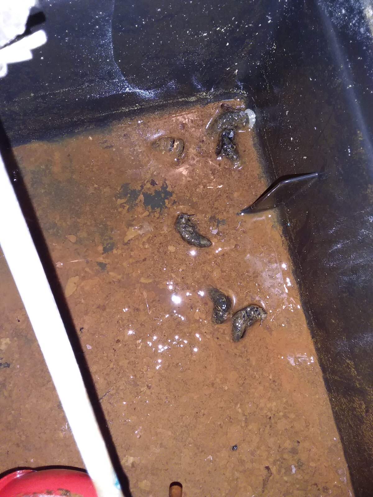

I appear to have had some residents;

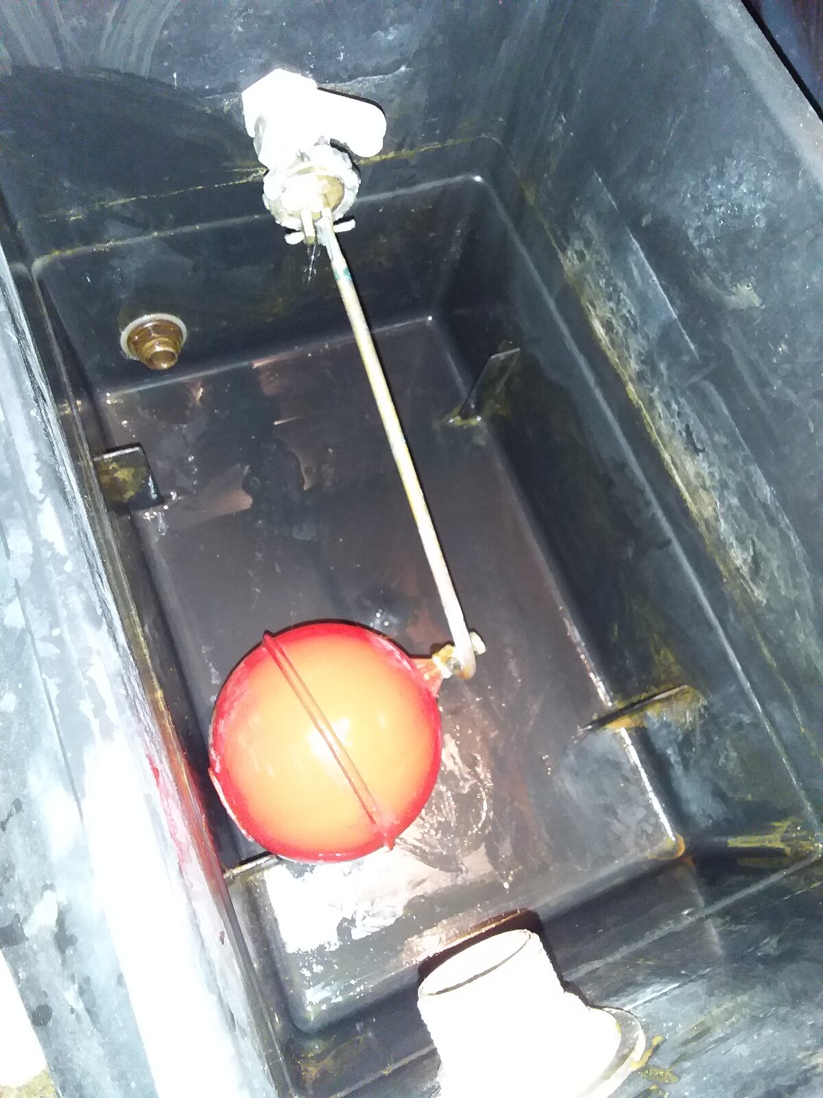

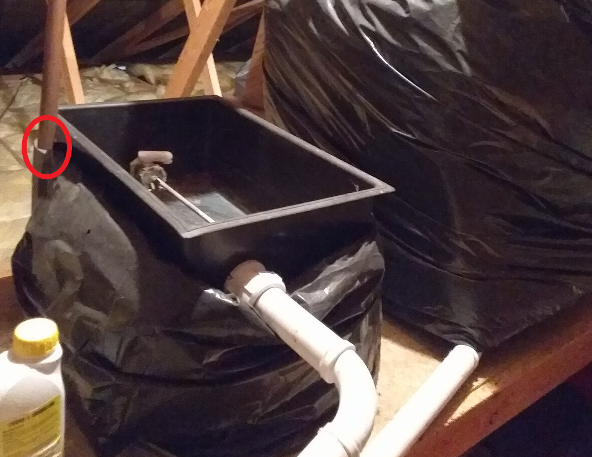

Gave it a good clean:
Then open the water inlet valve:
Nearly there:

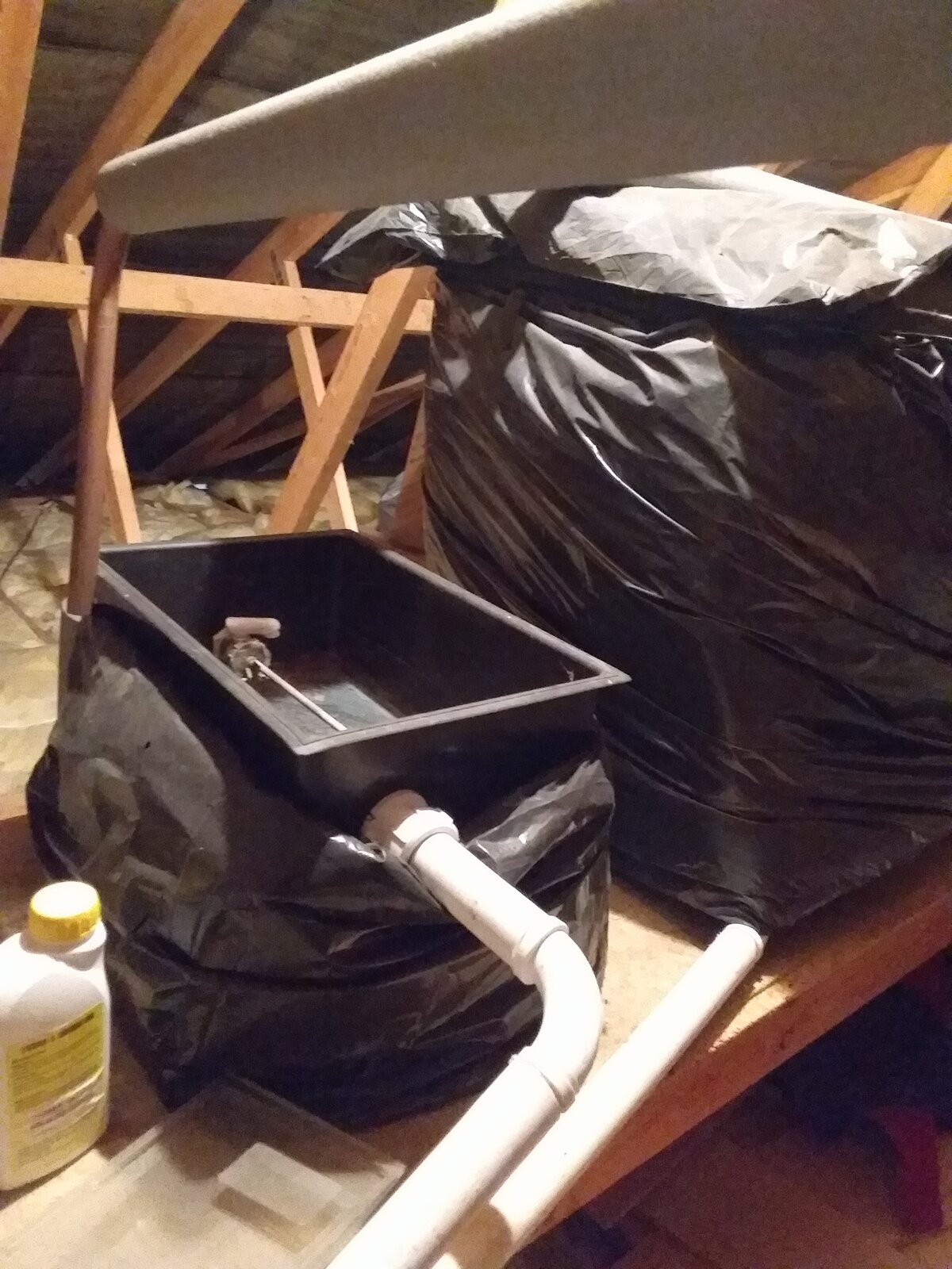

Finally, the insulated cover:
Job done!
