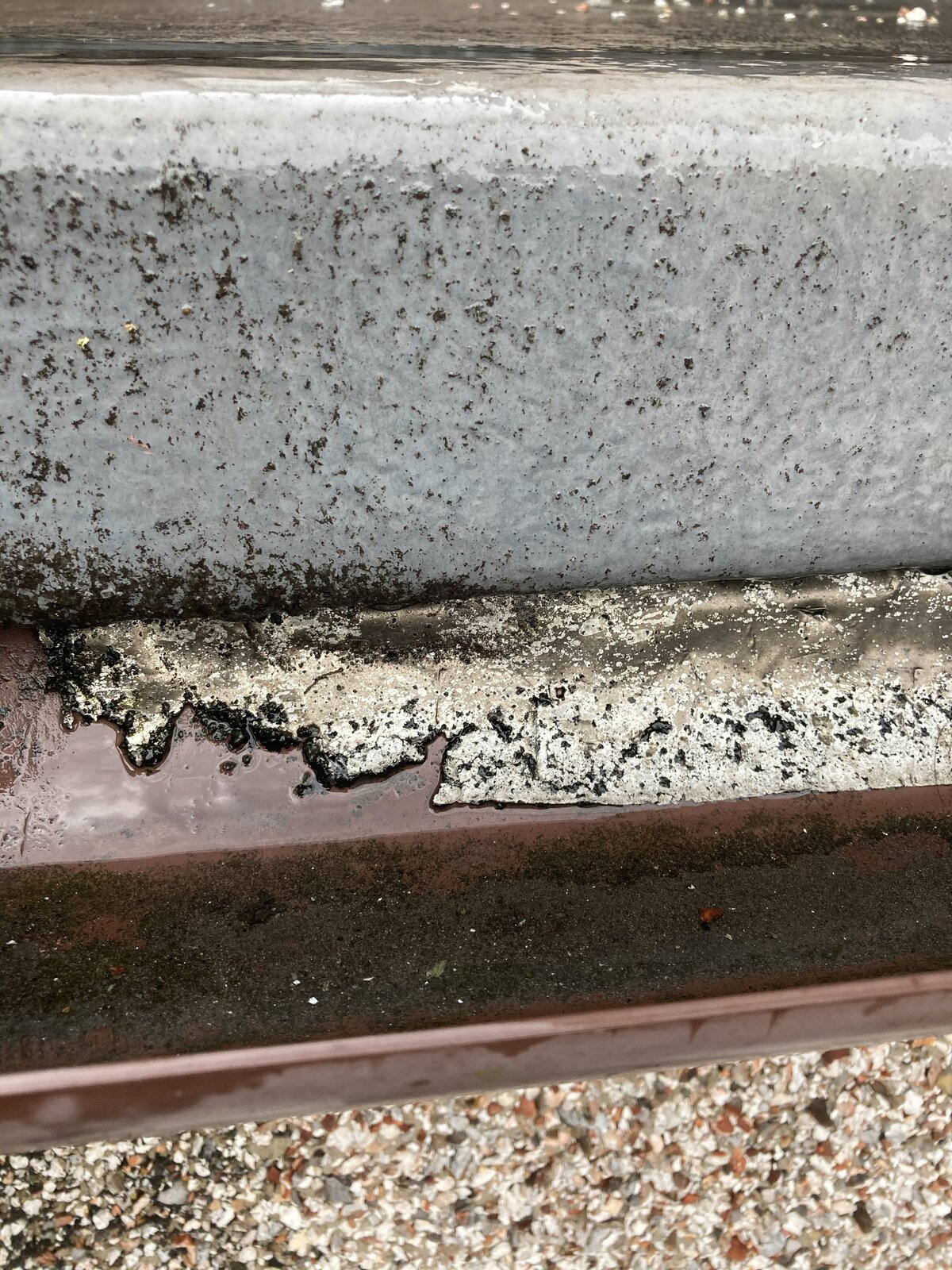

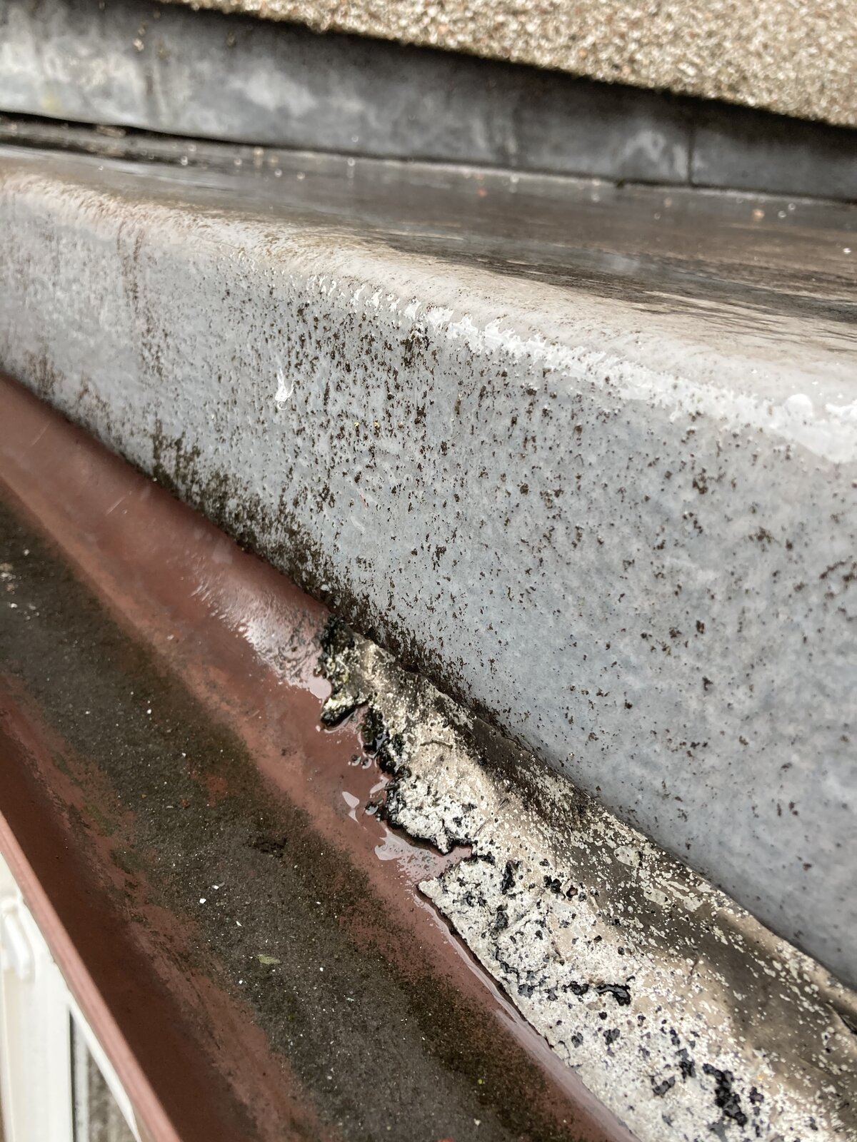

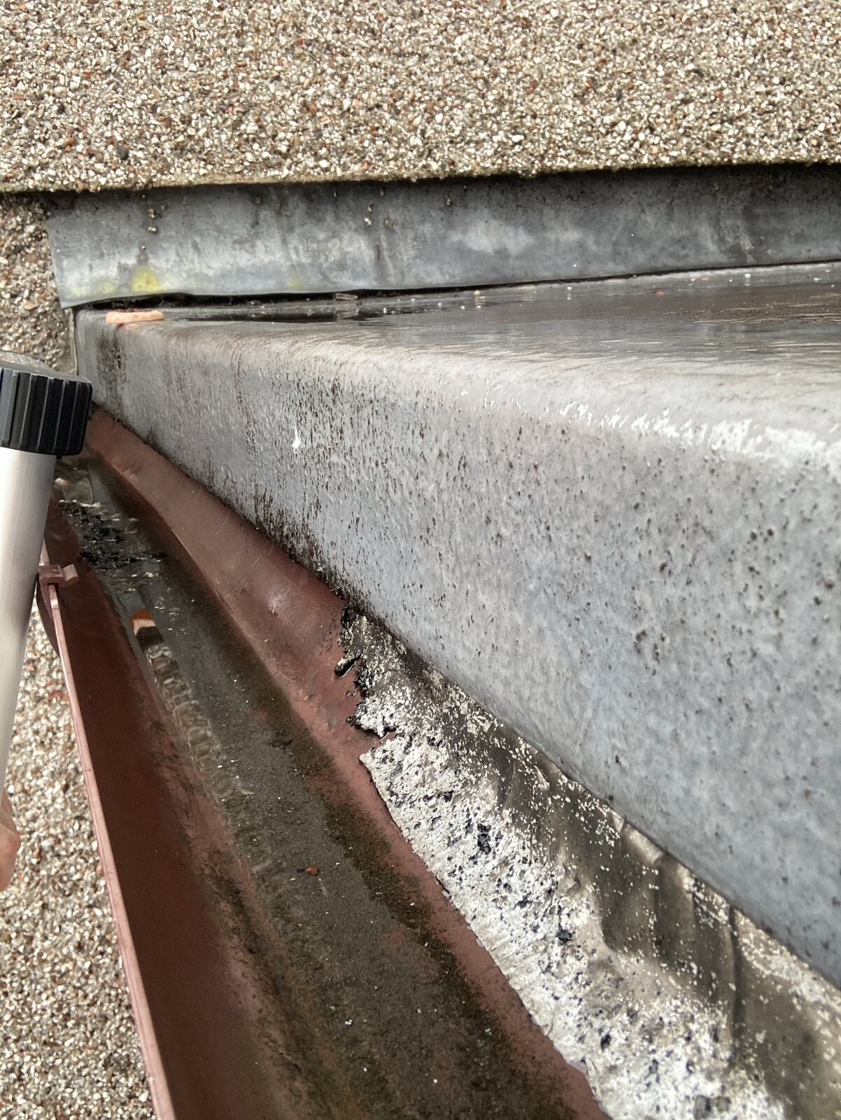

Hello all,
Issue with flat roof drain water leaking behind guttering.
As you can see from the photos some type of flashing tape has perished/come away half way along the guttering.
What’s the best way to fix this? Access is pretty good just not sure what materials methods I need to use.
many thanks in advance

Yes it should be ok. Lengths no more than 1m, min 100mm lap.
Alter it when the roof cover is replaced, to form a proper drip/overhang
