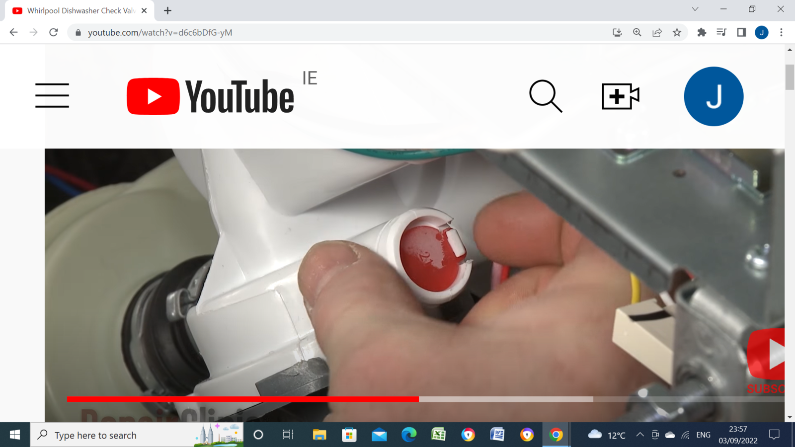

I have a 7 year old Whirlpool D.washer and recently had to remove the drain hose to clean it out. There is a non return valve in the form of a rubber flap just where the hose attaches to the machine, hose clip keeps hose in place, had to turn machine on its side to remove.
Google your machine model and the NRV might look something like this (Whirlpool).
