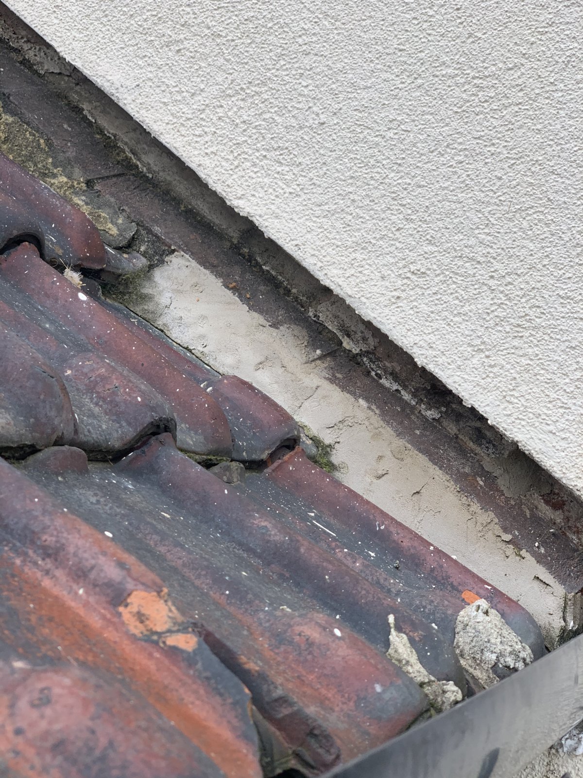

Looks like there is no flashing , just tile slips bedded against the wall..
This makes it more tricky . It maybe possible to slide a lead soaker under the tiles to steer the rain into the gutter ( said maybe)
Failing that you might need to get more destructive and pull off the lower slips and fabricate a flashing from under a tile higher up, dressed into the gutter.
Then bed the slips back
And make sure the stop end is leak free

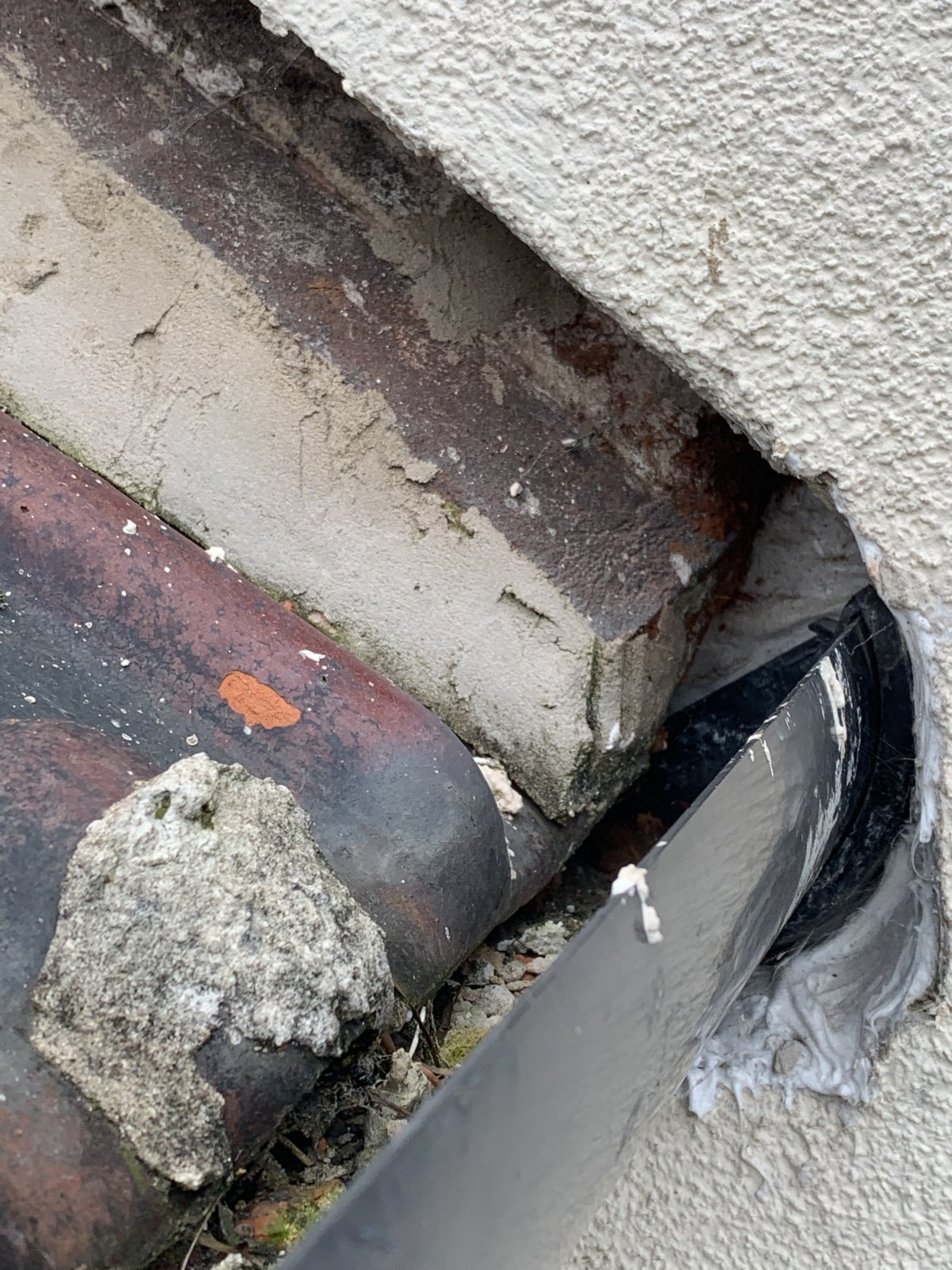

I've got some more detailed photos.

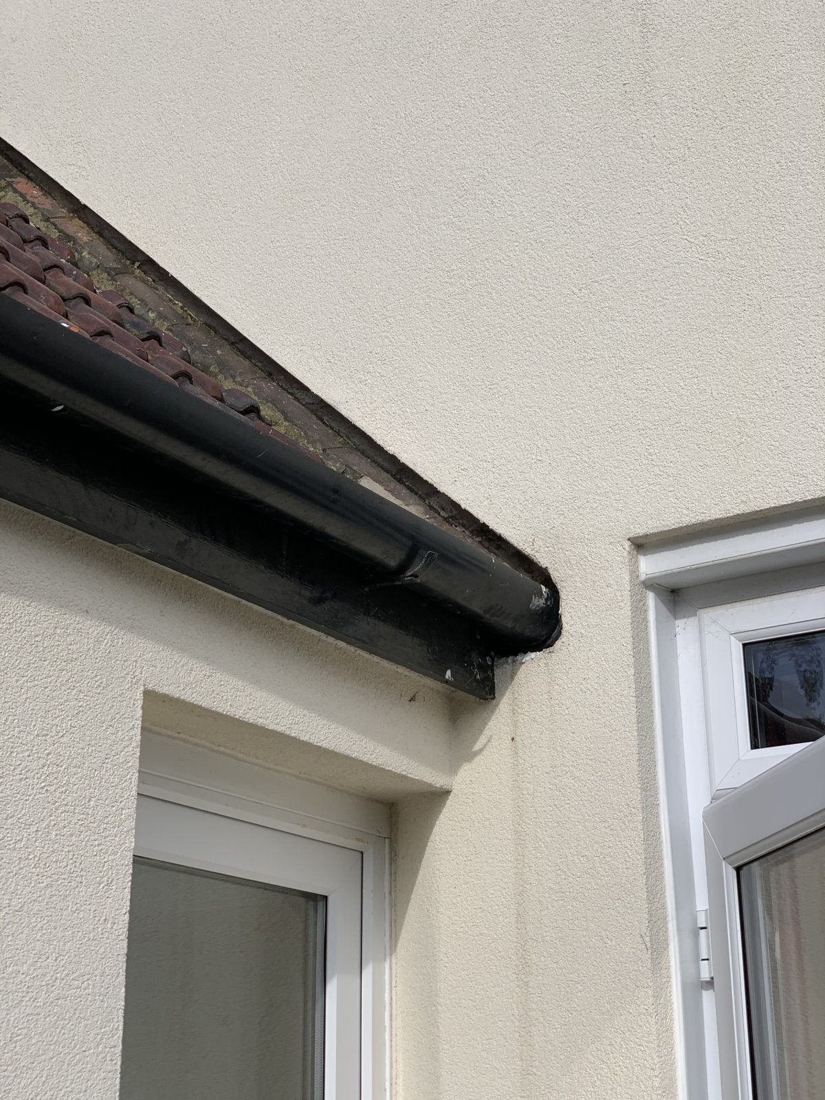

I originally described this as an extension because it looks like one but actually the houses were all built like this so I can see several neighbours for reference.
The guttering seems too close to the bottom of the tile which is distorting it and the end and part of the reason the water is getting past. I think this is because the run to the downpipe is quite long so starts high to get the right fall and can see it is the same on both of my neighbours.

the gutter is at an angle, surely water will just flow out the inside edge in a heavy downpour?

its thoughtlessness or something that the insulation has boxed you in at the verge:
but for the time being, at the least, your gutter needs removing, cleaning - including breaking all seals and cleaning or replacing them.
and fixed back so its dropping - to even shallow falls but its got to drop.
re-arrange the down pipe if needed to give a fall to the gutter.
dont cut the gutter short.
Post pics showing more of the roof - some of the lower tiles are wasted and/or not nibbed on their laths.
and pics showing the down pipe end.
the verge tiles and fillet arrangement needs replacing with lead flashing with a Kick-out Gutter Divertor to lead the water into the gutter.

Bottom tile looks like it has slipped down an inch or so and is now deforming the guttering.

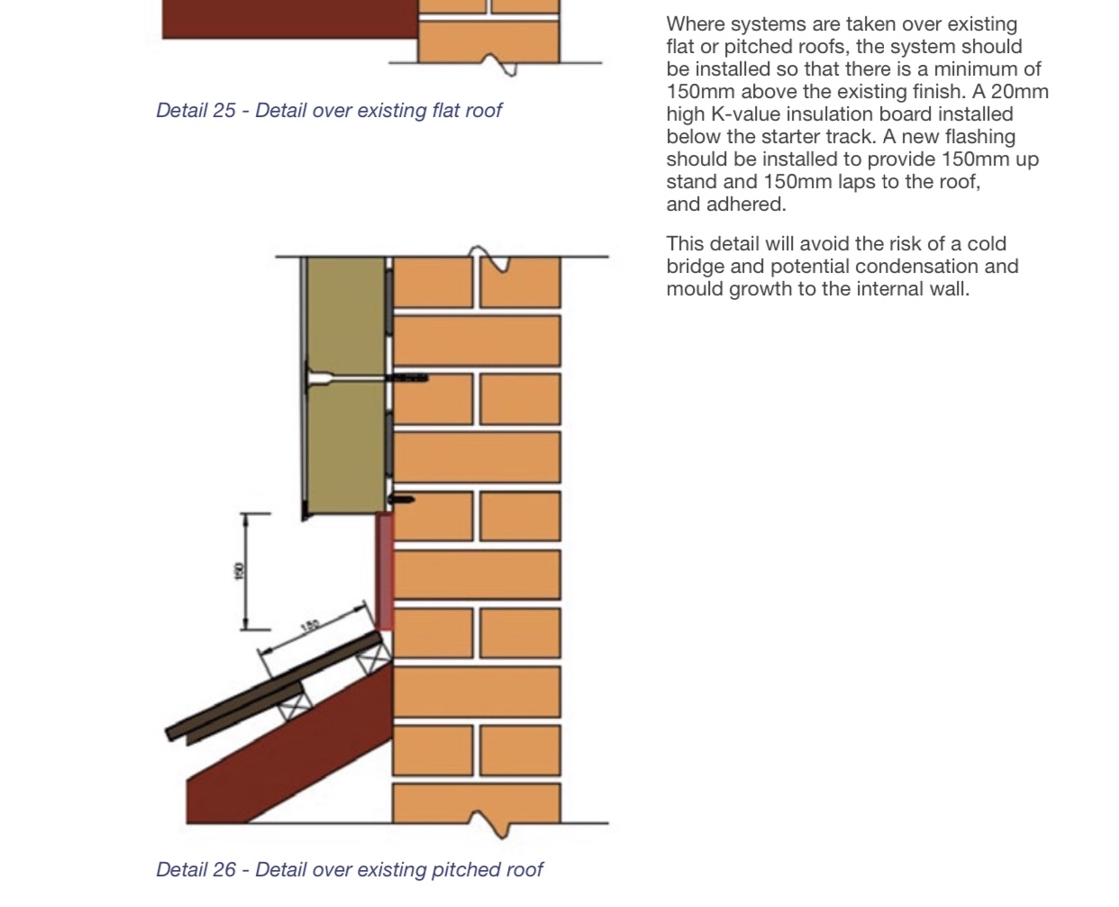

I managed to find a detail drawing of how this junction should look online.
They are supposed to have taken out the existing arrangement as filled the gap with a thinner insulation board and then installed flashing over the top.

take the gutter down and fit it properly , add a flashing as already mentioned
second tile back on first course looks damaged
