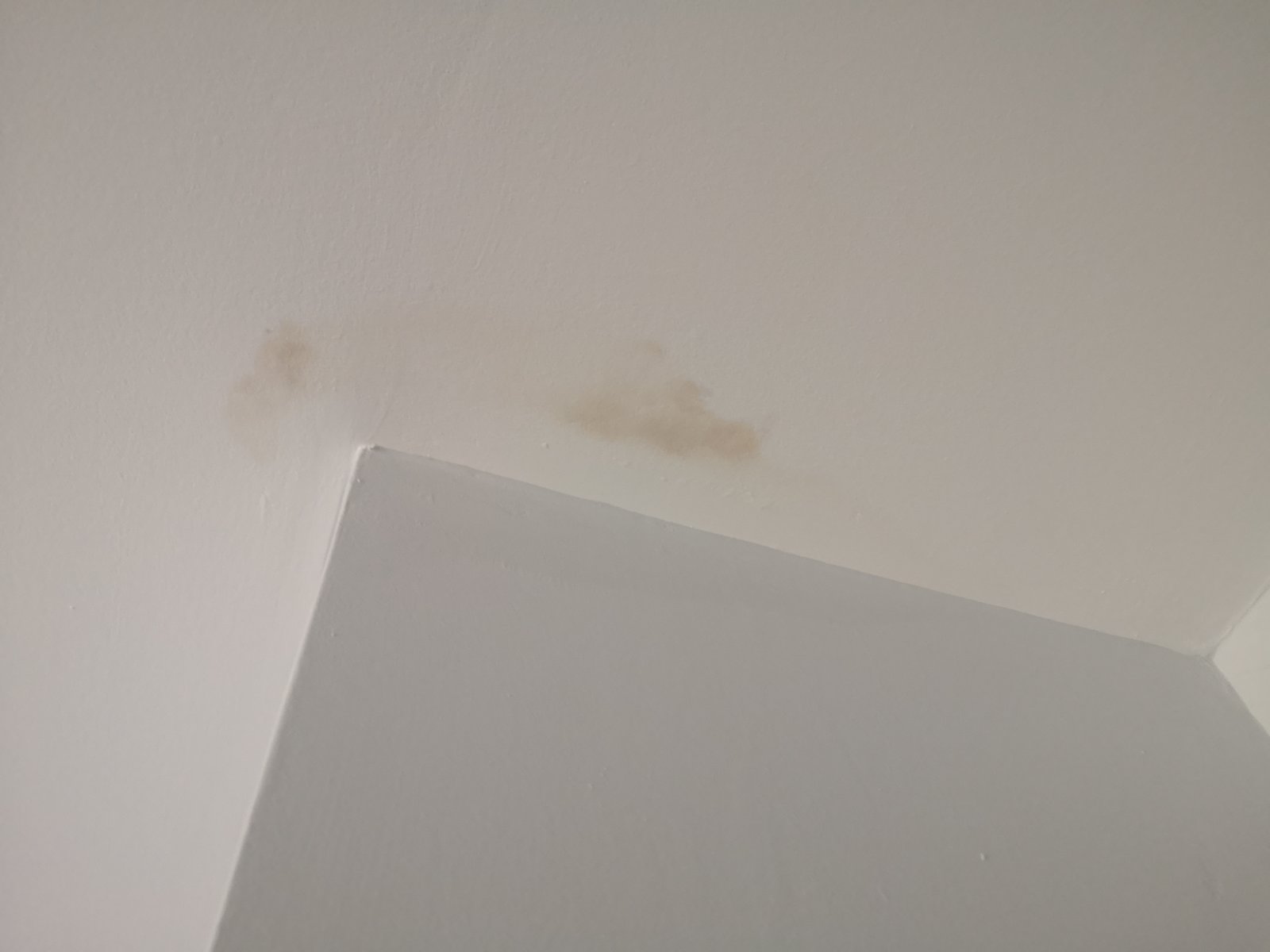

Hi,
I've recently refurbed a house, today I went by and noticed this water stain by the top of the chimney breast in the master bedroom.
I don't remember there been a stain before, so assuming it's not coming through the new paint. But possibly because of all the rain we had recently.
We had a combi boiler in too, so the tank above as far as I'm aware would be empty so wouldn't be cause by that.
Is this likely to be an easy fix? Or a serious issue?

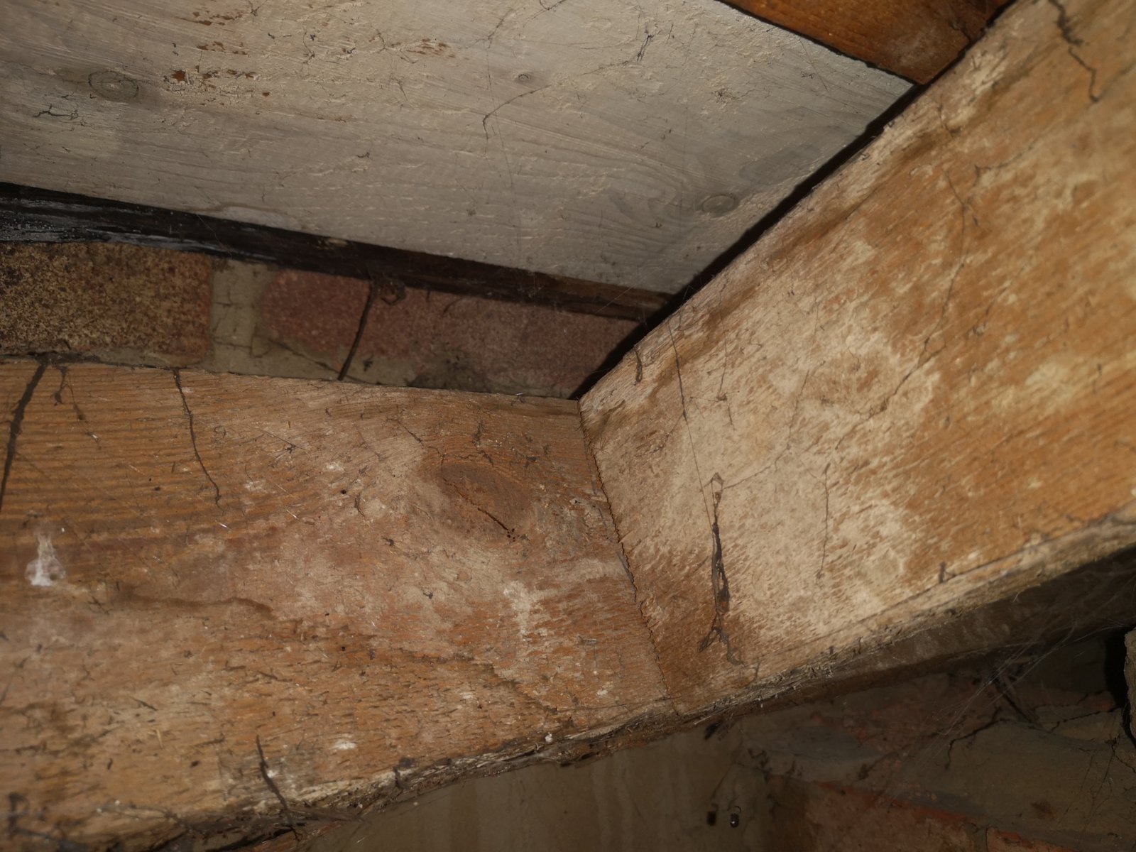

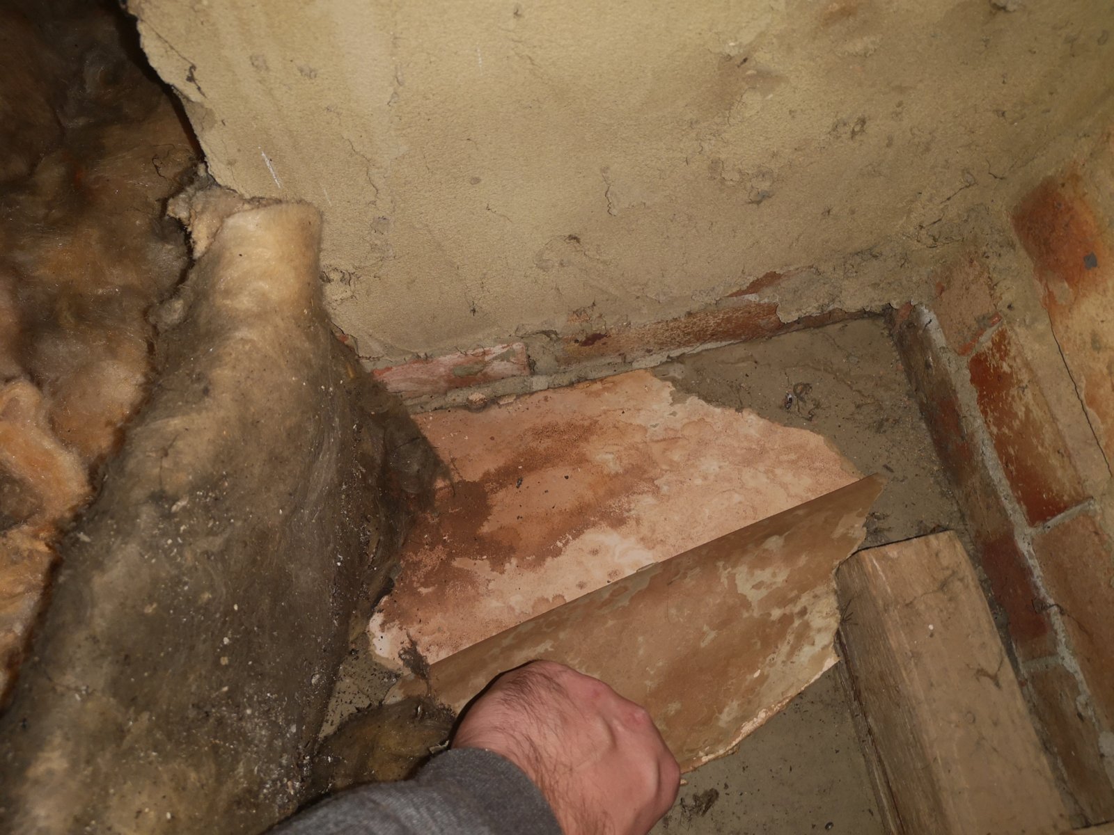

A case of getting up their and checking the pointing on the brickwork and the flaunching on the top of the stack. Also, have a check in the loft to look for leaks in the roof due to driving winds/rain.

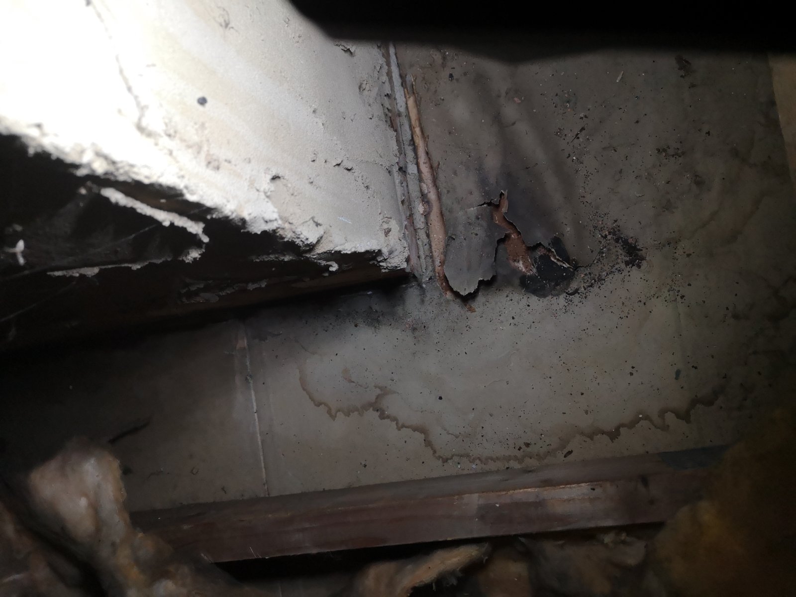

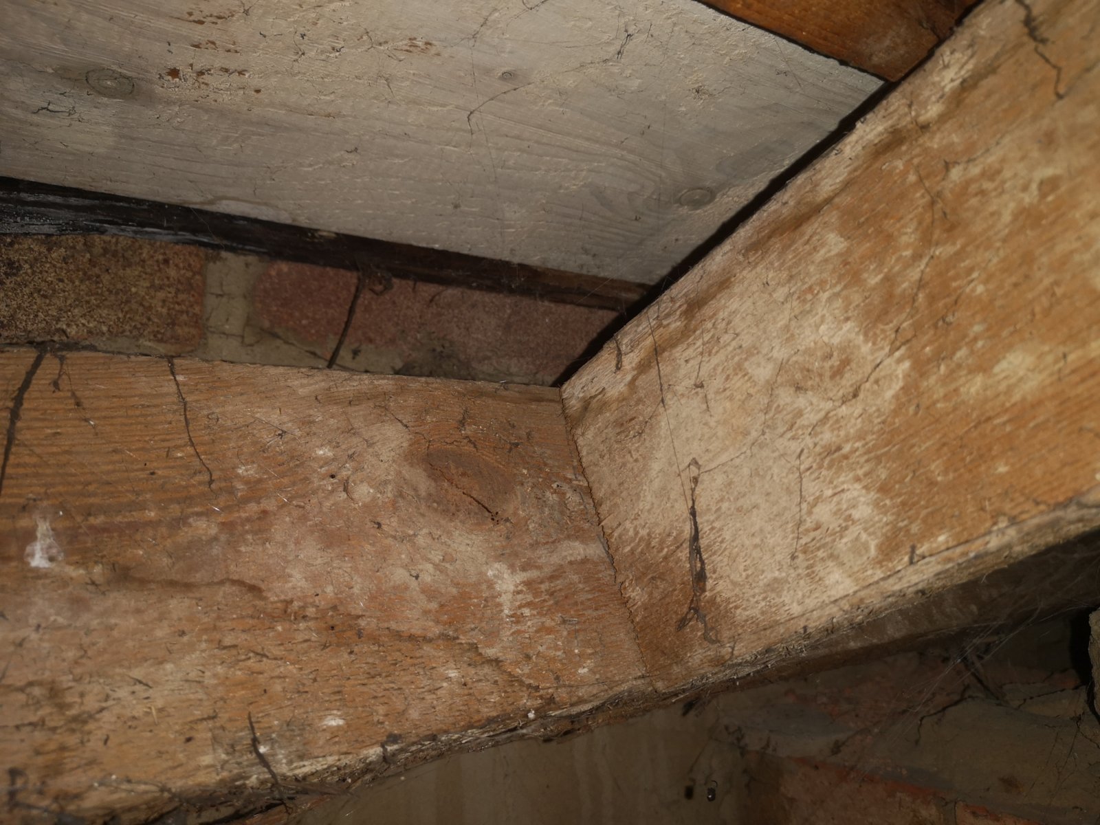

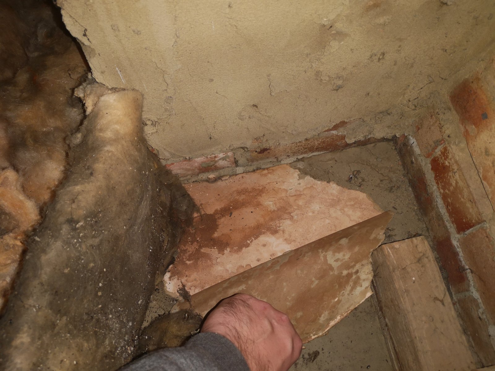

Thanks I went up in the loft today to have a look,
To the right hand side of the chimney breast there's a small gap where you can see abit of daylight so I am guessing that's likely the culprit
Also, there's the felt stuff everywhere apart from to the right had side of the chimney again where its just white wood, no felt so wondered if this could be part of the problem too.
It's definitely 5he right hand side thats the issues as I can see on the loft floor where it's abit brittle and water stains
Question is, which tradesmen would I need, a roofer I assume? To check it out
