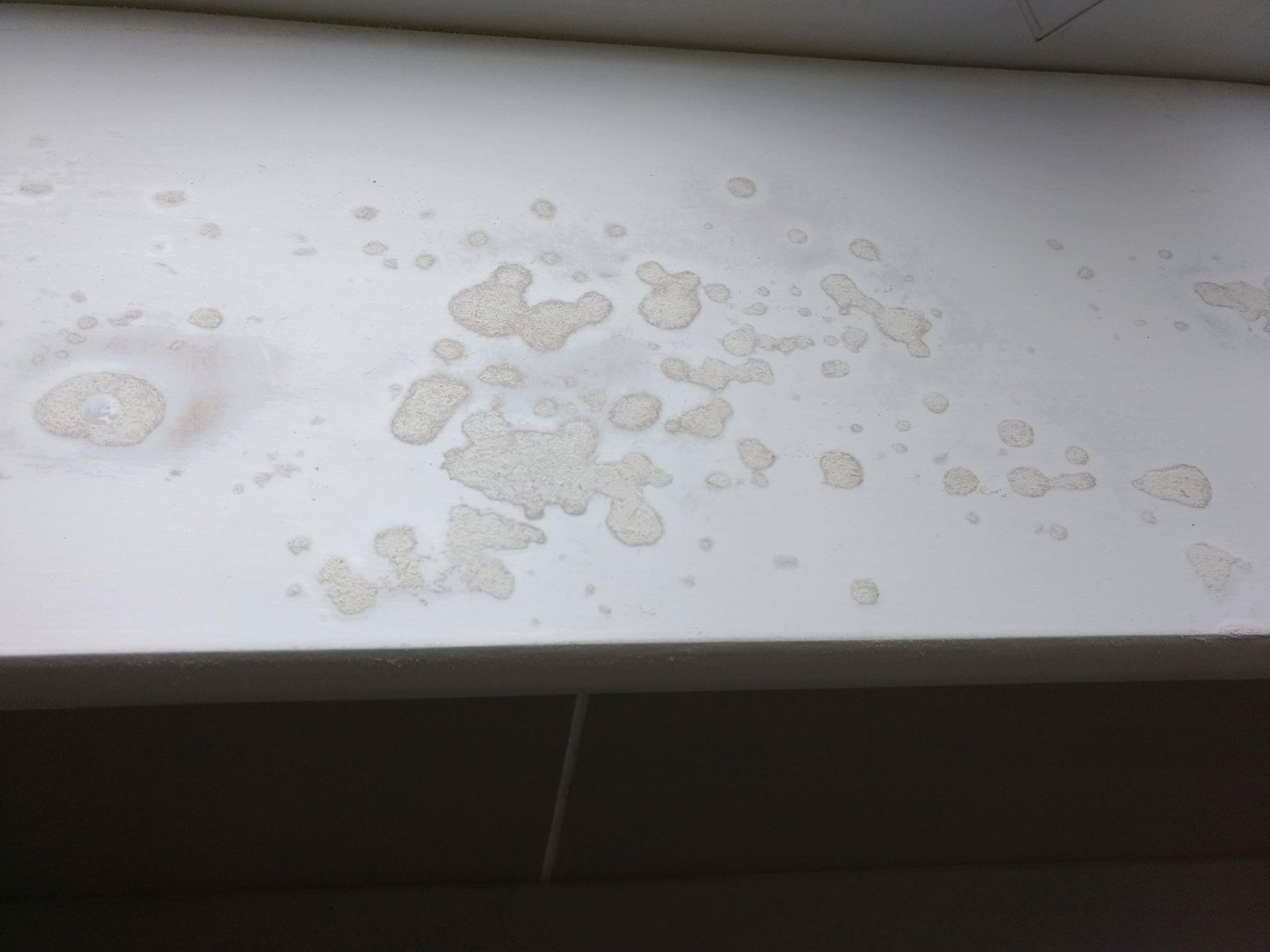

Hi,
We have a water damaged windowsill in the bathroom (internal).
The paint was bubbling in places so I have scraped and sanded down.
I'm not sure what exact material the windowsill is but having sanded down the water damaged area, the wood, although dry feels soft/flaky.
My question is, do I need to apply anything to exposed area of the windowsil before painting?
Aco
Looks like it could be an MDF sill. I would give it a coat of oil based undercoat to start with and flat back on top of that prior to putting anything else on it.
