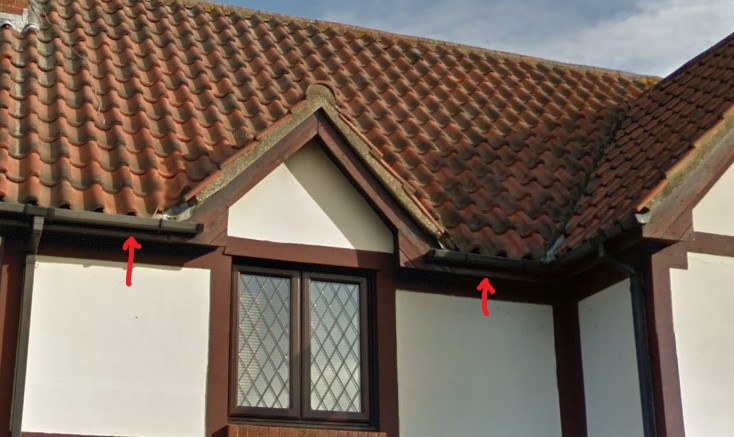

Hi Guys,
Moved in to a house 4 weeks ago, With all this rain I have noticed water dripping out of the soffit vent either side of the valley. Red arrows in the picture.
Roof inside loft is dry, but want to sort out where the water is getting in to the soffit to stop it rotting the joists.
Anyone got any ideas on where to start to look? Or a decent roofer in the Basildon, Essex area?

Are you sure it's not flowing down the back of the gutter down the fascia onto the soffit?
The arrows point to high flow from the valleys and tiles.

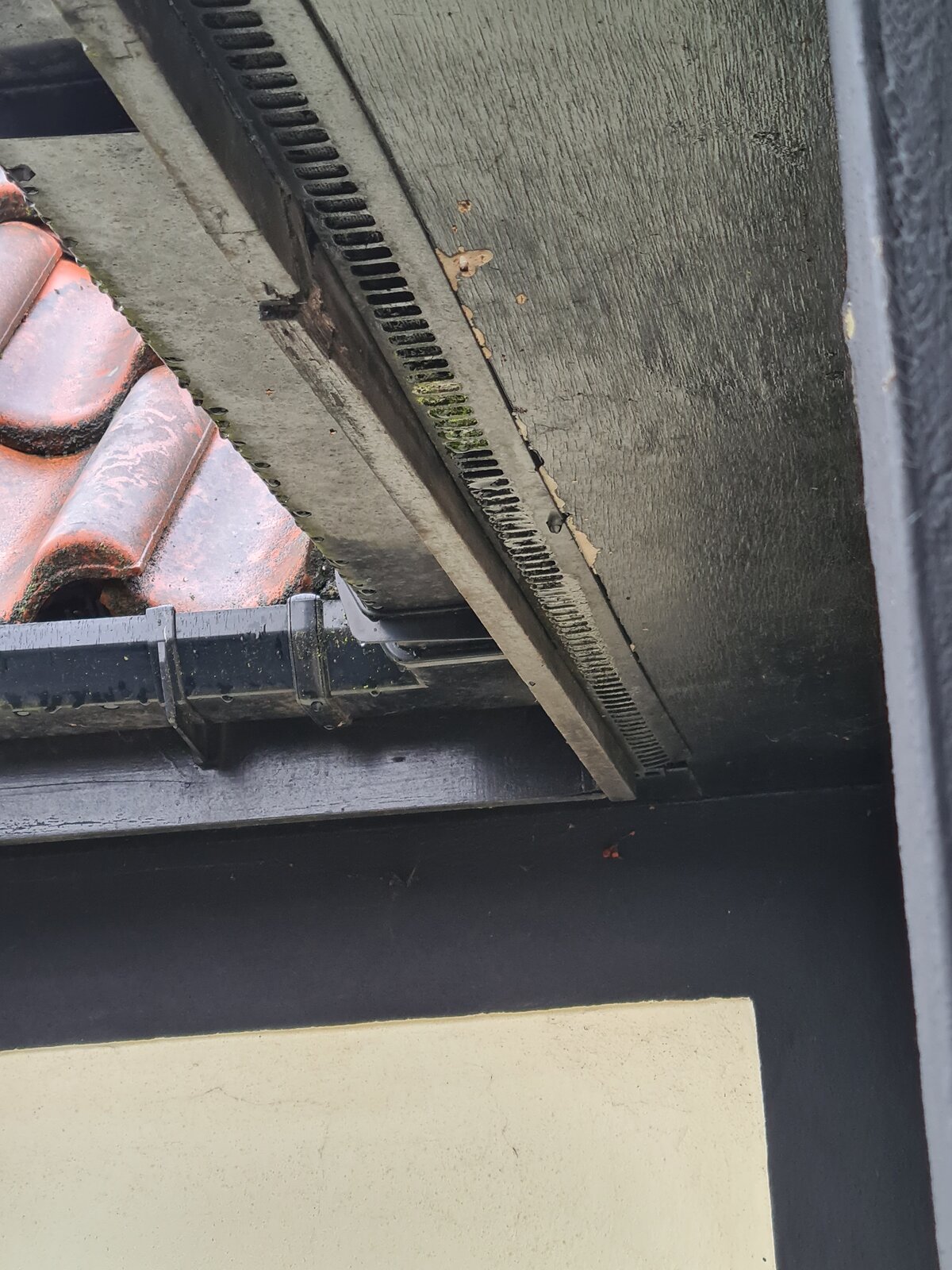

I'm fairly confident that it's getting in to behind the fascia as it's dripping from the soffit vents and not off the bottom of the fascia. You can actually see the water on the vent in this picture.

Rotten eaves felt
I did wonder that myself but shouldn't the roof be water tight with the felt being the last defence?
Or am i being unrealistic?
Only been here a few weeks but the plan is new soffits, fascias and guttering in a year or so.
Any felt that drapes into the gutter rots after a few years due to UV. There should be plastic eaves trays fitted into the gutter.
If this is the problem, water tracks back into the soffit instead of going in to the gutter
Ah so it's potentially being blown back up under the tile rather than coming down under the tiles.
Lead at bottom of valley not turned up on edges under the tiles

Ok eventually got a roofer around after the snow had cleared. He has said that the lead is quite thin and not very well supported behind the Facia. He has suggested as it is only a small domer to remove the tiles, put new thicker lead on and also more support near to the Facia board. To do both valleys he is quoting £900 inc VAT.
Does this sound like the right course of action of over the top to fix this? Many thanks
How does that explain the vegetation in the soffit vents and the paint blown from the soffit and back of fascia - both of which are typically water related?
