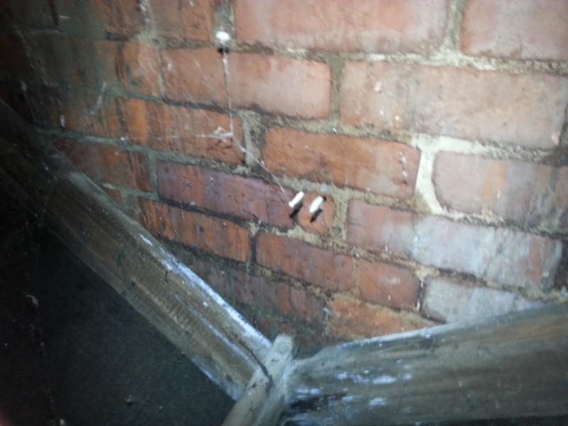

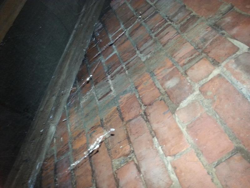

Hi
A damp patch has appeared on ceiling in bedroom and another damp patch seems to be getting bigger in the bedroom next door.
Photos attached I hope!
Had the flaunching re-done a few moths ago as it was badly broken and know that there is a golf ball sized hole in one of the pots but not sure if this is the reason the water suddenly seems to be getting in?
Been up in the loft and cannot see any drip and all tiles seem to be intact.
mortar between bricks on the stack in the loft was all damp and crumbling like sand- could it be the pointing and water seeping down through bricks and then dripping but thinking it would be more gradual, although we have had heavy rain yesterday?
Any ideas welcome?
Ta

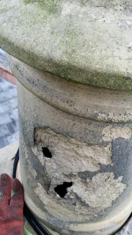

Why was a damaged pot left on the stack?

The rafters appear to be well discoloured but the pics are not in focus to tell if rot is present.
Thank you for that pic of the pot but i asked a number of other questions and requested further pics?
The pic of the pot is limited but, whatever, that pot is disintegrating and dangerous - it could crumble and crash down in a high wind.
The roofer said some flexible mastic or such could be used to fill the hole but he did not have any- he re-did the flaunching which should hold the pot in place I guess. He said that it was secure.

Anyone who called himself a roofer and left that pot, or made mickey mouse claims about repairing it, was no roofer.
If the pot crashes onto someones head you, the householder, will be held responsible.

The pot should have been removed or at the very least suggested by the roofer.

Thing is, to do a proper job on the flaunching - any flaunching - all pots and terminals must be removed to provide a clean surface to work with. Half measures wont work, they will come back to bite you.
Often when the flaunching and pots are removed its obvious that a couple of brick courses might also need renewing.
Typically stacks will be re-pointed, and all lead flashings investigated, especially the lead back gutter - we always lifted the back gutter and flashings to search for leaks.
But its impossible to say what condition your stack is in, hence where the leak(s) is coming from, without pics. I can only point you to possibilities.
If another roofer appears have the roofer provide pics of whats what and post the pics on here. After any work have more pics taken to show what has been done.
