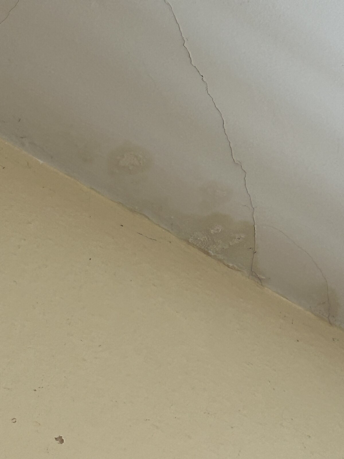

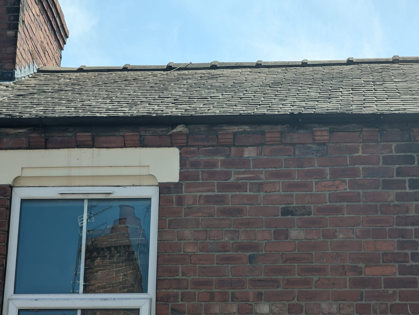

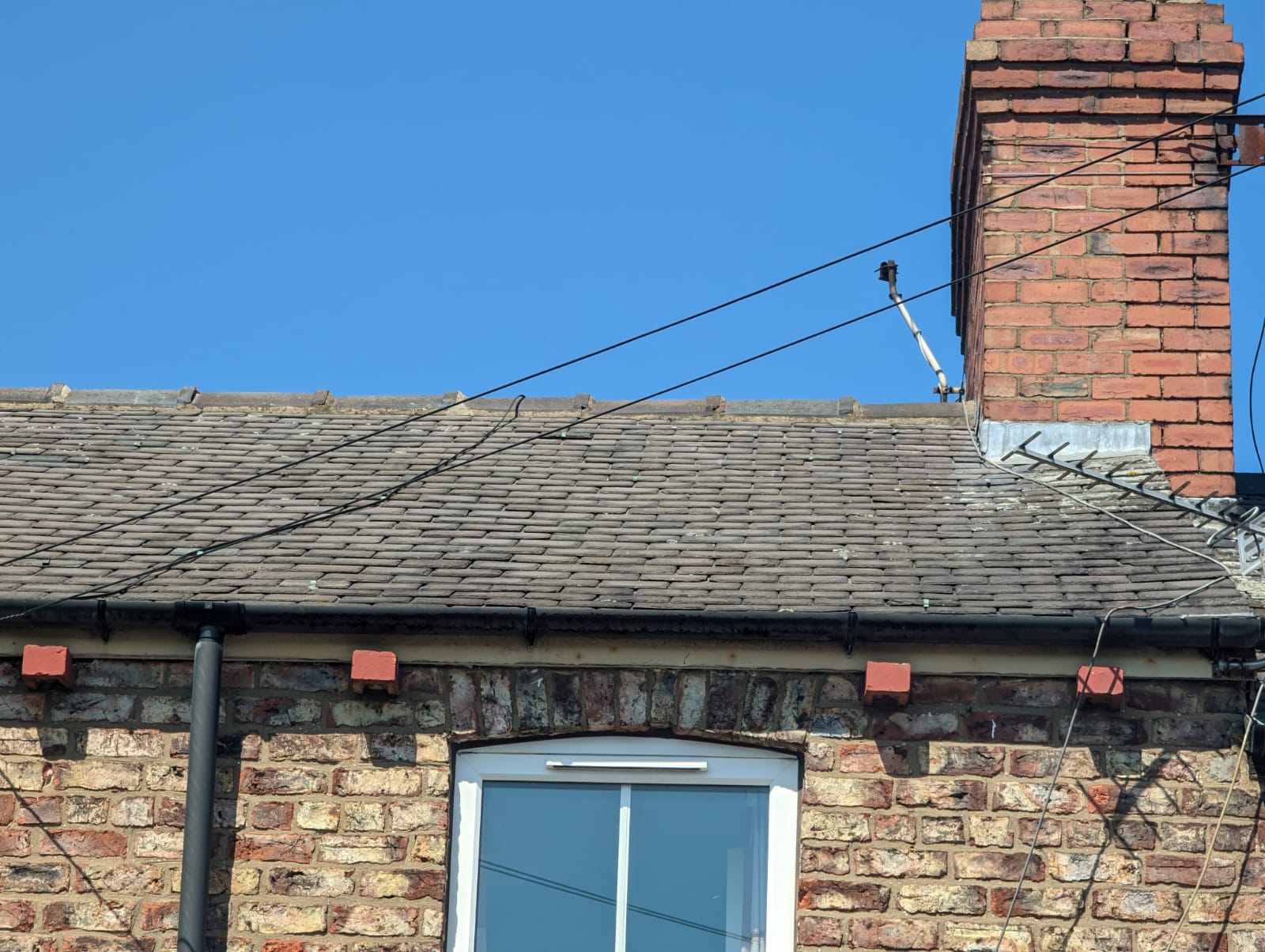

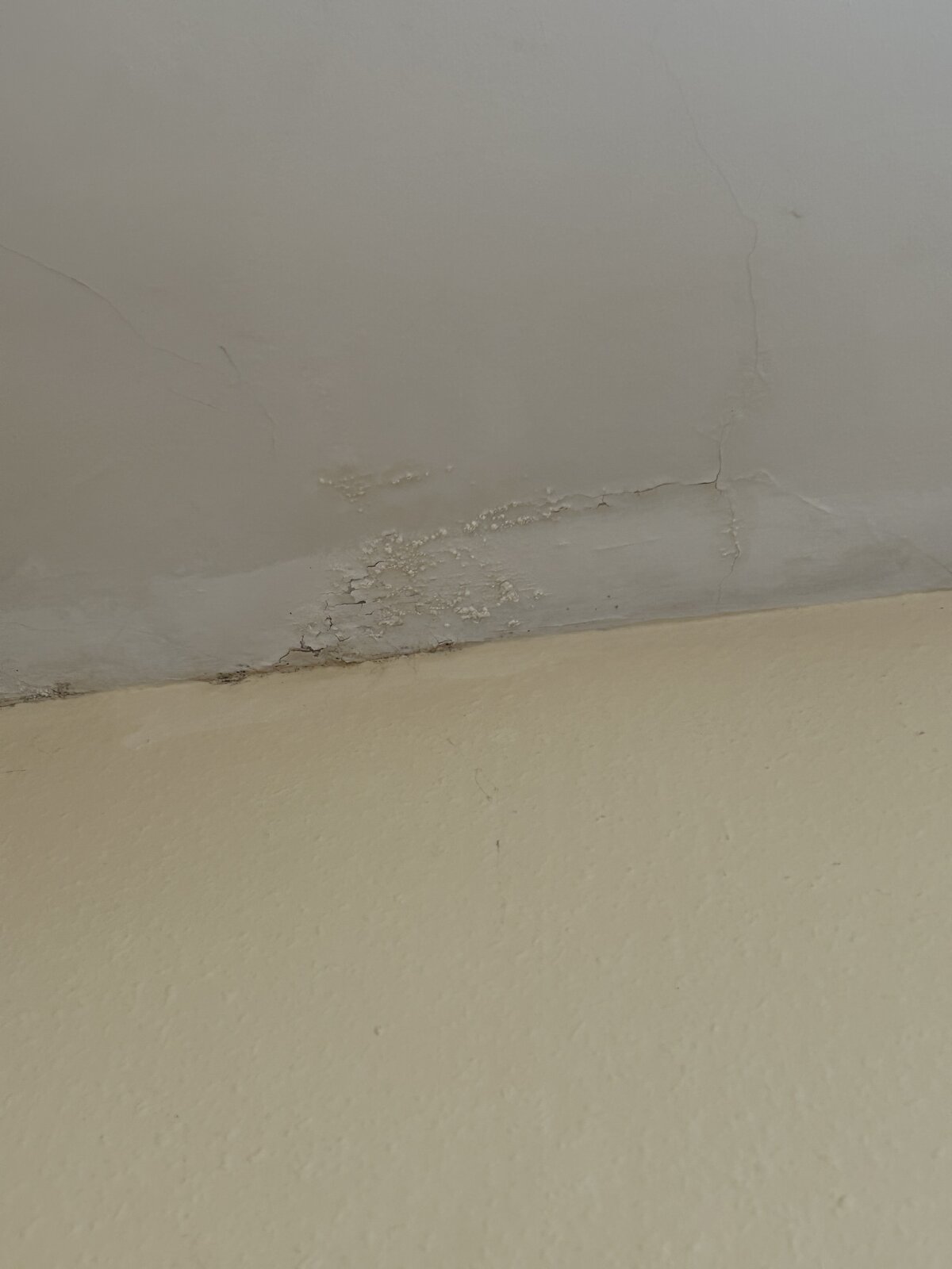

Hi all - just wanting some advice. Recently bought a home 2 weeks ago and the survey didn’t pick up on any roofing issues. We had a few days of rain and noticed the front room had some wet patches/peeling paint on the ceiling, roughly behind where the guttering runs outside. The only issue the survey picked up was some re pointing was needed.
Had a few quotes and all but one recommended installing an EPS. I am confused as the roof is original so no felt underlay, but i thought the purpose of the EPS was to go over the felt?
1/6 quotes said replace the whole roof due to age, and 5/6 said EPS as they believe the roof is generally in good condition. The most recent said they’d install an EPS front and on the back (theres water marks in back bedroom suggestion a leak there at some point), re-doing the pointing and removing/cleaning the gutter. Quote below:
“to take off guttering and install eps eave protection system to front and rear of property, clean guttering , re fix loose slate”
“Sorry forgot to put in quote that includes cement work on ridges thanks heath”
The others quotes roughly between 400-600 just for doing one EPS in the front.
My question is will the EPS be of any use if we have no felt due to it being an original roof (house is circa 1900) and is £750 a little too good given the others all suggested close to that for just one of the jobs? The most ambitious quote had 100% feedback online out of 70 reviews.
Any other thoughts welcome. Unfortunately we cannot afford a whole roof replacement, or this repair work, but it is useful to know estimates. Sadly we didn’t account for this when we bought the house as we hoped the surveyor would have done a better job since we got a RICS level 3 survey.
