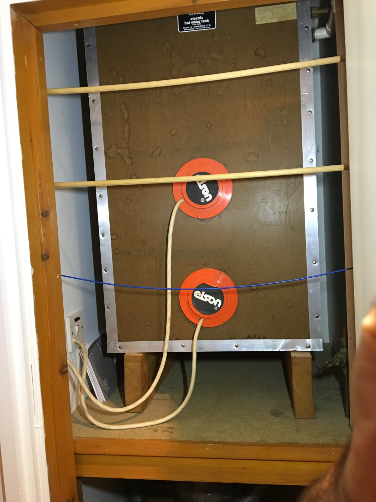

I've just bought a house and it has a hot water tank (Elson Opal) and a power shower.
For some reason when showering, after a certain amount of time, the hot water just stops and the shower can't run. It's not that there's just cold water, there's almost no water coming out at all. The showers starts revving up, but the water barely drips out.
Same thing happens to other taps.
Tonight, I hadn't used the hot water at all, but there's still nothing coming out. The bathroom hot water tap and bath hot water tap have hot water, but not the shower, nor the kitchen mixer tap.

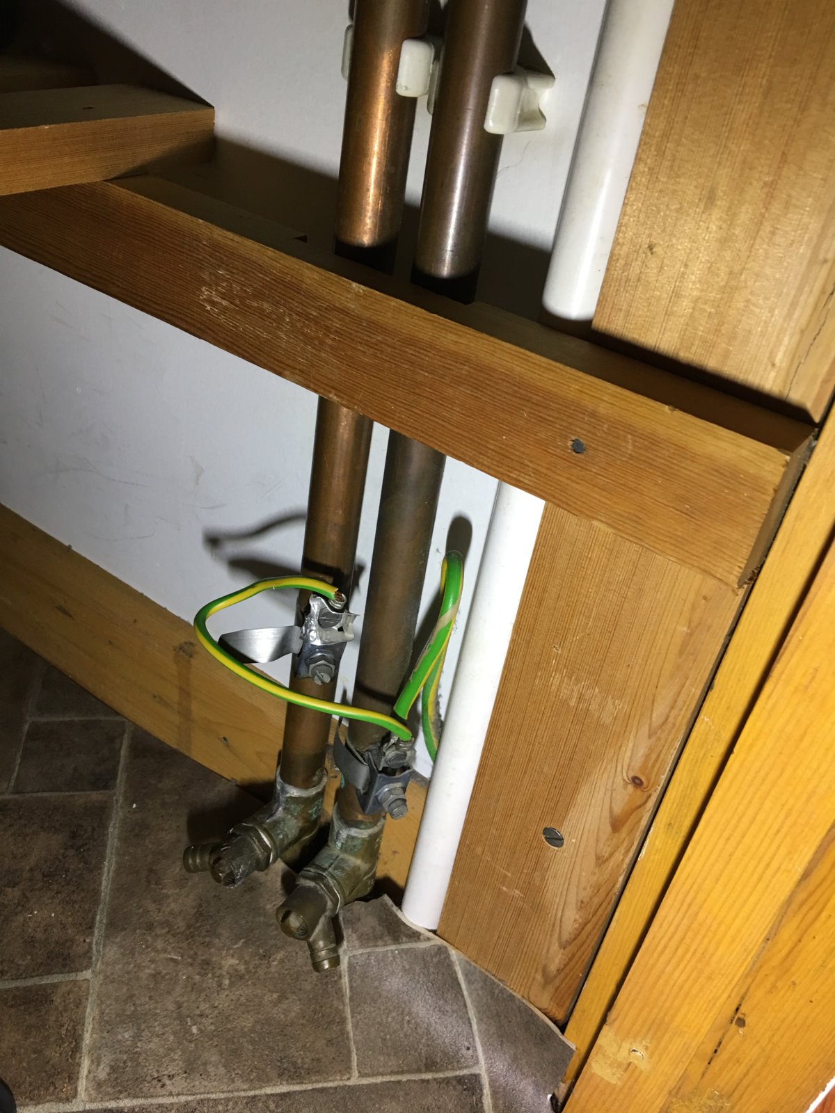

I think it may be a problem with the motorised valves (if that's what those even are - pictures attached).
I believe the boiler should run on Economy 7, but I can't see any timers other than two power cords coming from wall sockets one of which has a "7" and the other a "W" written on them with a pen.
Any help with diagnosing the problem will be most welcomed.

Your first pic is two drain cocks ,not motorised valves ,by the way.

You have two electric immersion heaters. The lower one heats the whole tank and usually fed from a low tariff like economy 7. During the night. The higher one heats less volume of water in the upper reaches ,and is connected to your " normal " electric supply 24 hours. If you have a gas central heating boiler ,it may also heat this tank,more economically than the immersion heaters.
