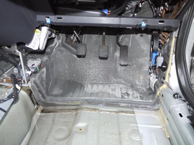

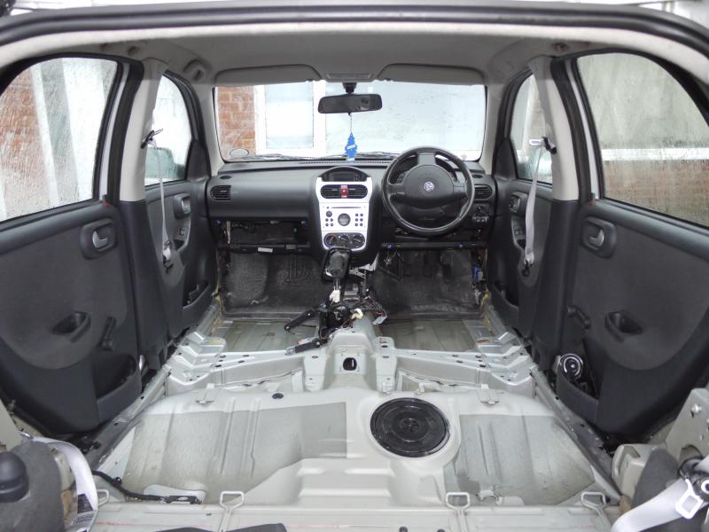

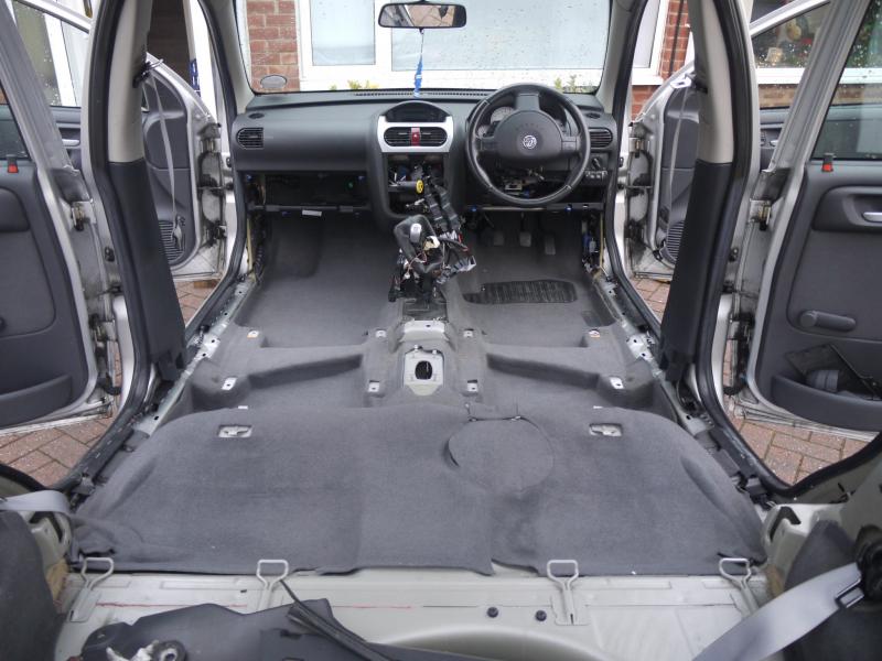

I've recently taken charge of my mother-in-law's Corsa C, which seems to be suffering similar problems to those already described by many others.

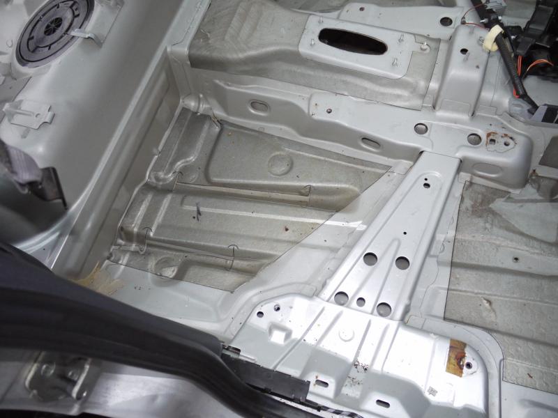

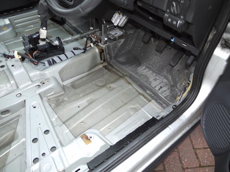

The symptom was an obviously wet rear carpet on the driver's side, so first task was to take everything out to confirm it.
Definite water at both the front and rear, front was hidden by more underlay and insulation.
Sound insulation consists of thick black rubber backed with foam. Hence you don't get wet carpet behind the pedals.

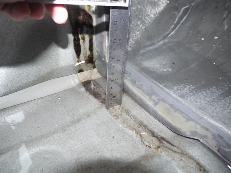

A couple of hours after mopping, I tried the front and rear footwells again, and the rear was dry, but the front had a new 1/2 inch of water.

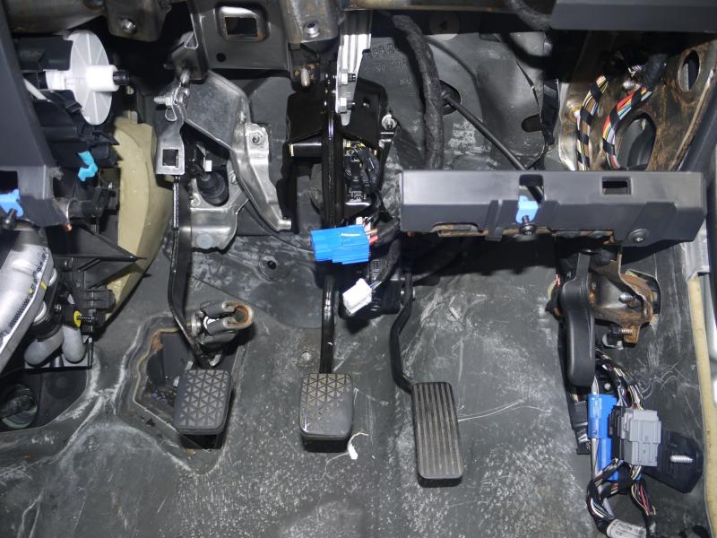

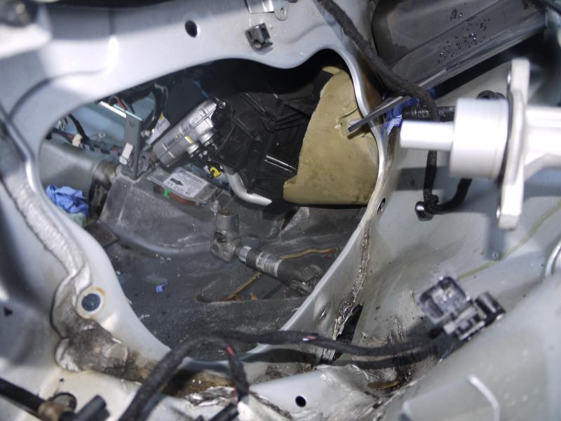

So, time to remove the pedals and steering column. Haynes is generally good at this, but the clutch pedal clip is a right PITA.

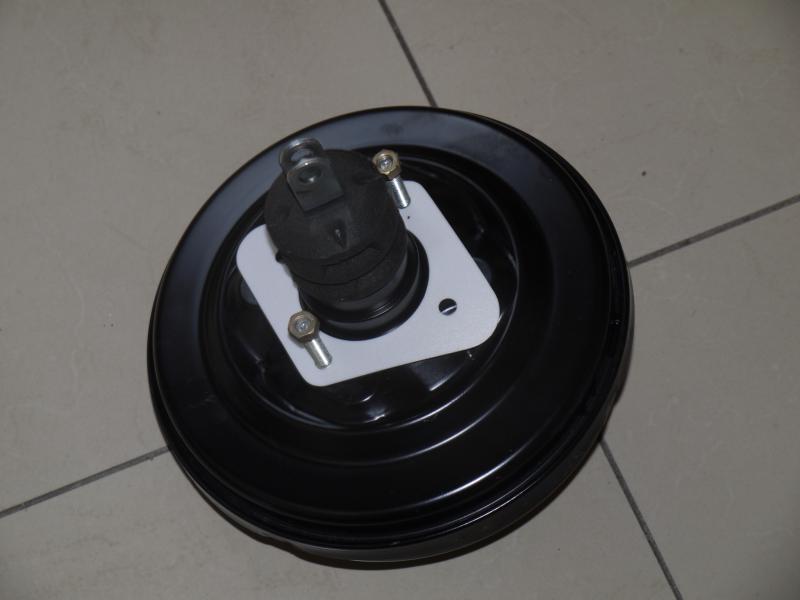

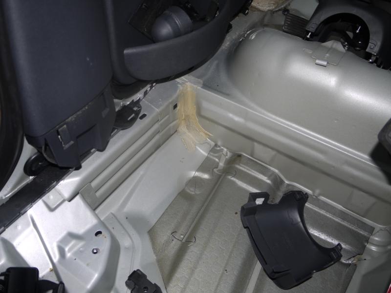

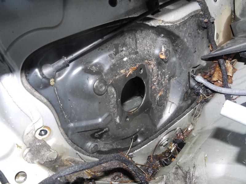

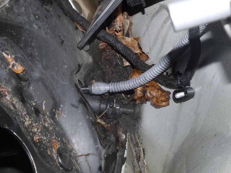

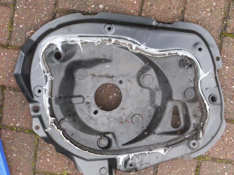

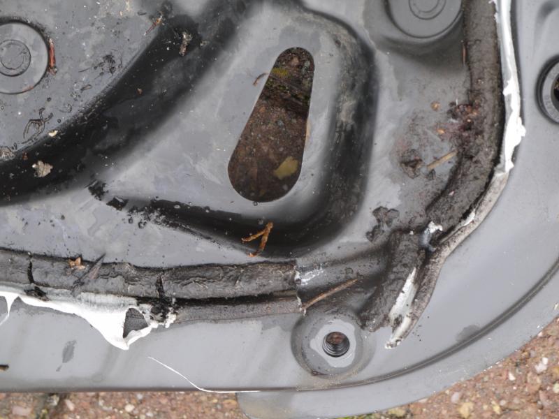

Low and behold, the pedal plate, closure plate, bulkhead sealing plate, or whatever you want to call it, was leaking water.

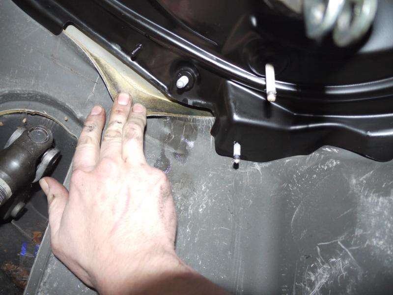

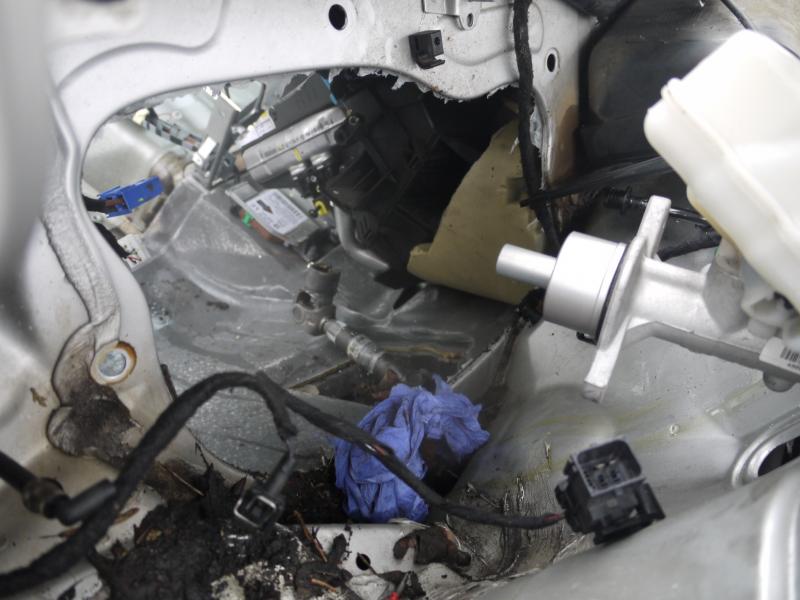

Working under the bonnet, wiper linkage, servo and master cylinder removed to reveal lots of leaf mulch sitting on the bottom corner of the plate.

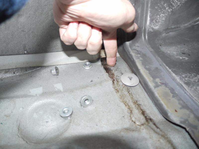

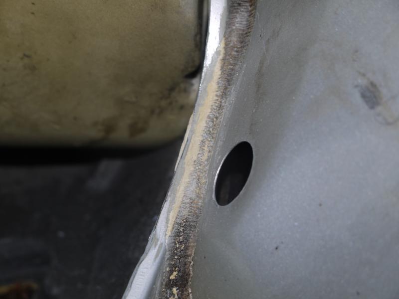

Plate removed, the white sealant peeling indicated a good seal in most areas, apart from the aforementioned bottom-right corner.
Hole ready for cleaned and re-sealed plate. Watch this space!
That's quite a tak you have undertaken. Thanks for sharing the photos. If you don't mind me asking, do you know where the 1/2 of water come from after the first mopping? Where was it lying?
I think it was sitting in the sound deadening that's attached to the bulkhead. I couldn't get this off as it's secured behind the dashboard, but doesn't get in the way of the work. There is a small section which fits over the plate and you can remove after the pedals have been removed.

- "It's leaking past the rear light cluster" - if it does, it will flow into the void between the outer and inner wing, then disappear into the sills and drain away.

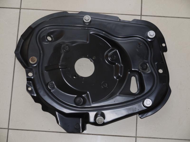

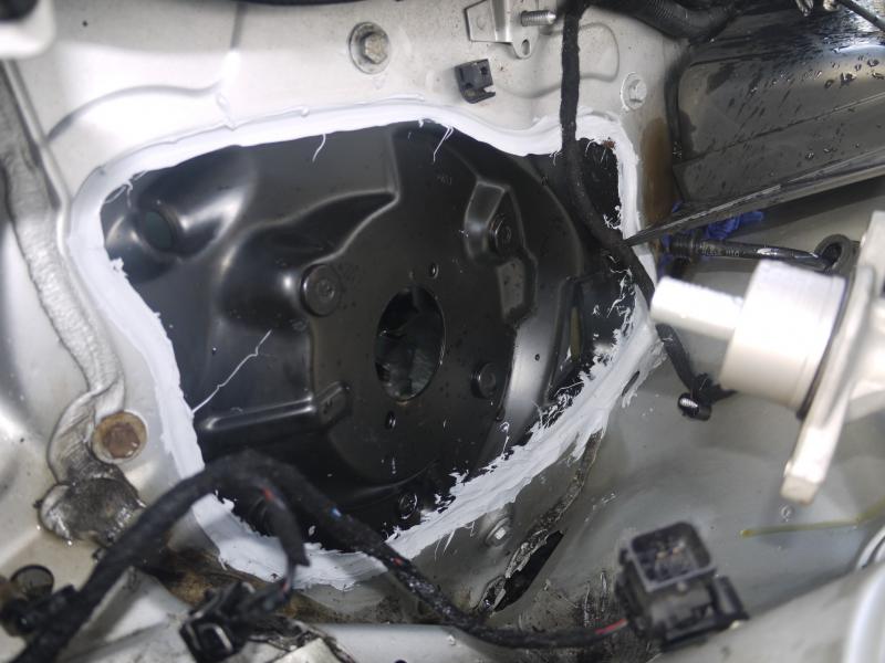

Time for the refit:
Scrape off all the old sealant from the plate. I tried a mixture of isopropanol and white spirits to help get off the rest which seemed to soften it in equal measure. White spirit will leave a residue though which needs to be cleaned off before proceeding. Wire wool was used to key the paint before applying the sealant.
Do the same to the bulkhead, both inside and out. The bottom-right corner shows where the old sealant met the seam filler. I used some fine wet & dry with isopropanol to smooth this off a bit.
Use a good quality polyurathane adhesive/sealant like Sikaflex 221, and spread it around the plate after positioning the plate back on its guides. Then pull it into position, bolt it in place, and smooth over with more sealant.
New gasket for vacuum servo.

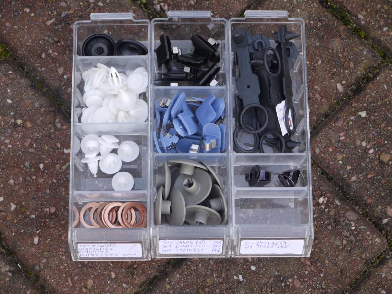

You'll need new clips for the trim, carpet and sound deadening.
Just random trays so apologies for those that aren't applicable. Top down tray 1:
- 90460880 (not needed here, for plugging sill holes underneath)
- 90321122 for rear quarter trim and door cards
- 9114743 (not needed here, for wheel arch trim)
- 11023582 (not needed here, washer for most pre-2004 sump plugs)
Top down tray 2:
- 24405739 clip for most trim pieces
- 24405740 clip for most trim pieces (different hand)
- 90214832 clip for carpet and sound deadening
Top down tray 3:
- 24417239 clip for boot carpet, an awful component
- 90355465 not sure, was listed in carpets/trim section but couldn't find a use.

3. All 3, i recall they overlap each other and certainly all 3 get in the way of the plate, as does the wheel.
