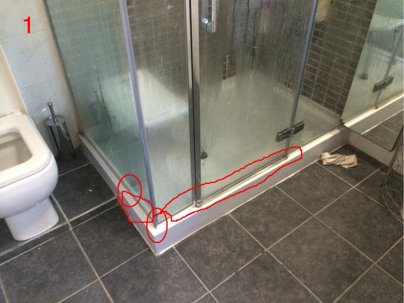

Image #1 is of the enclosure itself, the circled areas are the sections from where the enclosure leaks

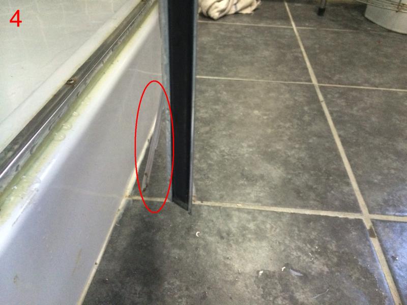

Image #2 is the trim I've been referring to & what the door seal catches on
Image #3 is where the door starts catching on the trim

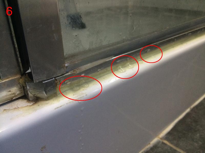

Image #6 shows where the drops of what have leaked from under the trim despite the door being closed

Needs new seals all round and door leveling if it's catching, have similar bar on floor but it's siliconed only no screws are used as these would foul the seal.
I agree a new seal on the door is needed, but the other issue is is that it keeps catching on that silver trim, also the enclosure moves too much, would it be that I have to take the whole thing apart & use no nails or something?
I'm just extremly confused as to how I can correct this issue, apart from the silicone both on the outside & inside edges, there's nothing else keeping the enclosure there and there aren't any other seals in or around the enclosure apart from under the door
Is there anything else that can be done ?
Have a frame less shower cubicle but has a bar above head height bolted to wall and frame keeping it all steady.
Just helped the father in-law install one that looks almost identical to this albeit a little smaller.
As above, on his there is a chrome bar at the top that has an adjustable grub screw to square is all up and hold it in place. Can't tell from the pictures of yours has one or not, I'm assuming not and this is probably why it has so much movement.
As a bodge you could trim the seal so it doesn't catch, it doesn't need to be lower than the fixed part on the tray to stop the water due to the taper.
Replace the cubicle, if you can find one that matches the tray. That's probably the only thing that will work long term and as mentioned one with a header frame will help. Your adding new silicone solution will not replace the silicone between the tray and frame.
