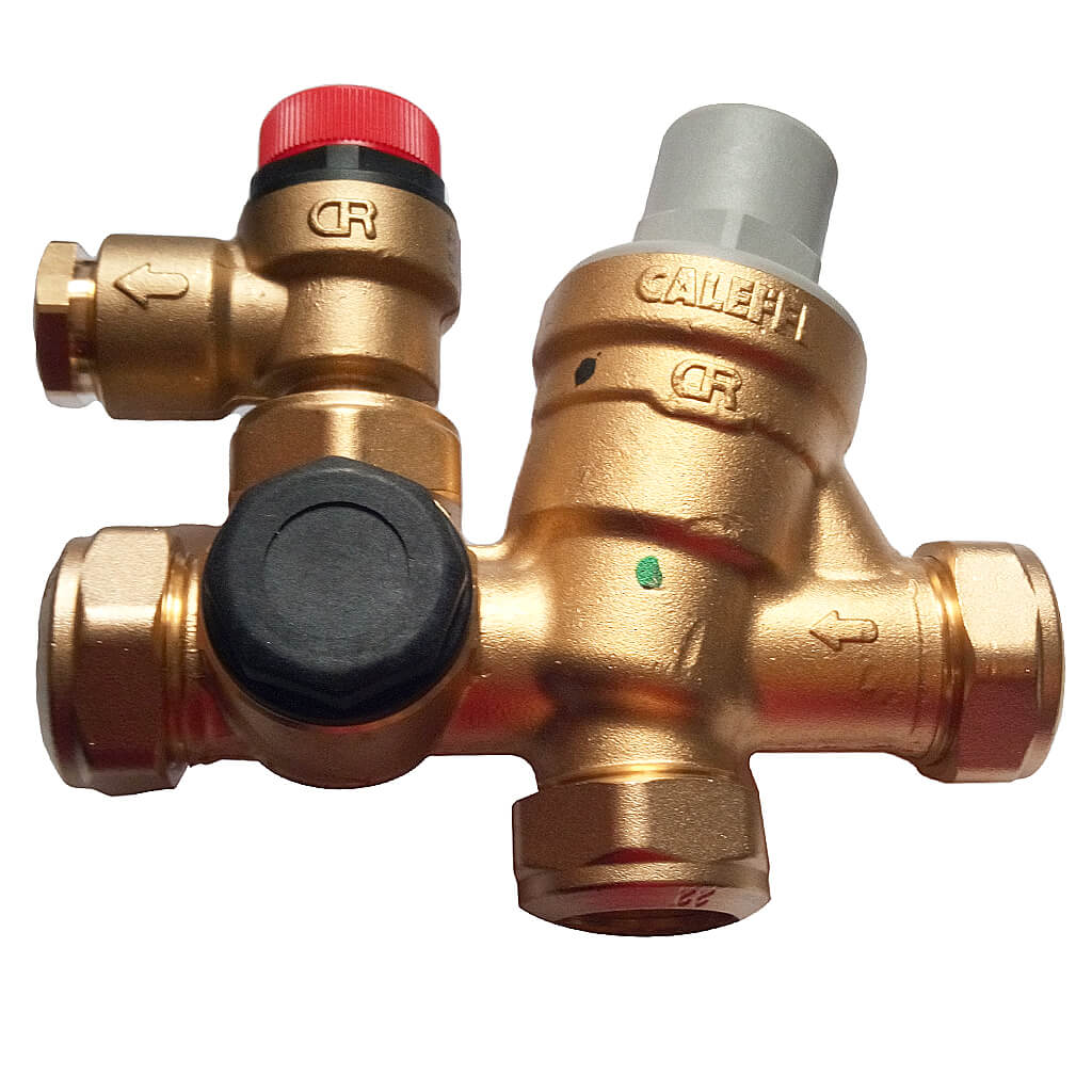

I have some water shock in the system somewhere which is mainly set off by the dishwasher; sometimes the washing machine and 1/4 turn taps although not as much.
I have an unvented system with this fitted which has the PRV integrated-
I'm a bit (but not completely) clueless on this set up so wondered what info you need from me to help in removing the water shock? Is it as simple as reducing the PRV? I haven't seen anything fitted to the integrated dishwasher that resembles a sock arrester

The pipes don't make a noise on their own, if you see what I mean. Water hammer, usually where water pressure is quite high and fast closing valve are used, is a compression pulse that's sent down the pipework when the valve closes quickly and the water stops suddenly. That pulse doesn't actually make the sound, that's usually when it finds an area where the pipes are loose or close together, then the pipes move and 'knock'
If you can't get to it all then fair enough and an arrestor is the alternative. Don't touch the unvented combination valve as that's not a DIY'able job
Yes, I did a quick read about unvented systems and stopped there!
Can you fit a system wide arrestor or are they per appliance?
You can fit system wide arrestors but that may not cure it, it will only cure it if the arrester can intercept the shockwave before it gets to the section that is knocking. Localised is better as it intercepts the shockwave before it can get anywhere.
