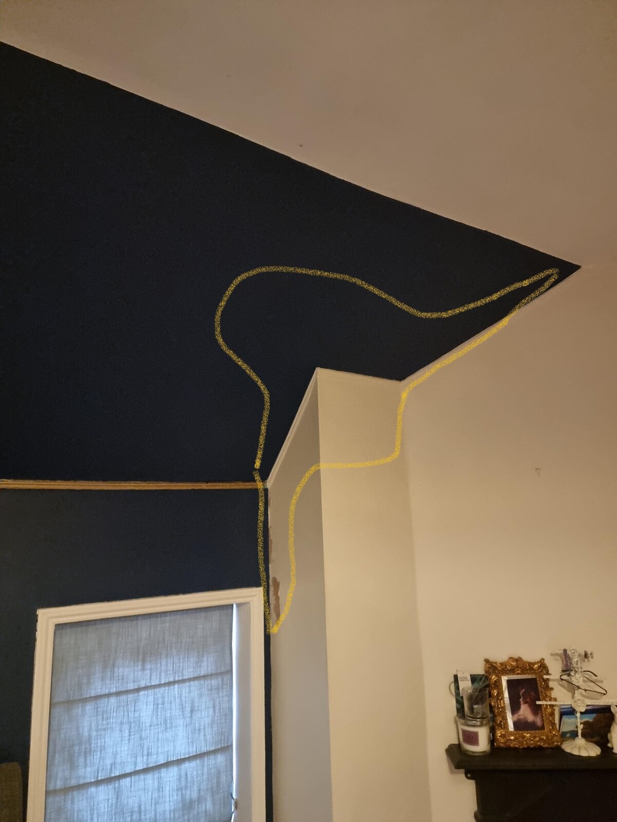

Not great pictures but I hope it gives some perspective, everything within the yellow line is damp to the point of it beading down the wall after heavy rain, moreso on the blue upper section.
It look's as though it starts from the valley further up and then comes down and pools around the chimney stack and down.

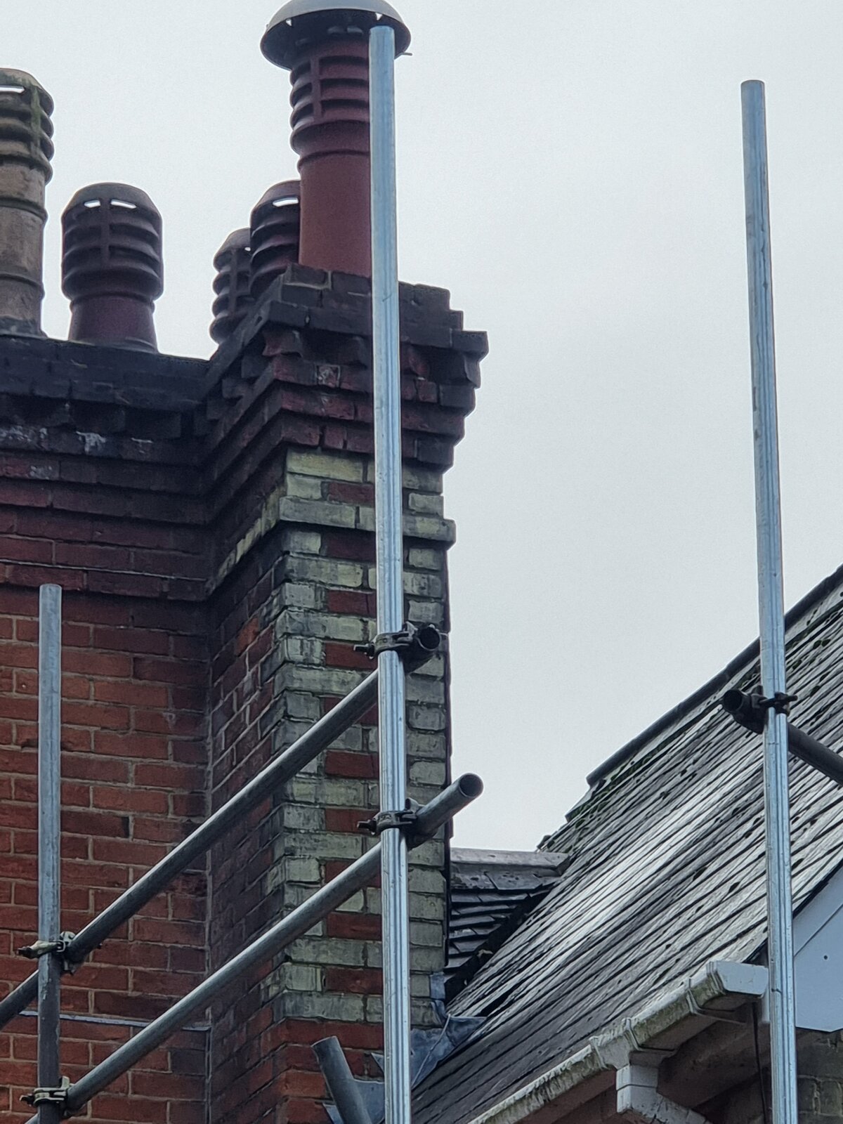

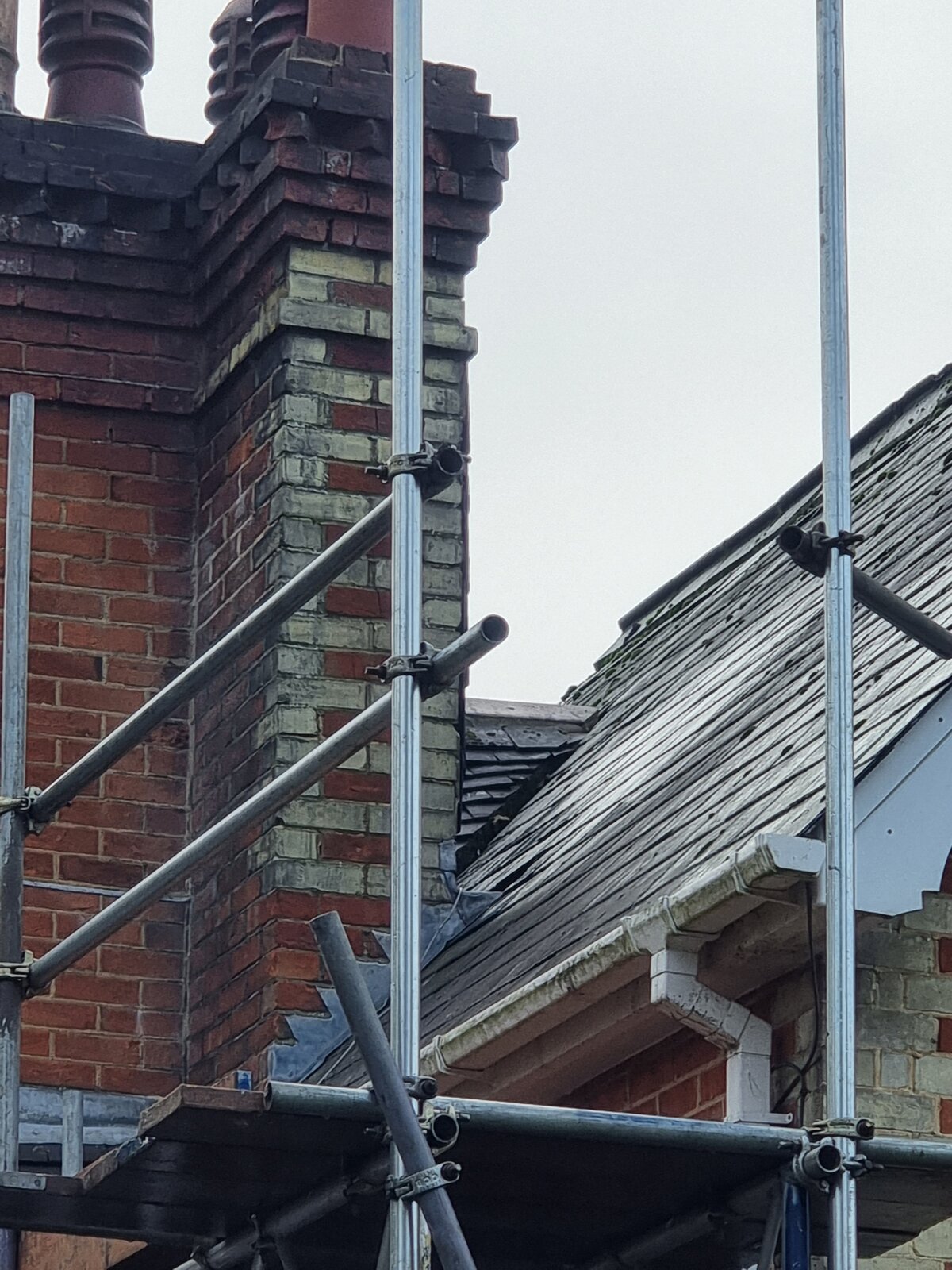

If the scaffolding is still there can you get a pic of the back gutter and some close ups of the dormer section and state of the brickwork on the chimney including the pots. The starting point would be inadequate work by the roofer if the problem remains, but equally if the cause is something different the work wouldn't have made a difference.

Re reading your second post there's probably been a bodge on repairing the back gutter, it's also possible the water has got under the tiles

Identify which pot relates to the flue in question, take a look in the loft for any signs of damp. Replacing the stack tray won't stop rain getting in through the open pot. Ask him for pics of the back gutter when he's up there. The chimney needs repointing.

Short valley to front gutter looks a bit rough from what I can see .
Couple of slate tiles look loose or have gaps .

What are your thoughts on the right side of the stack being tiled in slate, it's not something I've seen before, presumably to protect the pointing?

Good spot, it does indeed look rough. No sign of any damp in that location internally though, all seems to be on the opposite side of the red/white stack, exactly where those tiles are that have gaps...and going up towards the valley as per my previous photo with yellow outline.
There is a few things it might be . Not enough pictures .

The pitch looks steep enough to suit slate which is presumably original, while the brickwork of the left hand chimney and tile roof, look newer, maybe an extension, or because of similar problems with water ingress.
Blup
Sorry I mean there are actual slate tiles hung vertically on the side of the chimney if you look closely in the photos.
But yes, you are bang on slate was original house, left chimney was part of the extension on the left, a shoddily built one at that.
