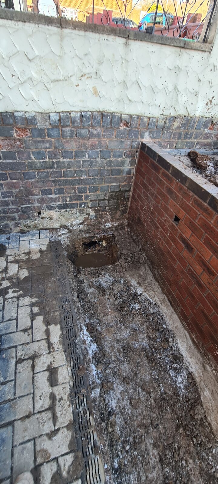

I have a major issue with a large amount of water leaking through a boundary wall into my front garden. Ive attached a droplink with a selection of videos and pictures further to the ones below
This has been discovered after paying to have my drive and block paving put down but it sunk almost instantly.

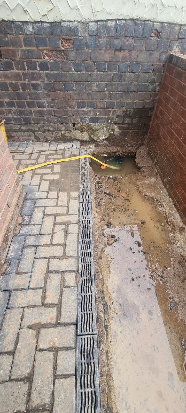

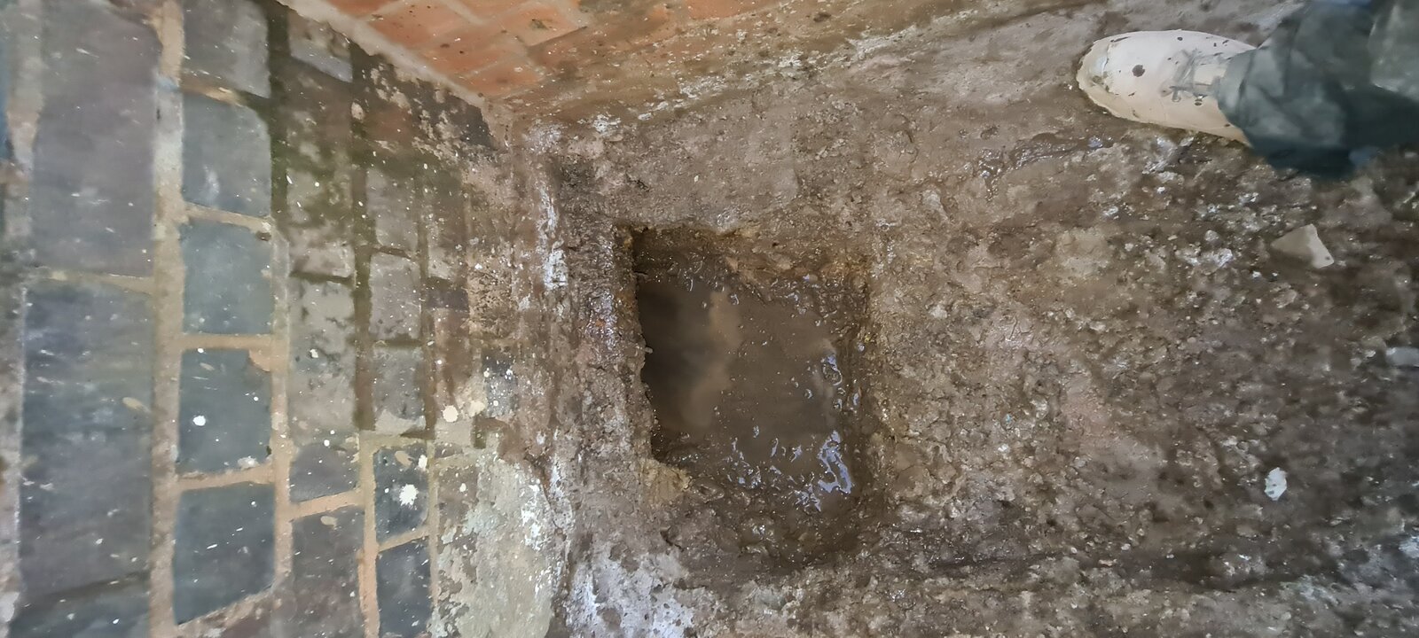

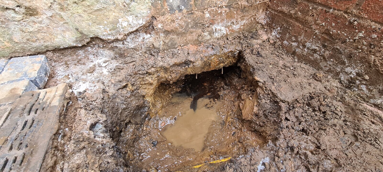

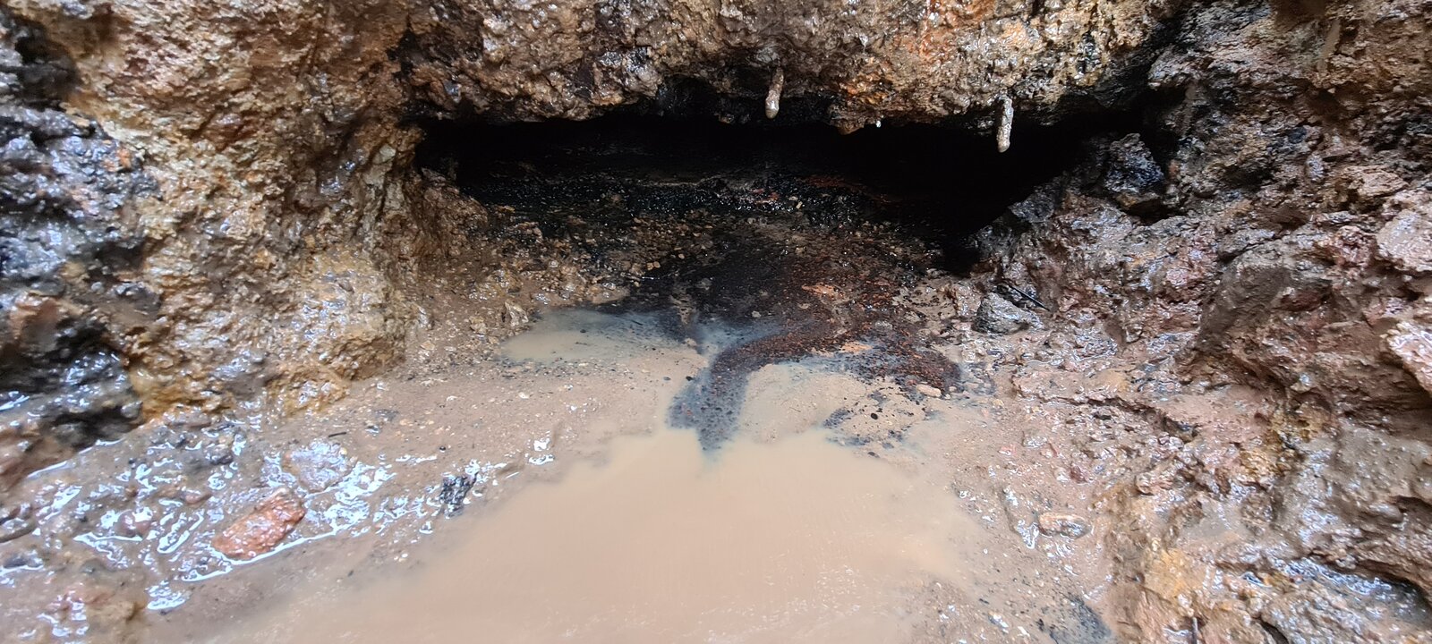

I have dug it all up to investigate and the water is coming through under the foundations of the wall seperating my house from next door. The water is running through clear and filling up a trench I have dug next to the wall twice a day (est. 80 litres+) often overflowing if i havnt been there all day.

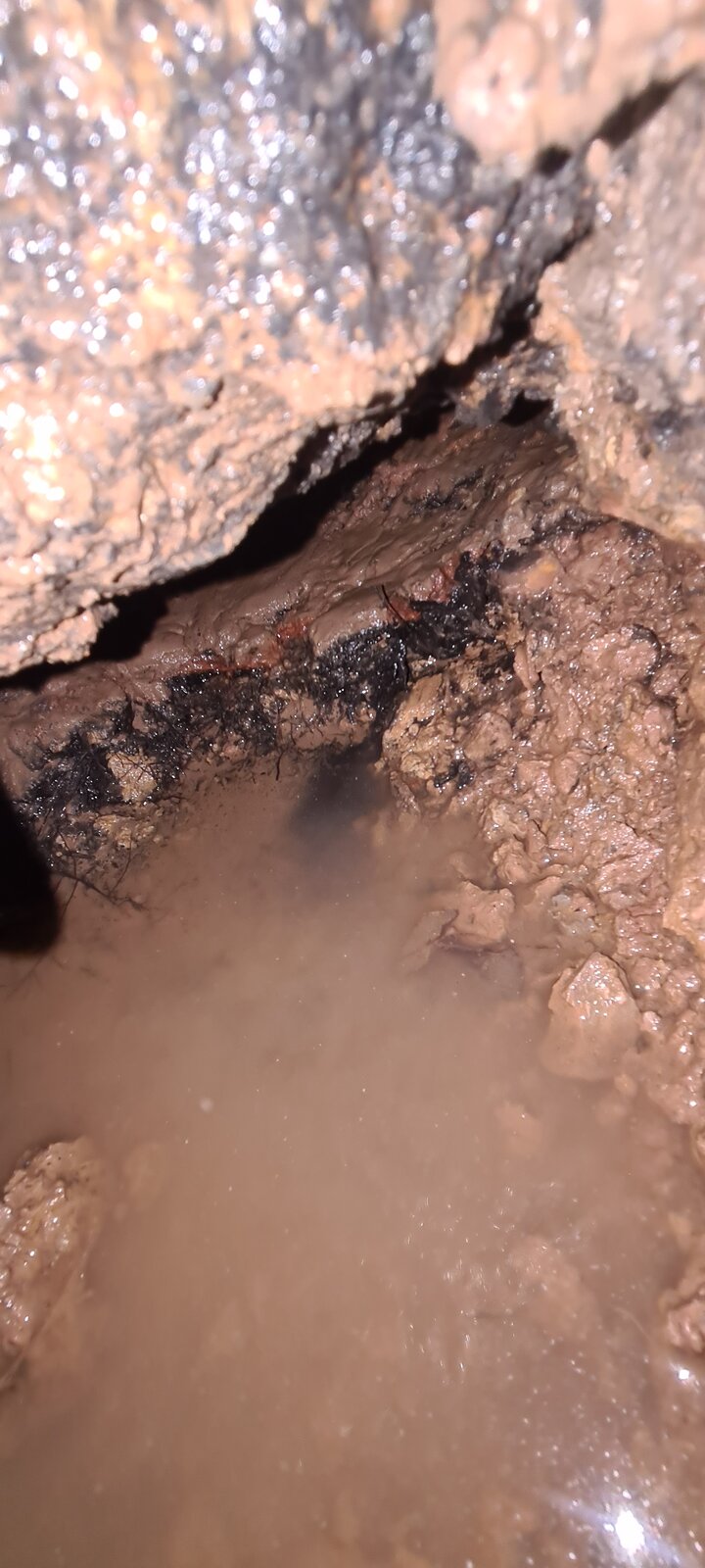

When the water leaks through and after filming under the wall I've noticed how hollow it seems behind and all this black stuff trickles through and is on the bottom of the foundation, what is this? The water stain on the wall i thought could be built up sitting water the other side as its been drying out a bit with how much ive been emptying water however, the soil from my garden before the drive came to that line so its hard to determine if its just drying out now it's seen daylight for the first time in 20+years
