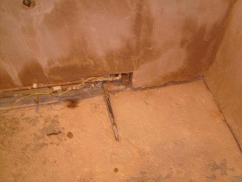

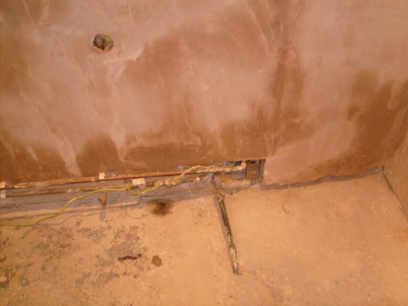

I need to do something with the black pipe which is the mains in and is in the way of my new freezer.
As you see it perhaps needs burying and maybe extending into the other room.
Any ideas gratefully received :D

Why not raise your freezer unto a small plinth?
If you move the broom, you could put the freezer over a bit :evil:
Make a hole on concrete floor, not too deep and sloping down in line with pipe as not to kink pipe. Push the pipe down and redo joint fitting. Fit a frame around, fill in gap, and fit a removeable access hatch so you can still access joints.....
Will that help?
