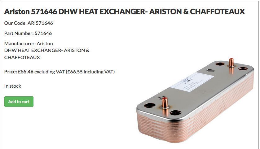

Now we geta bit more of the story. Do the tests, and you may find you need a new DHW heat exchanger. Irrespective of temperature, how does the hot water flow rate compare with the cold water flow rate. Easy enough to gauge with a watch and a 2 litre pop bottle.

Also, is it worth giving the DHW heat exchanger a clean out as suggested with a YouTube clip?

aluminium wouldn't, but anyway that's horrific stuff isn't that what they used for acid attacks? if you did a risk assessment you'd realise at 55 quid it's the only option to replace the thing!
Thank you for your reply. Right now £55 is alot of money. If I had that sort of money right now I would probably get an engineer to do the whole job.
