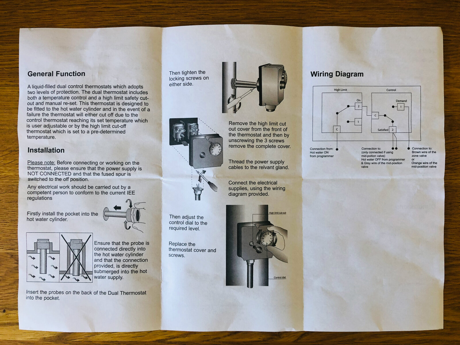

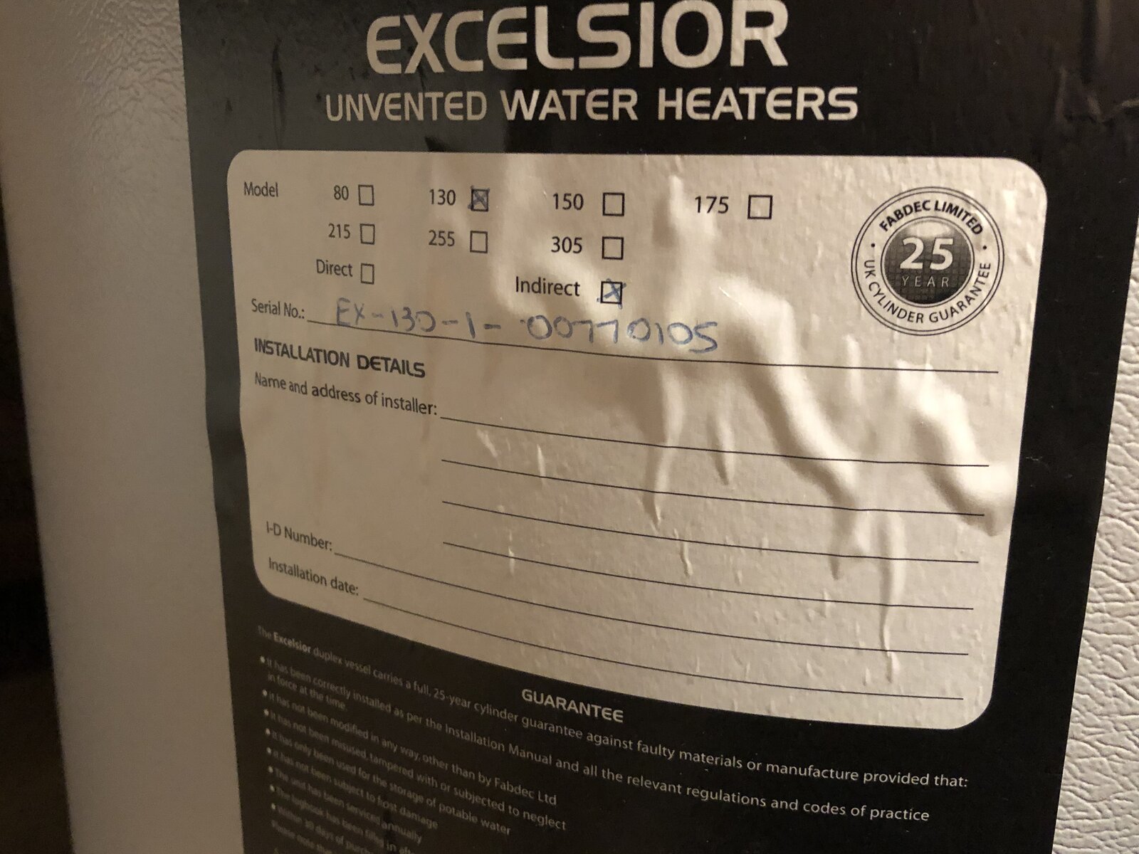

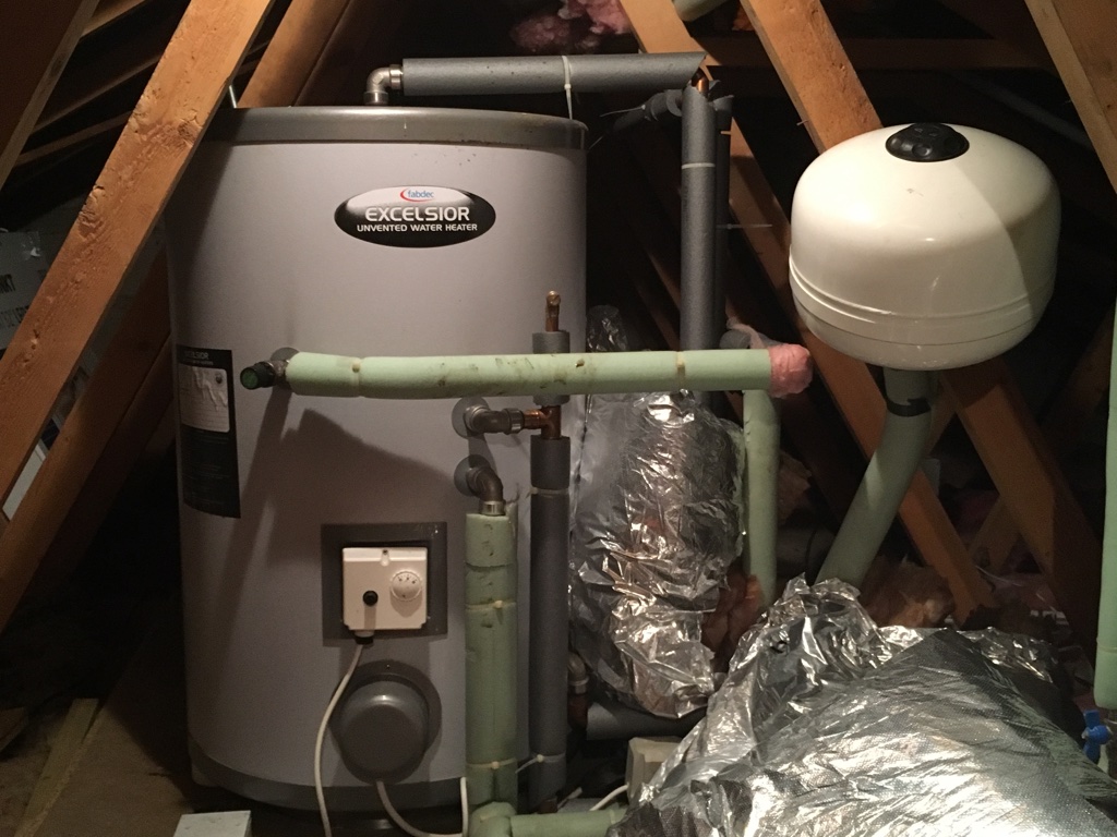

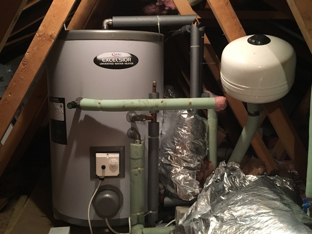

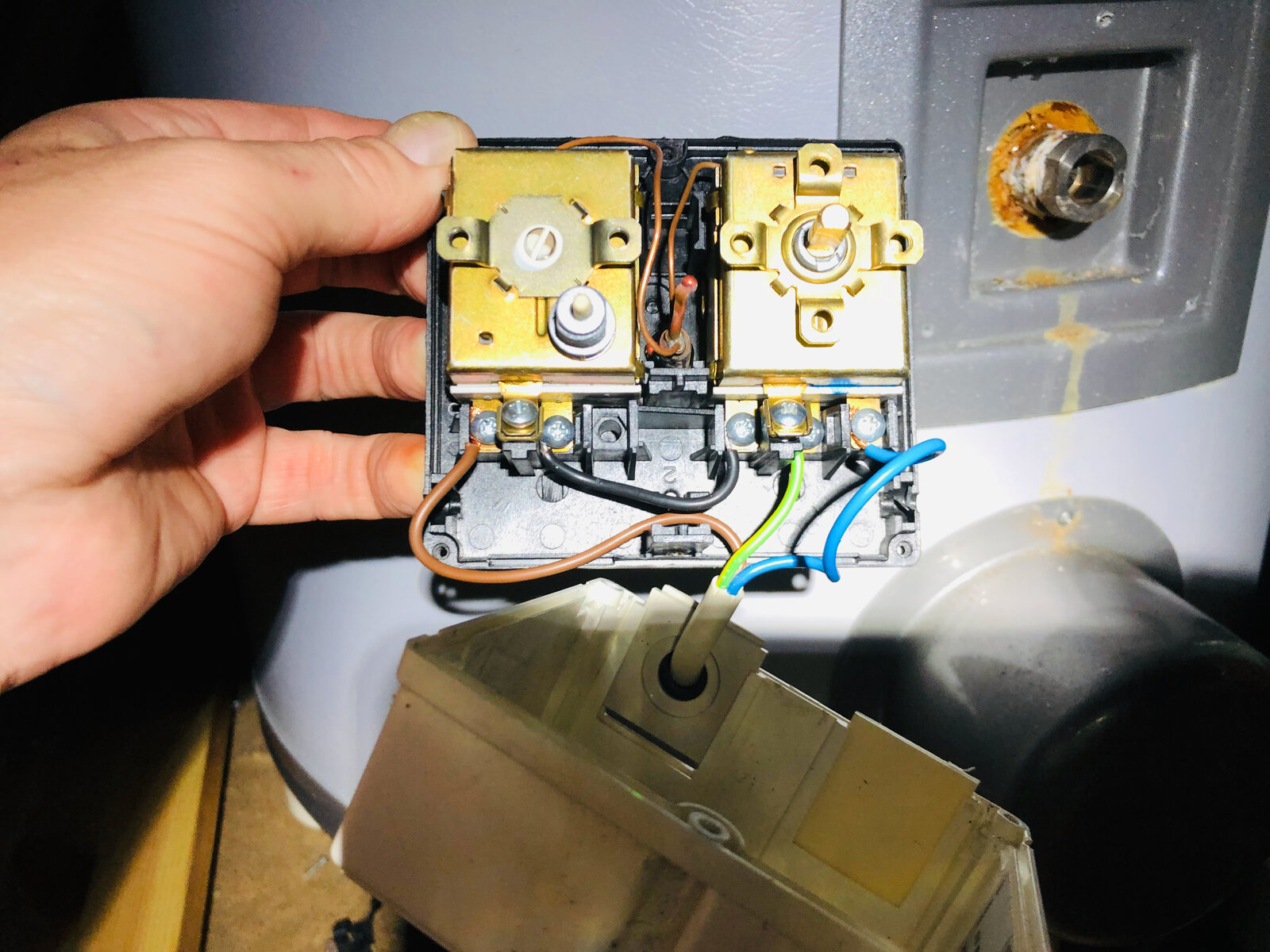

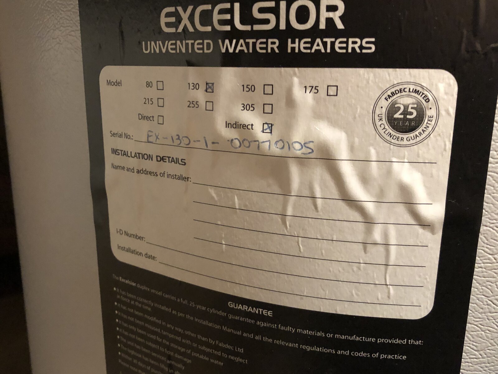

I have a Fabric Excelsior 130 litre unvented water heater in my loft. I have it timed to come on for 1.5 hours each morning. During these recent hot days, I'm finding that the water coming from the hot water taps is far too hot, even steaming.
A few days ago, I drained the tank of hot water by leaving the bathroom hot water tap on for a while. Then I turned the thermostat on the side of the heater down to 30C, turned the heater on for a few hours, then tried the hot water tap again. The water from the tap was again steaming hot.

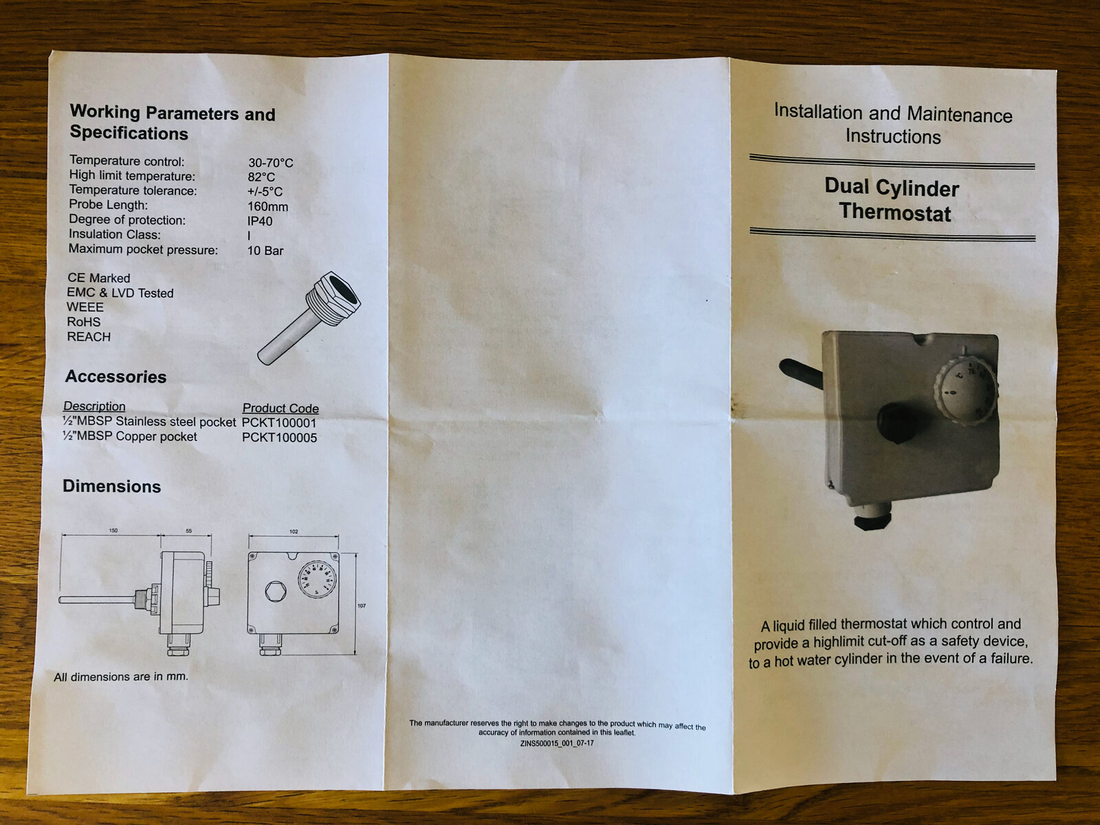

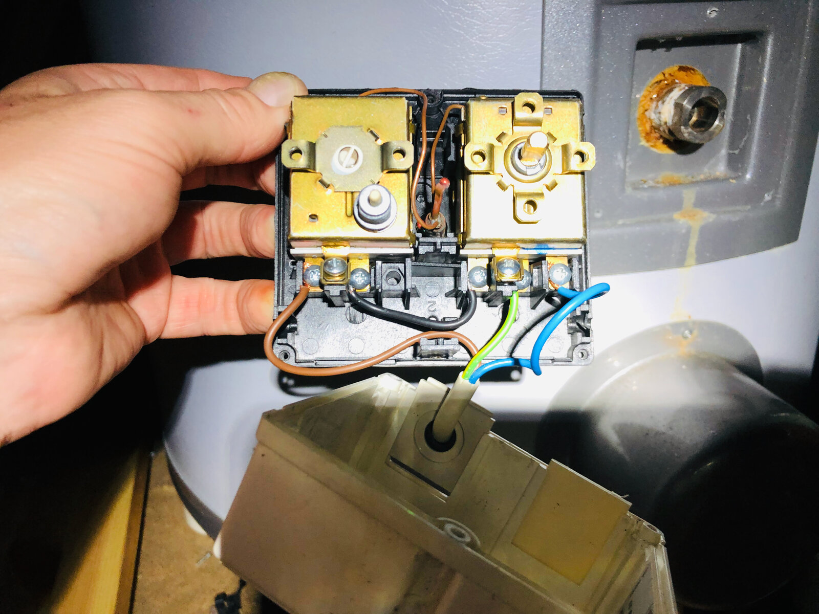

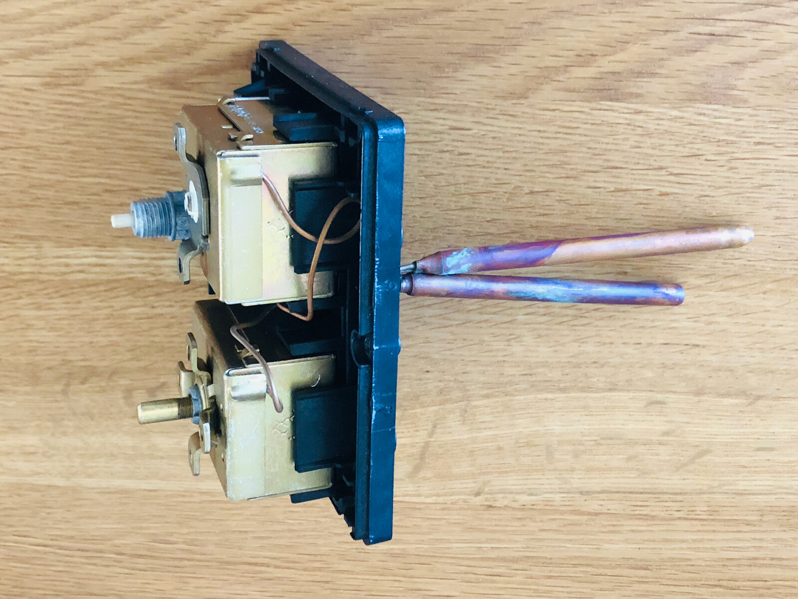

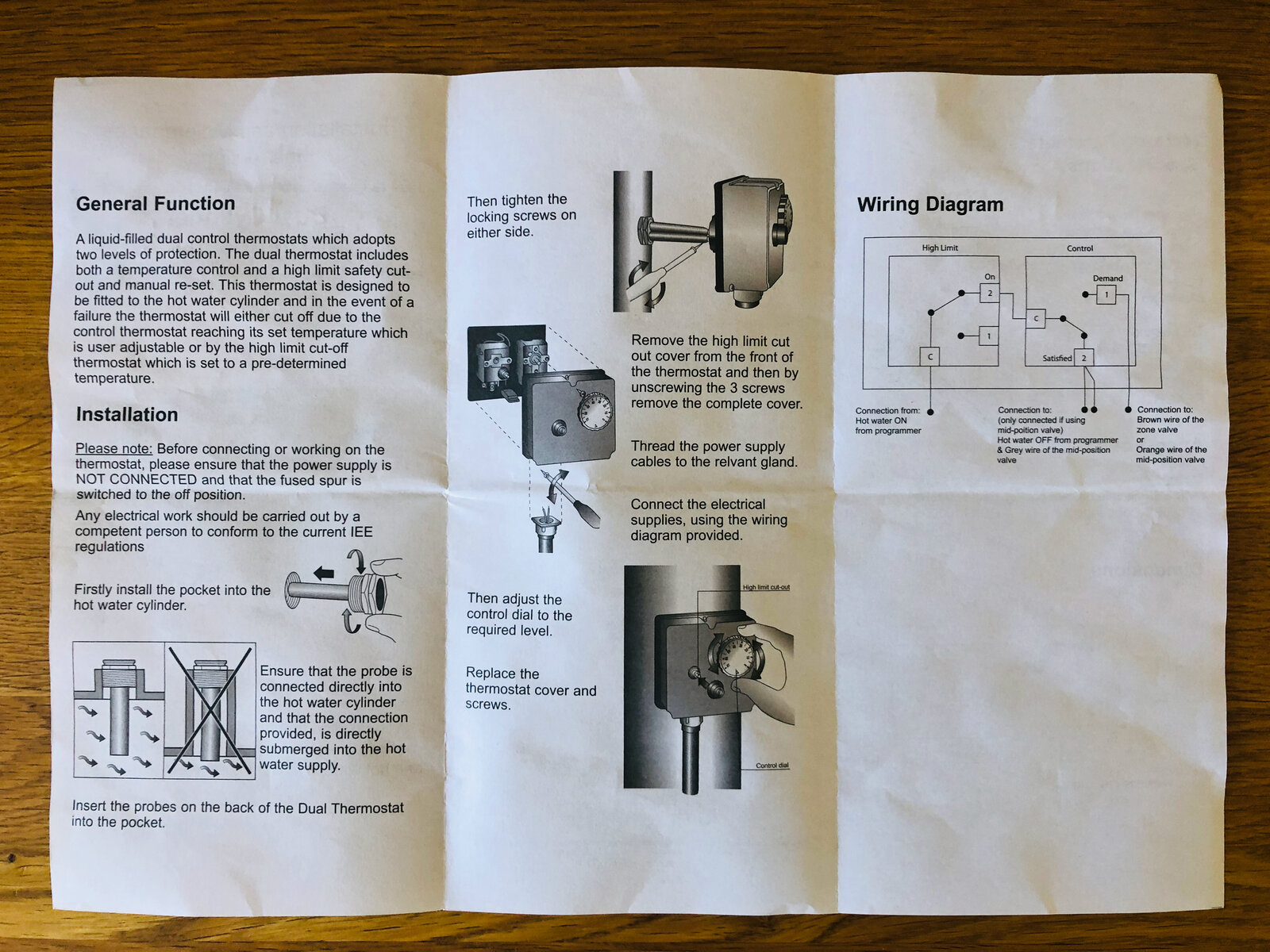

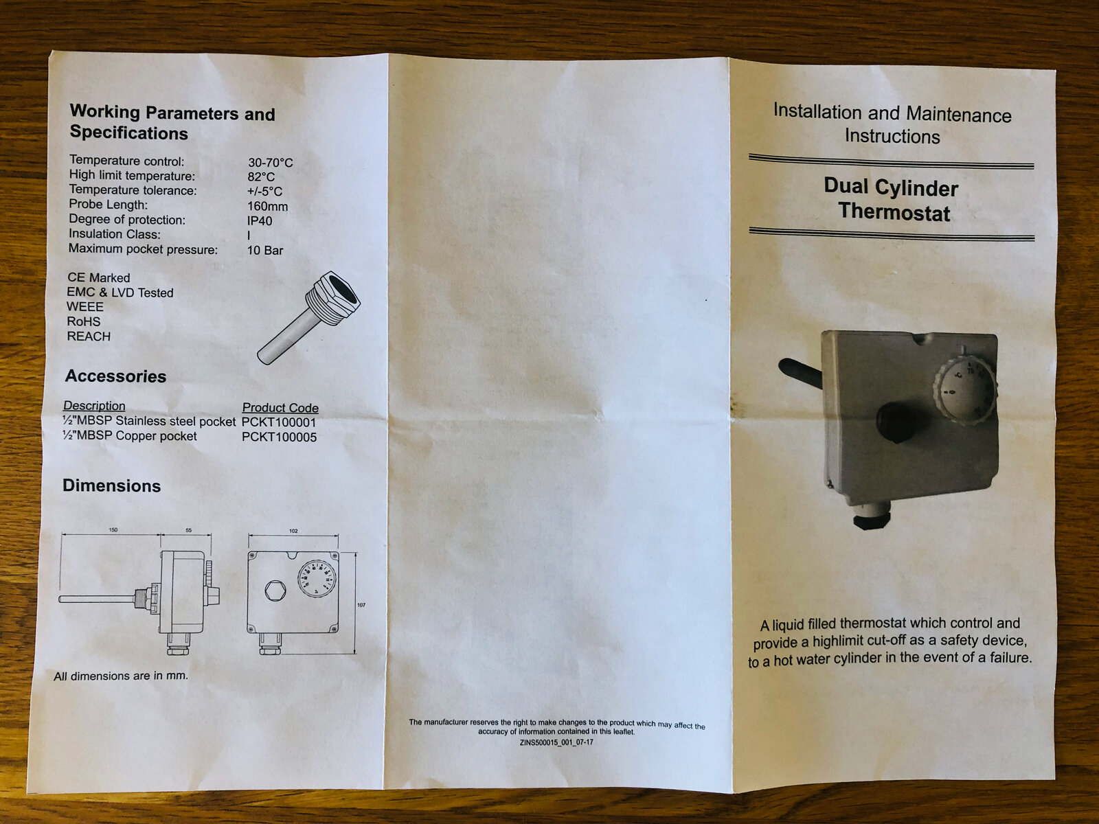

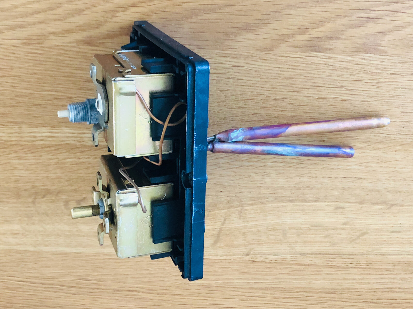

Suspecting a malfunctioning thermostat, I replaced it like-for-like, rewiring it exactly like the old one. Again, I drained the tank of hot water by leaving the bathroom hot water tap on for a while, then set the new thermostat to 30C just to test it, turned the heater on for a few hours. Expecting to now have just warm water from the tap, I again had steaming hot water.
I'm pretty sure the heater only has this one thermostat.
Wondering if anyone can suggest what might be going on here and what is causing the water to overheat? I've uploaded some photos which might help. Any advice greatly appreciated.

First of all those thermostat temperature settings are very inaccurate...I have the identical model and it's set at 45 with the water actually getting to the required 60 degrees (measured with proper test gear)...so it's guesswork getting the correct hot water temp.
Secondly the overheat stat and user thermostat have not been earthed. The earth terminals should be linked and an earth wire installed...whoever fitted the cylinder bodged it due to not having 4 core cable.
Since the earth wire has been pinched to be used on the hot water off terminal I'm guessing you have a mid position zone valve and an additional 2 port zone valve for the cylinder.
Looks like a Sunvic 2 port feeding the cylinder and these are notorious for jamming open and therefore no longer controlled by the clock and thermostat.
So have a look at the zone valves...if stuck open the cylinder will heat to the temperature of the boiler thermostat and that could be 80 degrees plus.
it's a timer switch to heat the cylinder using electricity
The thermostat you have replaced is what controls the temperature when it's heated from a separate boiler, usually gas or oil.
The electric element has it's own separate thermostat which is located under the round grey cover below the white thermostat box.
Unless you have electric solar panels installed and are heating the water during daylight hours, the electric option will be significantly more expensive than using the gas boiler.

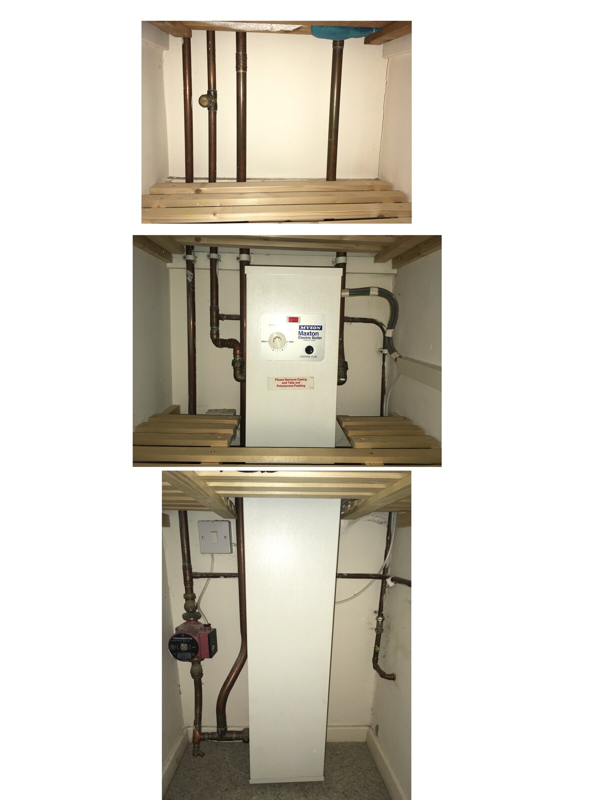

Ah ok. I have a slightly uncommon system which perhaps I should have mentioned - my apologies, I didn't mention this since I thought the immersion heater was a completely separate system. My mistake. Let me explain further....
There is no gas supply to the house (it's a very rural location), only electricity. The central heating system is run via a Maxton electric boiler (I've uploaded three more files to show this, all starting with the word "Maxton"). Although this electric boiler can be used for both the central heating and to supply the hot water, it has never been used for the hot water in the seven years I've lived here, the hot water being supplied by the immersion heater instead (I'm not sure why, it's simply the way the previous owner used the system and was what he recommended when we moved in - perhaps it was he who is responsible for the bodged wiring? He was a 'handyman' electrician, after all!).
OK, so from your post I think I now follow that the thermostat I replaced is the one which controls the water temperature if it were to be supplied by the Maxton electric boiler.

Yup, that thermostat was set to max, so I've dialled it down and we'll see how that goes. Thanks for all the help guys. It seems I've changed the other thermostat for no reason, but at least I've learned a bit.
