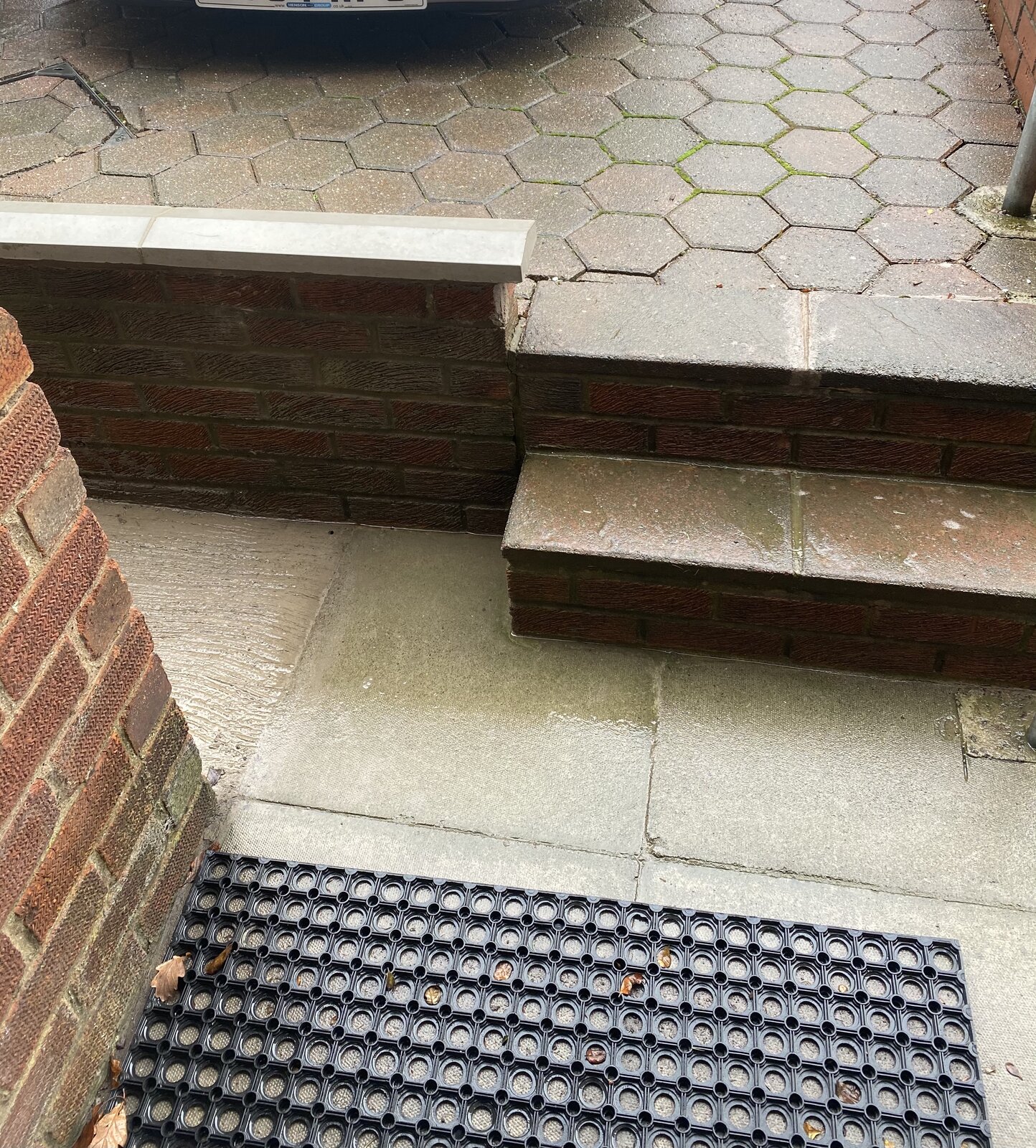

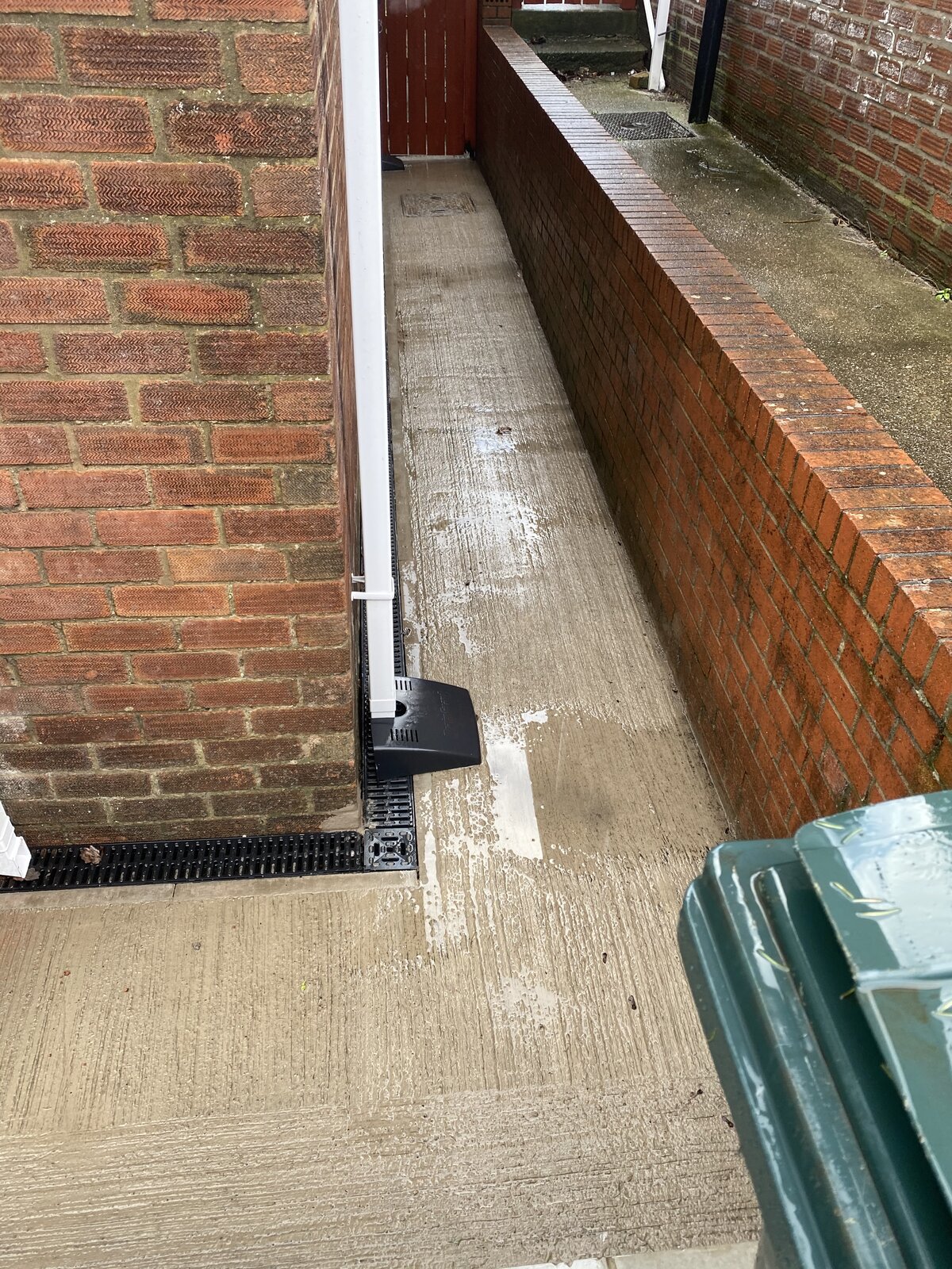

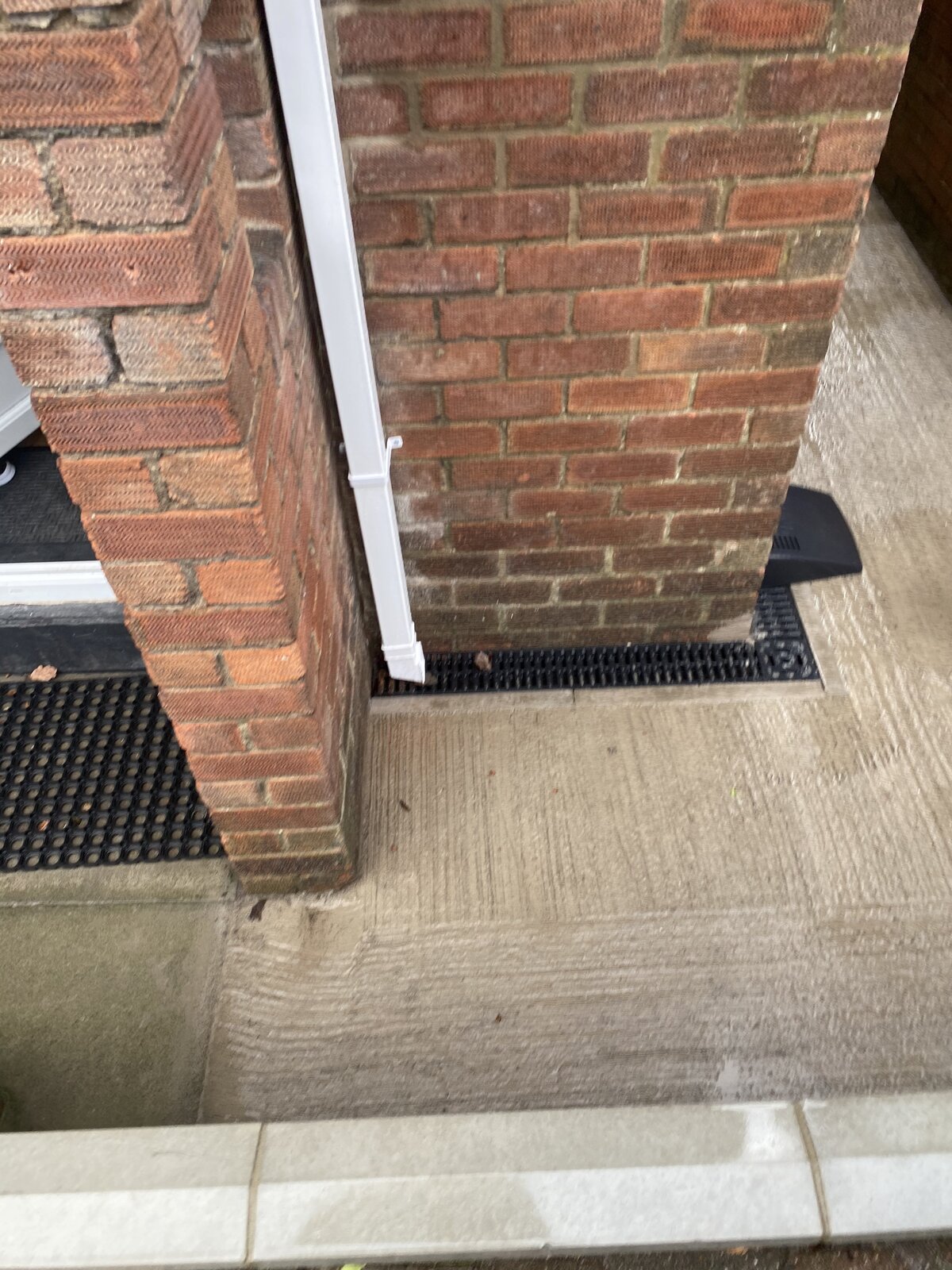

Hi all
Decided to relay concrete path around house as it was all cracked /old / damaged. At first I thought it was all great but since we have experienced heavy rain I’ve realised it’s now pooling heavily outside my front door. I’m a very novice DIYer but to me it looks like the concrete is not level correctly I.e too high. Any advice ? I was thinking of using a angle grinder to make some sort of channel? Ideally don’t want to rip it all up . The pictures don’t do it justice as the pooling at the front door isn’t too bad as I’ve just swept a lot away

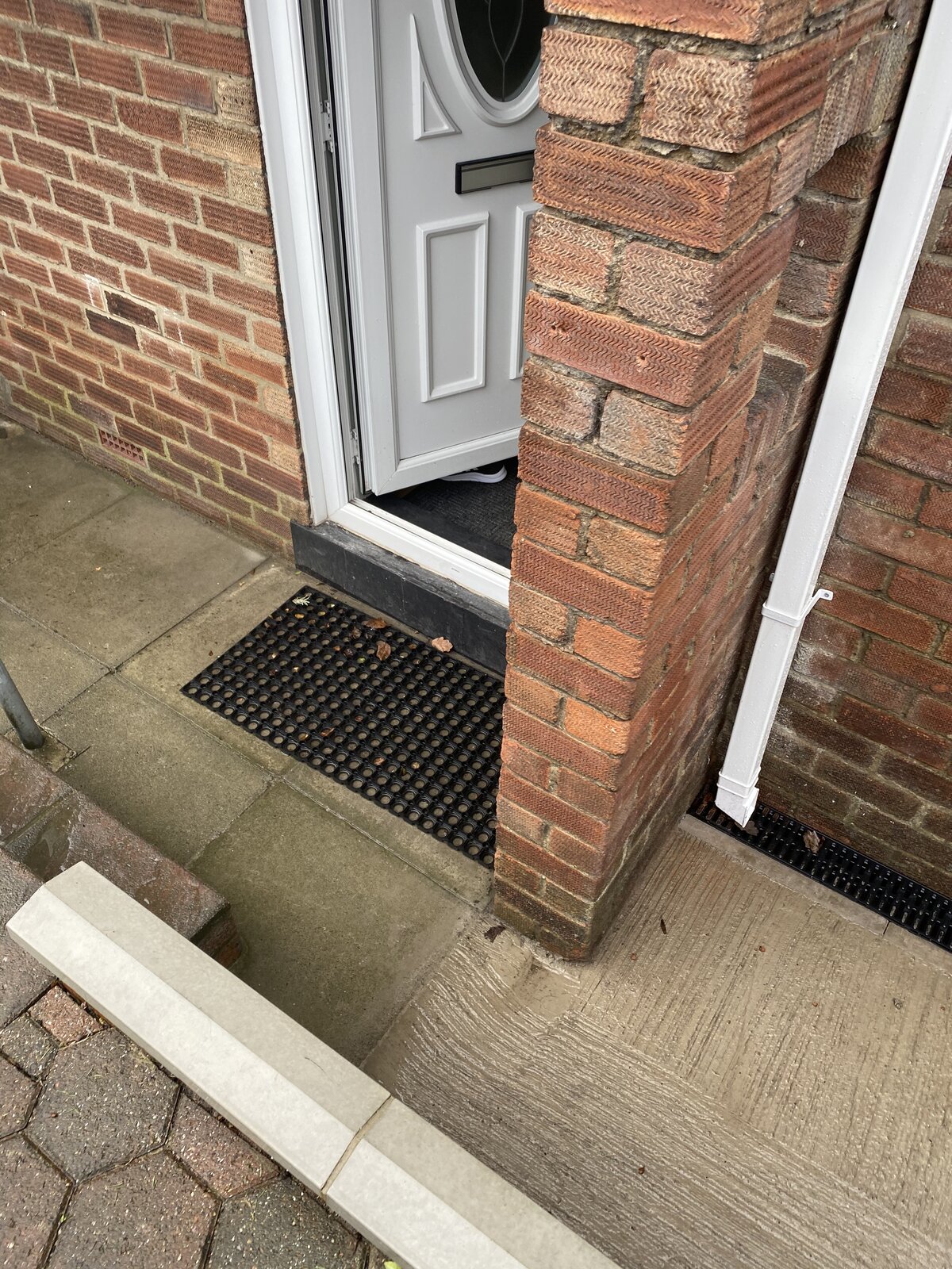

Below picture is where it mainly pools but like I said I’ve just swept a lot away so picture doesn’t do it justice

Relay the slabs.
Taking a grinder to the concrete is the easiest option. Make it look like any channels were meant to be.
I’m unsure I would be able to relay that slab as it’s also below the step. Angle grinder might be a option but I’m happy to hear all suggestions.
Drilling a few holes 10-12mm where the water ponds might work.
I tried that around the slab which meets the new concrete but it didn’t do much sadly. I’ve not tried it directly on the concrete itself though
