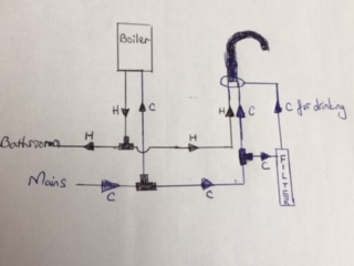

Hi.
I am wondering if someone can enlighten and advice me on a my kitchen tap questions that I can't quite work it out.

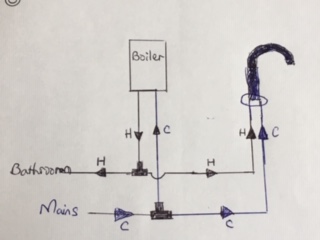

Question 1: The mains water pressure comes to my top floor flat is 1 Bar. Does it stay the same pressure coming out of kitchen and bathroom tap even though the mains got split into combi boiler and became 2 separate hot/cold feed into mixer tap?
I've drawn a simple diagram to illustrate:
Question 2: If I am to install a under-sink drinking water filter with a 3 way tap as illustrated below, will the water coming out of kitchen tap lose any pressure?
I am really confused about this pressure thing because I was told by Blanco CS that if I am to use Blanco 3 way tap then I must use their filter system. Other under-sink filter system makes it too low pressure to be compatible for blanco tap and I'm struggling to understand why because it seems most undersink filter system installs the same way?
I suppose this is a tricky question that's difficult to answer?
Does anyone know where should I measure the water pressure for choosing kitchen tap? (the cold feed, hot feed, or the mains water feed coming to my flat?)
Vicky
Problem is that we can make no promises, and is all assumptions.
But my take on your questions is:
?Will the water coming out of kitchen tap lose any pressure - No, but may loose some flow rate due to the extra bend. But will be very small diffrence.
?We must use their filter system as other under-sink filter system makes it too low pressure to be compatible for blanco tap - Seems like a marketing ploy to me. Unless their filter has a much lower water restistance (ie perhaps they use a much larger filter) then I think that it would not make much diffrence whatever water filter you use and conneect to their tap.
