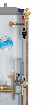

Thanks for that, I have just looked at the instalation instructions and cant fit one without quite a bit of pipe modification, they are not compatable fitted vertically on a rising main .:(
The instructions say that but......
With your example the water flow is in the right direction in relation to the orientation of the adjustment knob ie its pointed upwards. The Honeywell, and all their valves are the same, the adjuster would point down which according to their tech support is wrong because it allows any debris in the water to fall back into the valve seat
