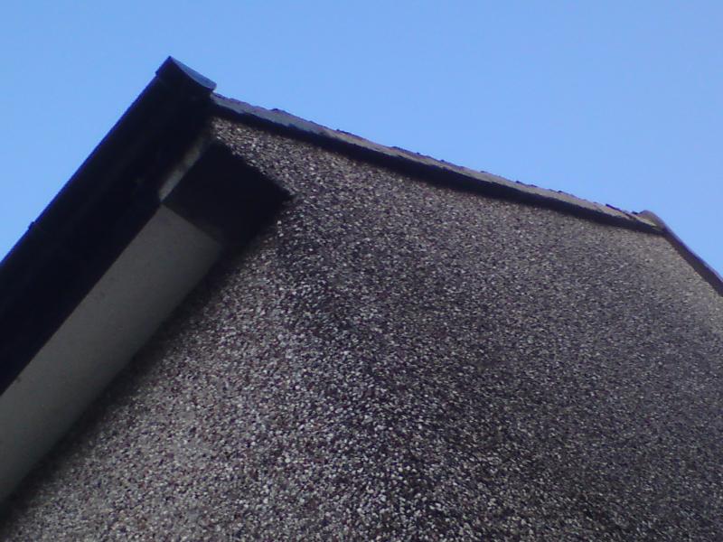

After some very heavy rainfall at the weekend I noticed some damp patches on the hallway wall. Looking at the outside of the house, the corner is saturated.
I thought it must be a problem with the guttering, but I've had a bloke look at them and they seem fine. He reckons the water is running off the side of the roof and down on to the wall because there isn't enough of an overhang - it's not too clear in the picture, but the overhang gets narrower as the roof goes down.
It might have been doing it for a while as I only noticed the damp patches because we've got the wallpaper off at the moment. The guy who looked at it reckoned that when the house has been re-dashed some of the overhang might have been lost.
He didn't have any ideas beyond putting some sealant down as a temporary fix or getting it reroofed.
Is a new roof (which I'd struggle to afford at the moment) my only option or might it be fixable?
The mortar along the side of the roof is cracked and in very poor condition - not sure if that will have anything to do with it, but the rest of the roof seems pretty good (it is the original roof, probably around 60 years old).
Any advice or suggestions greatly appreciated.

I would say your guy is correct.. There is very little over hang which actualy looks like it has been repaired in the past.
Over all it looks in poor shape and shoddy.
It looks like you have interlocking tiles (might be wrong) increasing the overhang could be tricky.
you could try having the verges stripped down and rebedded get the new undercloak to tip away slightly from the building,
you could try dry verge system if you have enough over hang.
I would guess that the rain came over the gutter top as it happens sometimes in very heavy rain (gutter to low), i don't think it has been happening for long as your wall paper would have peeled off.
