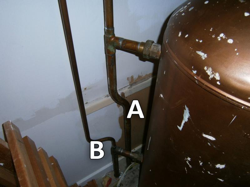

I have a gravity central heating system, need to solder a pipe fitting thats leaking. The fitting is on the pipe that leads from the bottom of the copper cylinder coil. So I locked up the ball cock for the water feed to the boiler and drained the system by undoing drain plugs on the ground floor radiators.
However, there is still water in the pipe from the bottom coil and the down pipe???

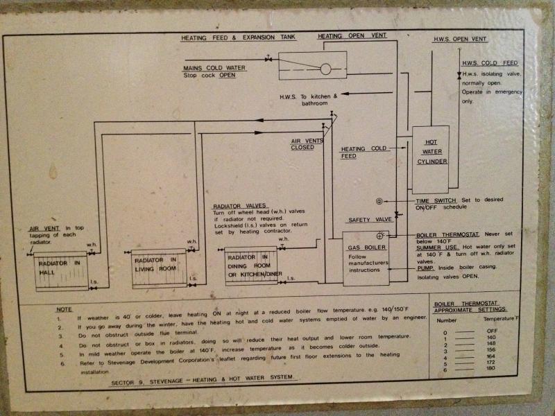

Sorry, its pump is by the boiler used to push water around the rads, Im guessing. The system does not have any modern fancy pumps whereby you can switch CH on only, or Water heating only. When you put the heating on, the water gets heated too.
My system
Water is in this pipe labelled B
I just need the water to drop below the "B" pipe, so I can solder the Joint, but have heard that if water is present in a pipe you'll never solder!!! thanks
Is it a primatic cylinder?
Do you only have 1 cold water tank?
It's possible that the pipe is the cold feed from the feed and expansion tank and it is blocked.
If you trace the pipe back does it go into the feed and expansion tank?
