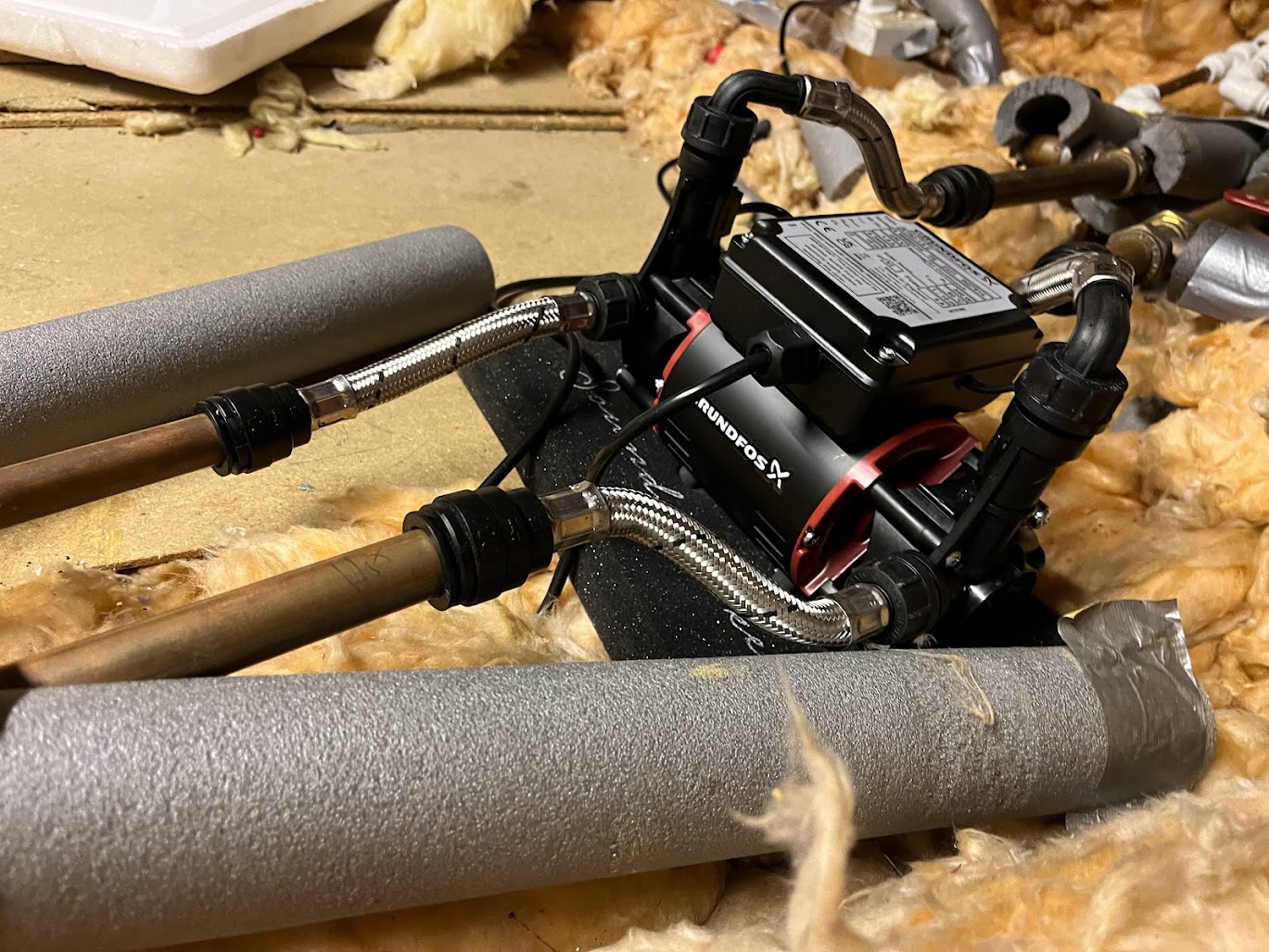

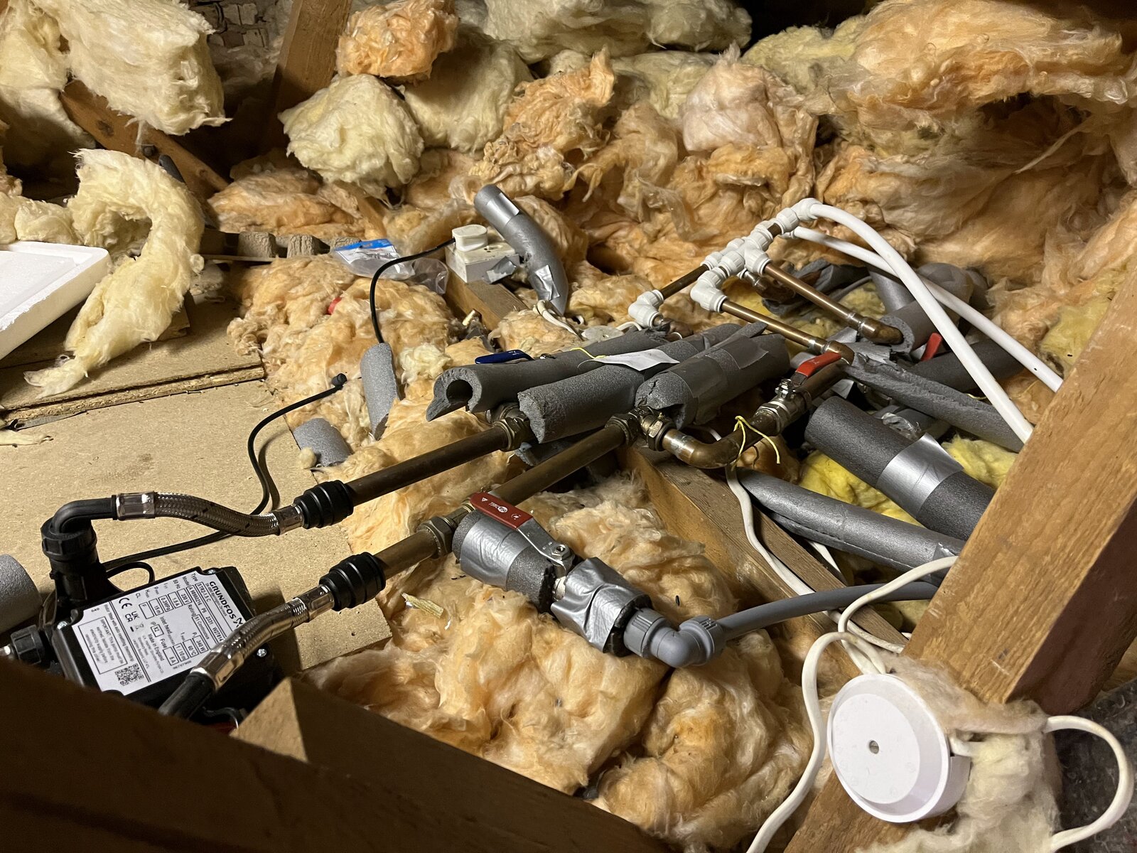

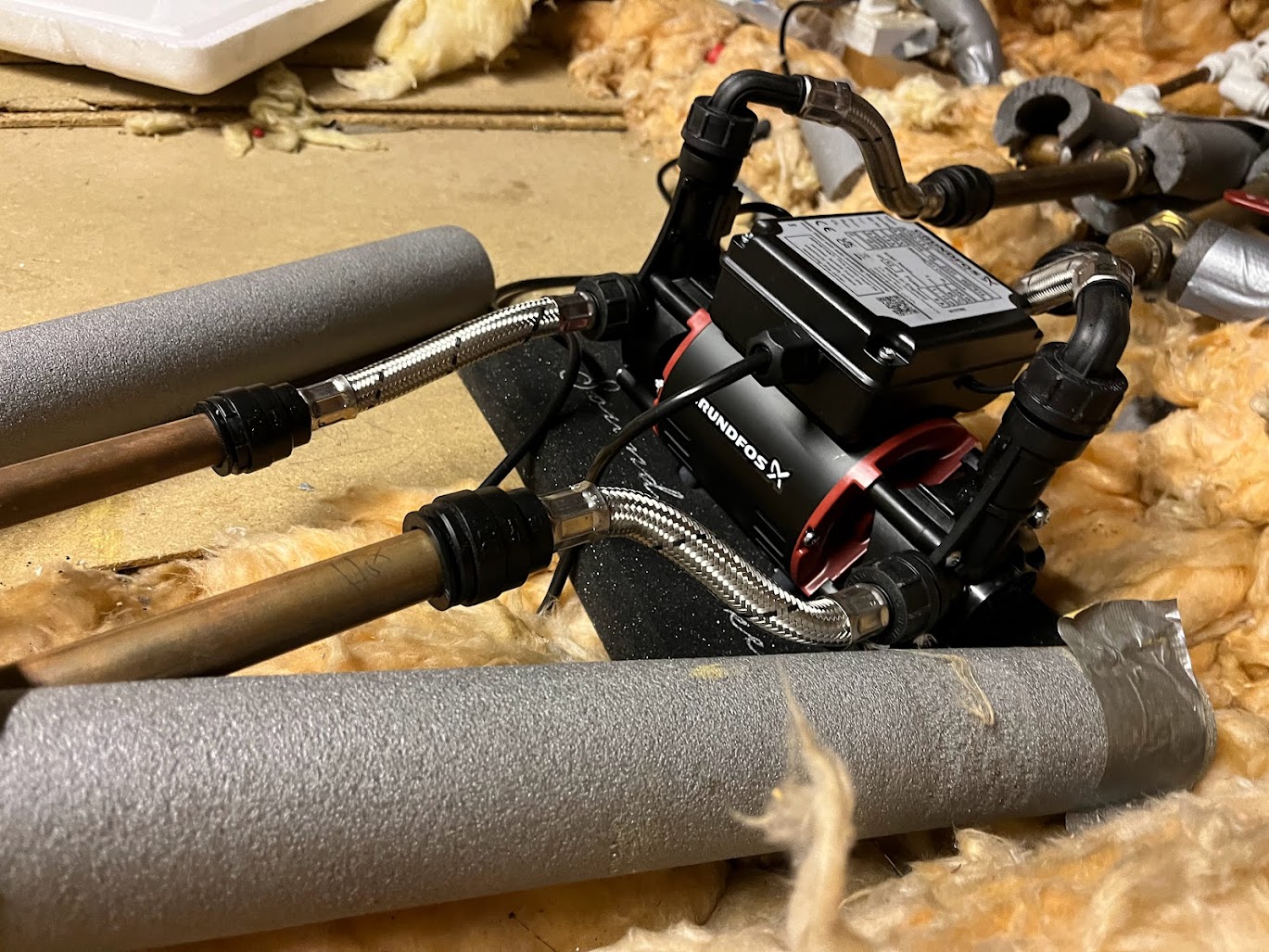

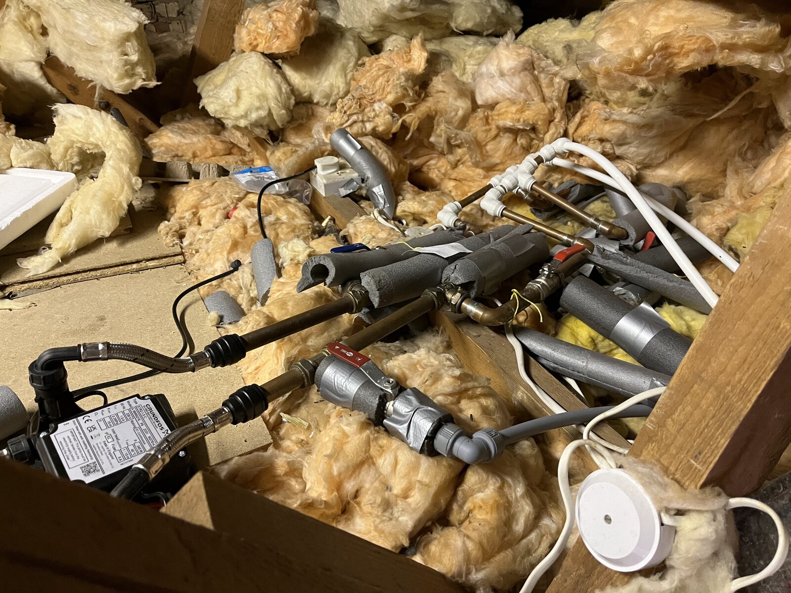

To resolve this a Grundfos electric pump was fitted in the loft which was activated whenever hot/cold water was called for. This was OK but about a month later the pump failed. It seems, we were told, that either the cold water tank in the loft or the hot water tank had drained empty and the pump was burnt out.
The solution we were told, apart from replacing the pump, was to increase the rate at which the cold water tank filled by fitting a new valve.
Since then, for reasons I won't go into, the plumber has been erratic due to health and family issues.
I would appreciate advice on what I could do to increase the rate at which the water fills as so far I have not found anything that seems to fit the bill.

Ok ,thanks ,but we don't know what the status is now. Run kitchen cold tap for 1 full ,timed,minute into a bucket or other container. Then measure how many litres of water are in the bucket . In essence ,if your cold water supply is giving less litres per minute, than the pump is delivering ,the loft tank will empty no matter what float valve size is fitted.
Bear in mind that when another tap / outlet is in use whilst shower is in use the inlet flow rate into the loft tank will be virtually halved.
Can I suggest you also do the measurement with one outlet full open whilst filling from another, that should provide a dynamic figure.
What size in the cistern in the attic? Is the hot water cylinder in the attic too and what size is that? Size/make of pump?
Hi, don't know size/capacity of the water tank. Not sure if I did this right but I used a bucket that has litre markings and filled that from an outside tap. The max capacity was 10 litres and this was achieved in 54 seconds. With another tap open there wasn't much difference, it got to 10 litres at 59.5 seconds.
The pump is a Grundfoss 1.5 bar.
Hi, this is the state I have been left in. I have switched the pump on again to see what happens. My wife and I are thinking seriously of having the pipe work changed back to how it was originally i.e pump only serves the shower in the bathroom everything else is gravity-fed apart from the Aqualisa Quartz Classic we have in the en-suite which has been there for 20 plus years (pump has been changed under extended warranty at least twice). I have not found any info on being able to change the bar setting for this as the plumber suggested. Sadly, we are in the situation we are in as we were very grateful for all the work done to fix the underfloor leak but it does seem now that we have to sort out the current situation ourselves.
Might have the water tank inlet changed to 3/4 inch but I am not convinced that this was/is a problem as we never had the tank go dry when we had the original higher bar pump working just on the shower so why should it have gone dry with the lower bar pump. We never have both showers running at the same time.
