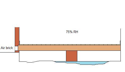

I will update when I have more information about the water table, after I've had any drain inspections done and generally have more of an idea of the root cause of this. I have drawn a little diagram looking from the hallway side of the room so the issue is clear. Also there is one picture of the lovely, 'inviting' crawlspace showing a bit of water (what I originally saw before it'd rained). Note, there is more water to the right of that in the picture.

I think you need to determine whether or not there is a broken supply pipe running beneath your property, or if this is ground water being pushed up because the water table is so high. Ome trick there is to dig two or three holes in the garden and cover then with a board. Within a day or so if the water table is high these holes will fill to tha same level, even if it isn't raining (providing it's not freezing like tonight)

if it is associated with rainfall, and the ground slopes away from your house, it may well be a broken rainwater gulley. Older houses have these in salt-glazed clay (brown earthenware) which IME are always broken at the bend. It is wearisome, but not a complicated DIY job, to dig it out until you reach sound pipework, and renew in plastic.
If you or your neighbour has such a gulley, see if the ground around it is particularly wet, or if you can find any red worms, which like broken drains.
If the concrete around a drain has been patched and filled, it is usually to cover up the hole made when a broken drain washes away the soil beneath.

You have an unusual experience. Usually, the subfloor can be kept reasonably cold and dry by good ventilation through airbricks at both sides of the house, so a DPM would not be appropriate.
