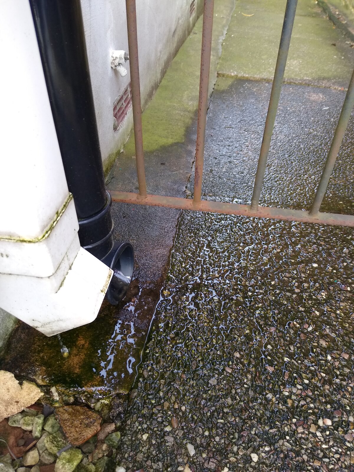

Hello, hoping someone can advise please.
I moved into a 1930's end terraced house a year ago. The roof water from 4 houses drains to our end at front and vice versa on back. There is an alley between us and then another block of 4 houses starts.
While having some routine work done the electrian advised we had some standing water under our lounge and against end wall which stairs run up. It is a couple inches deep but did go down to hardly anything in Summer months. This wasn't picked up on survey.
I have had Severn Trent out and they took some samples and came back to say it is rainwater as no fluoride present. We have no leaks on heating system either. The drive at front is block paved and level with no slope towards house. All of the air bricks are intact and unblocked.
The only thing I have noticed is the rain water from our block of 4 houses drains straight out into the alley. The neighbours have a channel against their end wall drawing down into sewer. Mine just drains out onto the concrete at side of my house. Could this be the culprit! If so, how is it getting under foundations? I have attached a picture to help.
I would appreciate any advice as I don't know whether I need a builder or drainage specialist.

Wheres the gully?

The make shift gulley is on my neighbours side. It is only about an inch deep. She has some water under her house too. None of the other neighbours are affected.
I have no gulley at all.

What do those two fall pipes (square white and round black one) provide drainage for?
Should be some arrangement for the drainage of that amount of rainwater, I cannot believe it's been left to find it's own way to disperse for this length of time. I would be asking Severn Trent to tell you where the sewers run before you do anything else.

If the ground is saturated, (which is likely given the amount of rain in recent days, coupled with lack of any proper drainage), it will result in a high water table.
The fact the water comes and goes according to the time of year indicates its naturally occurring rather than a leak, but you really need to sort out some proper drainage for the rainwater, 4 properties roof area discharging isn't going to be any small amount, and will not be doing the house any favours.

The white one provides rainwater drainage for my porch roof and the black one drains the four house roofs in my block.
Well, that is probably the source of some, probably all of your water. Bet the level goes up when it rains. Best get together with your neighbour and have a chat about proper drainage.
It definitely does go up with rain and goes down significantly in Summer. My house is built on blue clay which doesn't drain well either.
I have a pump so will pump it out and get some drainage quotes. I guess a plastic gulley drain would work?
